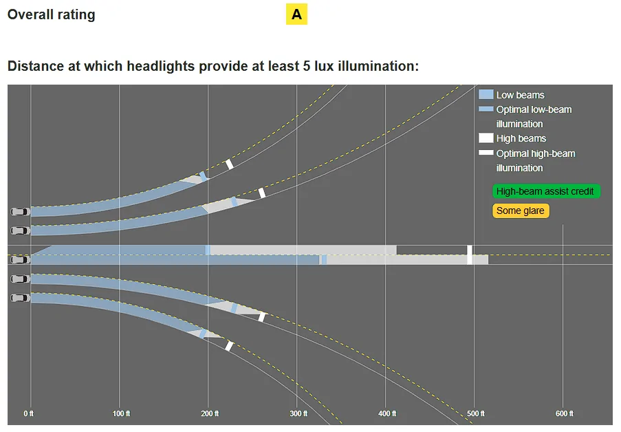

I agree with IIHS, which rates them "Acceptable", but not ideal by today's standards.
They fall short on LH turns and seem to have a bit more glare than is necessary for "sign lighting".
They perform better than most vehicles I've owned, but not as good as a typical OEM LED projector.
