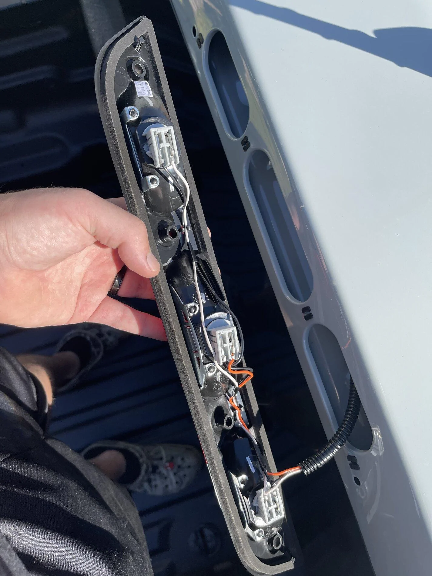

does anyone know how to disconnect the third tail light so a bulb can be replaced? When I unscrewedand took of lensI could not find a direct wire unplug

No wires to disconnect. Once the 3rd brake light housing is detached, simply twist off the bulb that you are replacing. The bulb comes directly out of the housing at that point.

I tried that I was just thrown off by the wires being live and into the bulbs. Maybe I need to take another look. I’m trying to put in leds here as well; any suggestions for led bulb replacements or if I’m doing something wrong here?? I ordered the ones for the tail lights that seems easier

Do less! lol . If you replaced the bulbs in the tail lights, they are going to twist out of the housing the same exact way. Leave all the wiring the way it is. Just grab twist and pull it out.
I put the Kisled brand in mine and worked great.

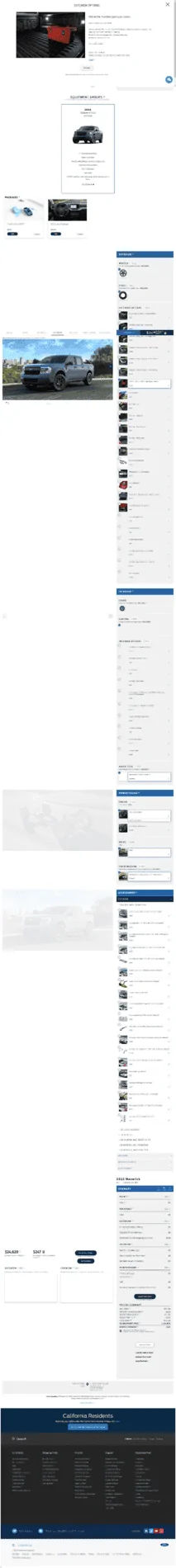

I stopped in to my Dealer to ask about this and they couldn't find an answer but based on a 'picture' said it was 4 and that if it didn't come with 4 they could get another 2 to make 4... not sure if they will remember that when the time comes but did some looking a few minutes ago:
https://accessories.ford.com/produc...citive-touch-led-lamps-bed-light-set-of-4-kit
vs
https://accessories.ford.com/products/ranger-2019-2021-lumen-touchlink-bed-lighting-kit-1
And the image used for the build your maverick is the ranger one...

I actually think I see now. Maybe two

Obiewan54 FTW! You were right easy as pie did the “whites” on tail lights and 3rd light. Hex screws up top and Phillips for the tail, took me about 8 minutes with a drill. Unscrew, keep wires in tack on 3rd, twist out bulbs and replace. Quick release on the tail gate book new lights!!

Glad it worked out!

So yes, the website on the build tool states "Light up your bed with this set of 4 LED Bed lamps". I called FORD and and the part # that is associated with this is labeled as a "4 Piece Kit". They are telling me that its 4 pieces that consist of 2 wire harnesses and 2 LED. I told FORD that if this is the case you need to change the wording on the website to 2 LED lamps. It is VERY misleading. FORD is trying to pass me off to the dealer when it is their fault on how it is listed on their site.
Nowhere does it say 4 piece kit. It clearly says 4 LED Bed Lamps.
I'll be contacting them again. I would like to have all 4 LEDs as listed, but if not, some type of credit or points.
Is it 2 LEDs per lighted lens assembly ? If so then its correct in saying 4 LEDs.
