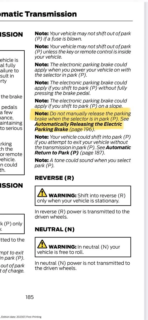

I always put the parking brake on before I shift to park, that way it's the parking brake holding the vehicle still instead of the transmission.
Just don’t manually release the parking brake.
Ford Maverick Automatic Parking Brake Applied IMG_5869

I think it seems like when I open the door like that the brake goes on but vehicle is still in D with my foot on the brake. Only after I turn off the ignition does it then move into p. So I think it’s all a legit way to do things. Just feels weird opening the door to have ebrake turn on. Ok I’m just. Gonna go to a dealer and ask.

The auto engage was meant for safety- so someone doesn't get run over if they fall out of the truck. Honestly if you're on flat ground I wouldn't worry about the brake, the parking pawl will keep the vehicle from moving.
