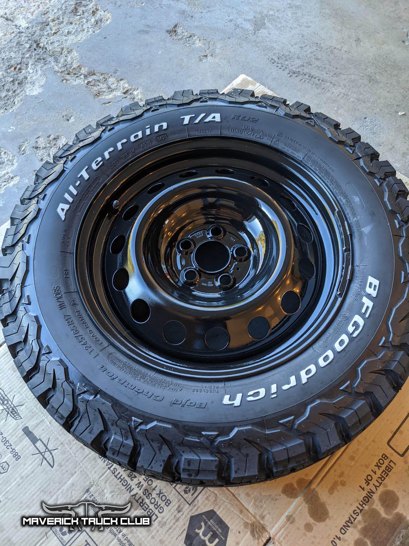

Directions on painting the XL steel wheels:
You want to pressure wash the rims first to get any debris off then sand it with 600-800 grit sandpaper and the factory silver color comes off very easy.
Then pressure wash again and wipe clean.
Let it dry then place index cards in-between the rim and tire to protect the tires from over spray.
Then just use a rim specific spray paint and put 3-4 coats of paint on.
2022 Ford Maverick painted black steelies steel wheels on BFGoodrich KO2 245:65:17.jpg
2022 Ford Maverick painted black steelies steel wheels on BFGoodrich KO2 245:65:17 3.jpg
2022 Ford Maverick painted black steelies steel wheels on BFGoodrich KO2 245:65:17 2.jpg
2022 Ford Maverick painted black steelies steel wheels on BFGoodrich KO2 245:65:17 1.jpg
how has the wear and tear been on this? any issues? its been 2 months now.

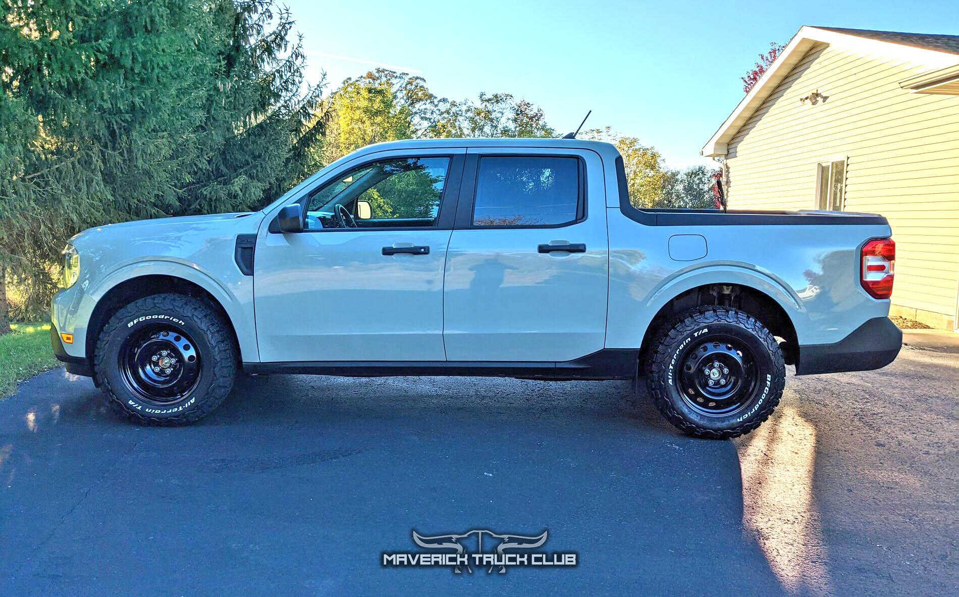

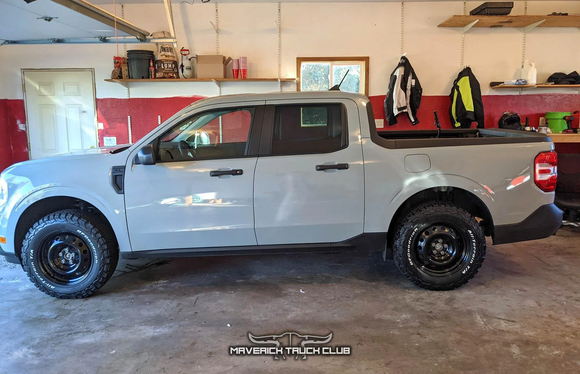

is that stock height, or did you lift it first? trying to find out how big i can go without cutting wheel wells.
ldkuffel
Aug 10, 2021
170
Madison
Ford
This is stock height any bigger and the wheels will rub a little.

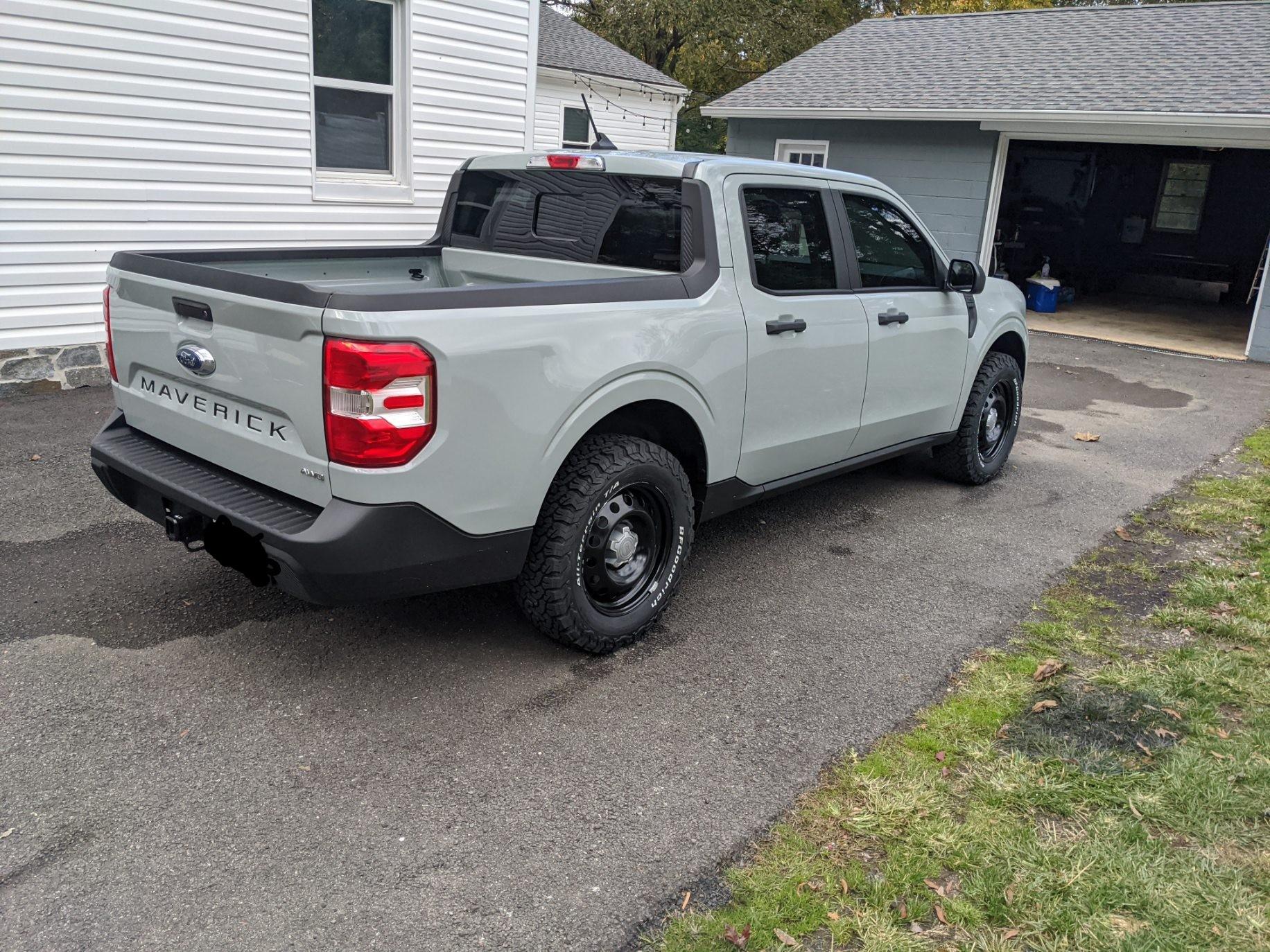

What paint did you use? I'm so doing this.

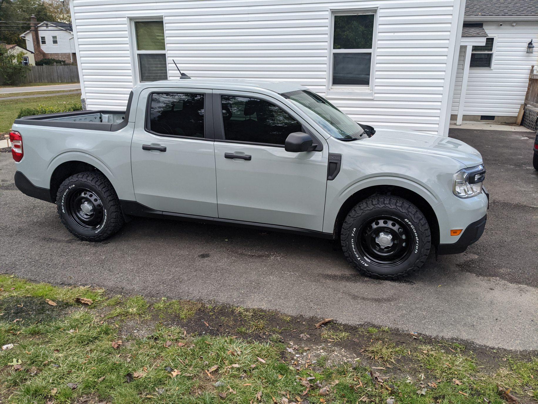

Been driving in salt and snow and still looks great.
Looks fantastic! I see you kept the chrome lugs. Did you consider getting black ones? I'm not sure it would improve the look...

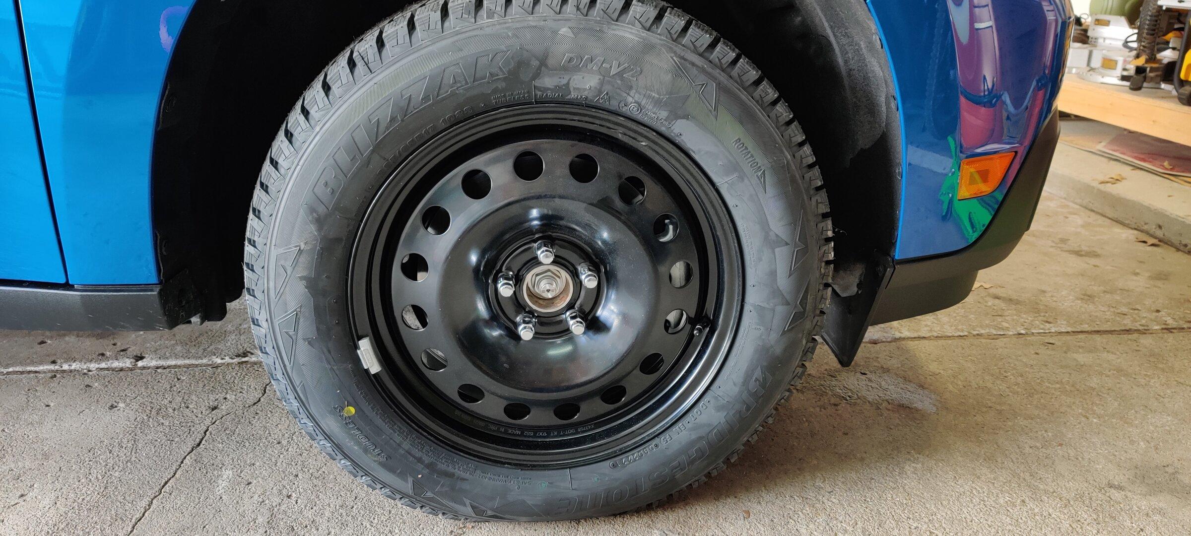

god i love steelies, but not without a center cap. i put some on my wifes escape, for snow tires and didnt realize the manufacturer doesnt have center caps available. drives me nuts, and i cant find any to fit...
love the paint though!!
