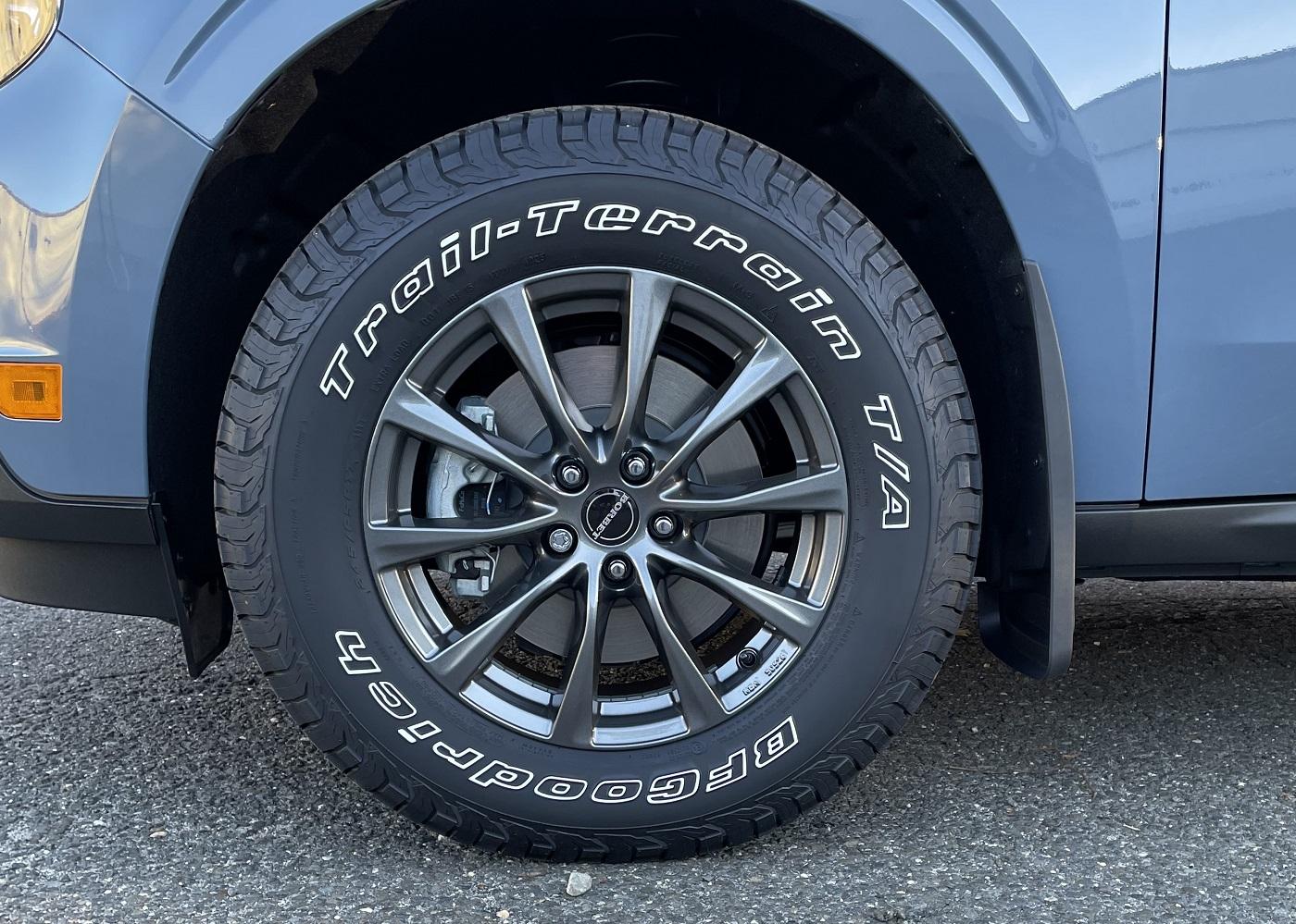

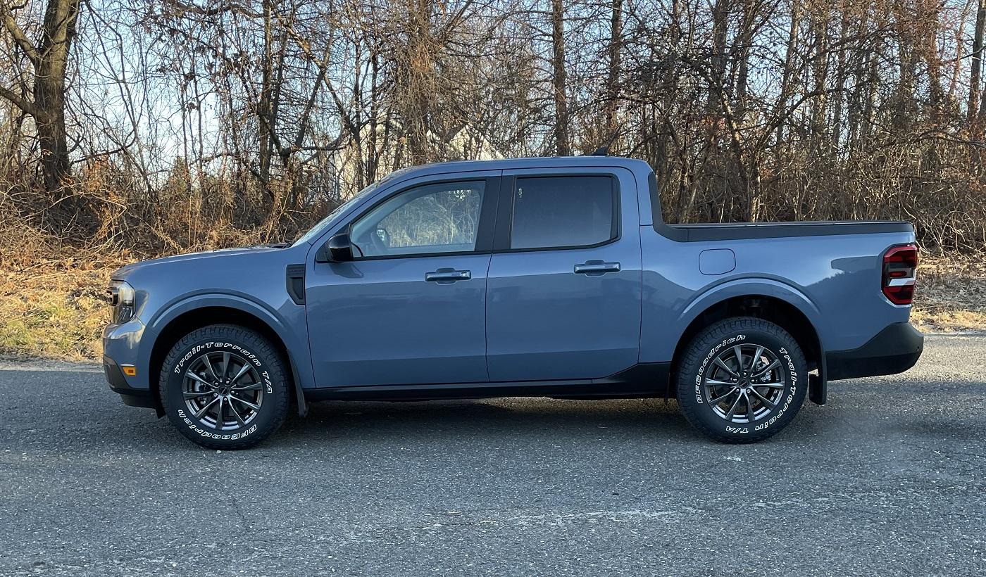

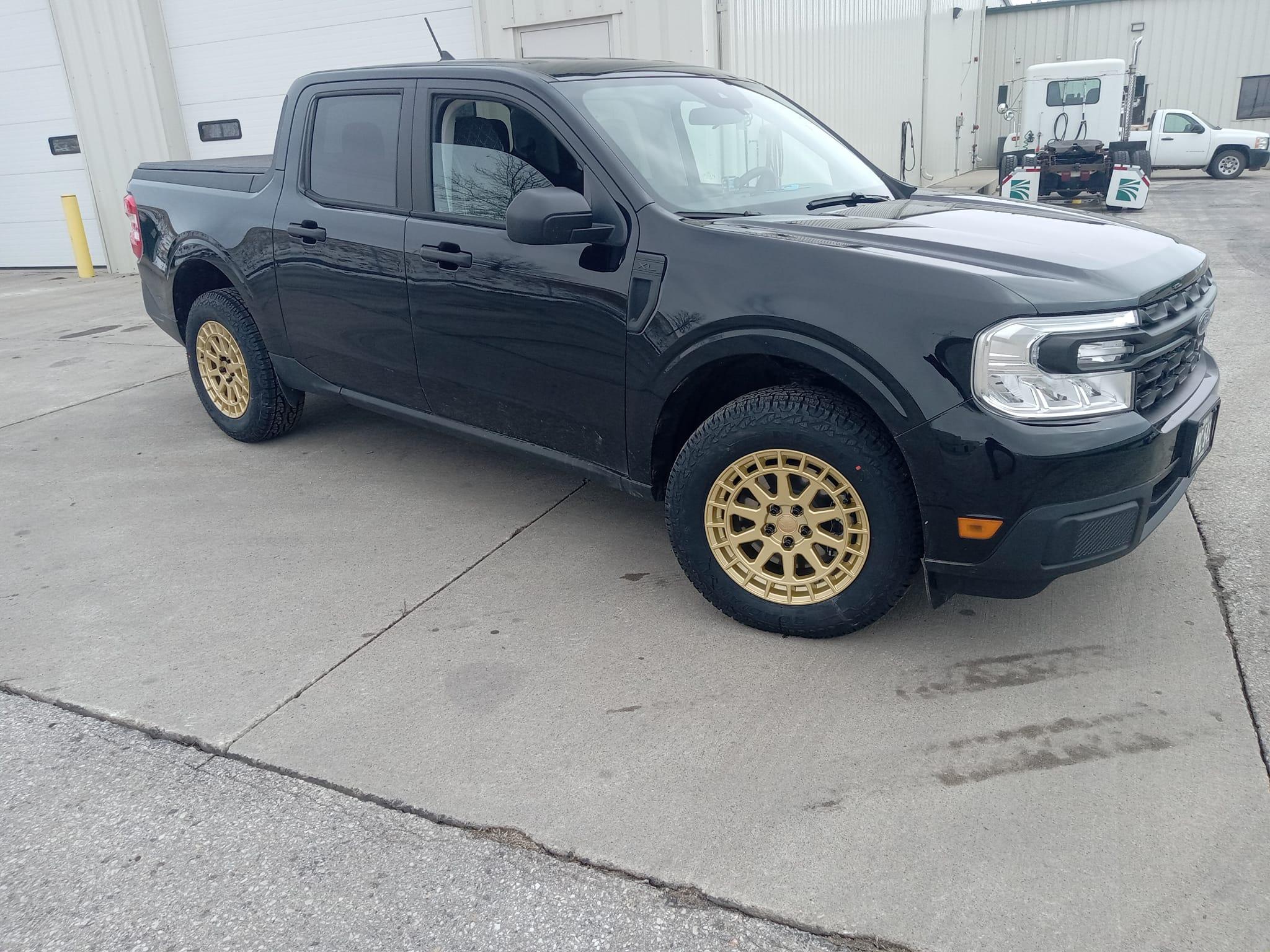

245/65r17 on black rhinos. 0 lift. put the speedo to only being 1 mph off. set to 61 actually going 60. I dont care enough to get into forscan to fix it. stock tire size read over 3-4mph off. set to 60 actually doing 56-57. verified with 2 different gps units.
had the same wheels and tires on my 22 xl. was the same off.
black is 2022 xl, blue is 2024 xlt.
