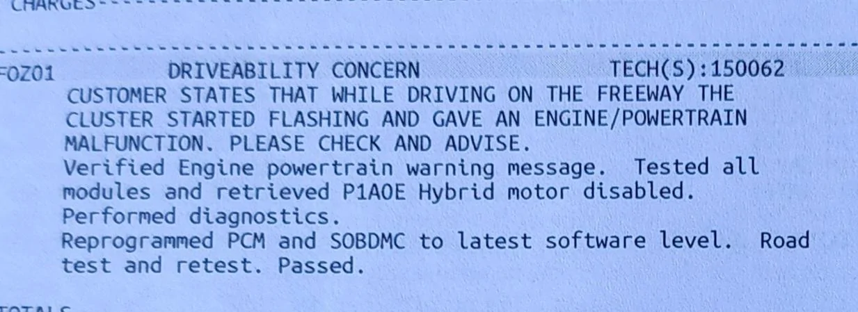

Anybody knows about this code? Or has it showed up on their Hybrid!
Took my Mav Hybrid due to losing power on the freeway and that code showed up.
Dealer fixed it by updating the software of the PCM and SOBDMC.

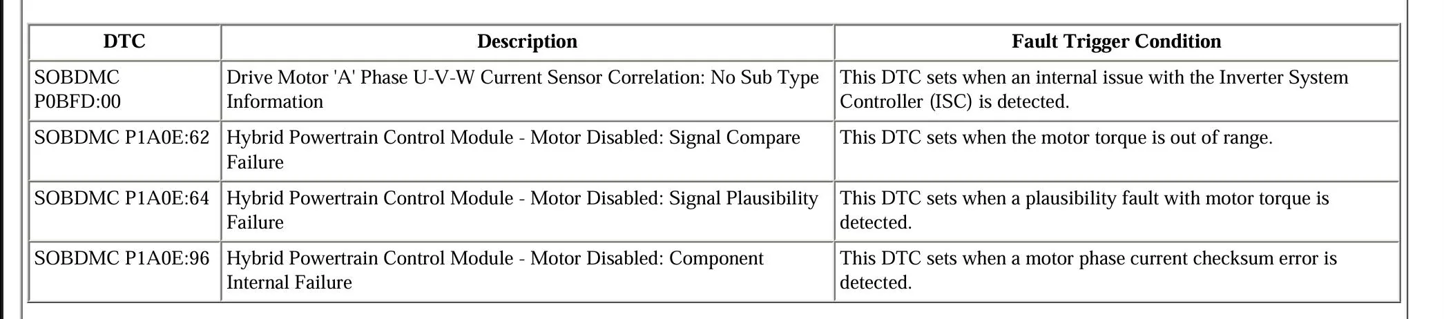

Internet says:
Hybrid Powertrain Control Module Drive Motor Disabled
When this happened, my truck sounded like a Diesel truck.

Looks like there are three variants of that code. Probably sensor related. Probably a one time glitch.
