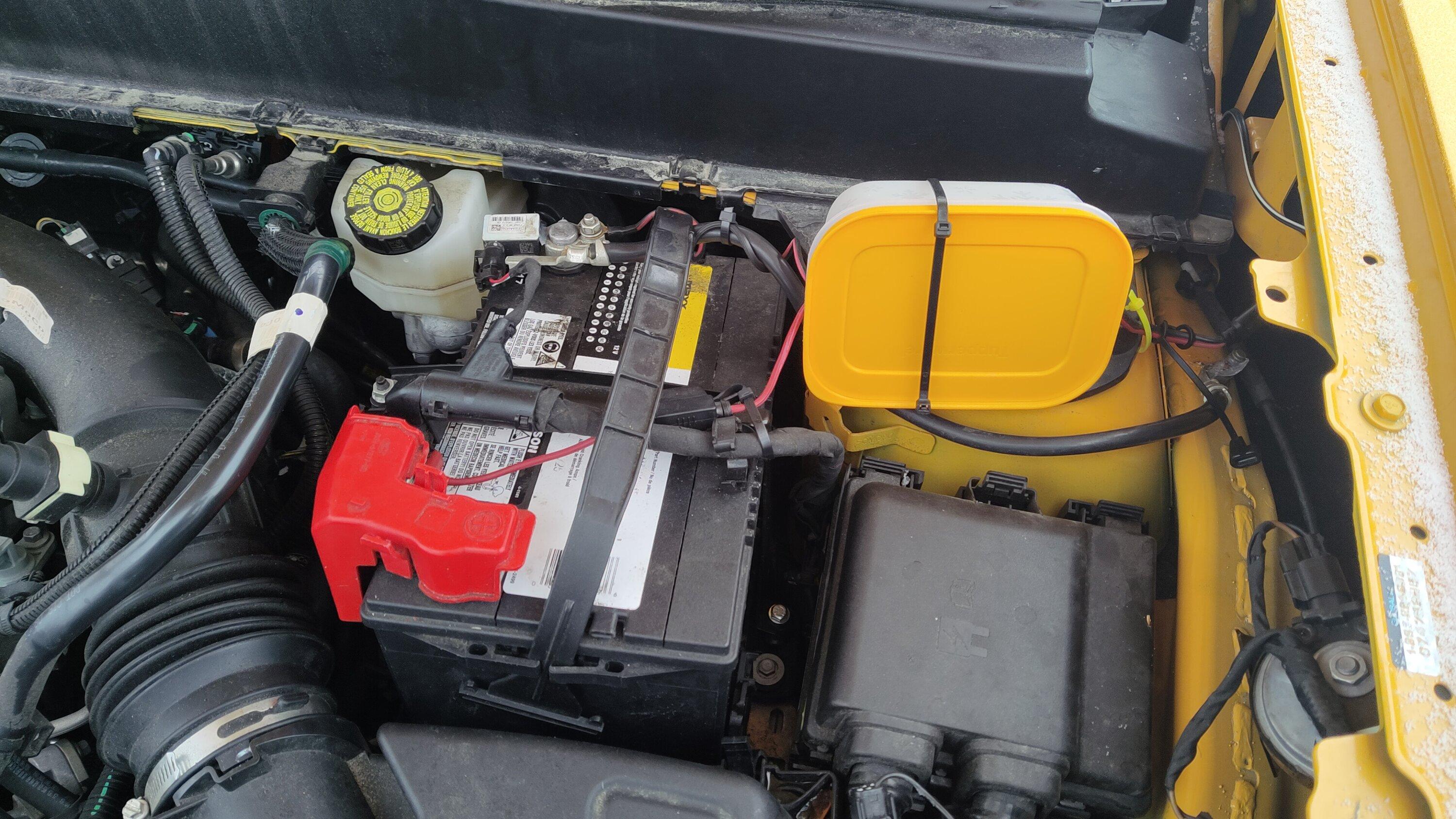

I had the same issue with deep sleep mode.
Did the following.

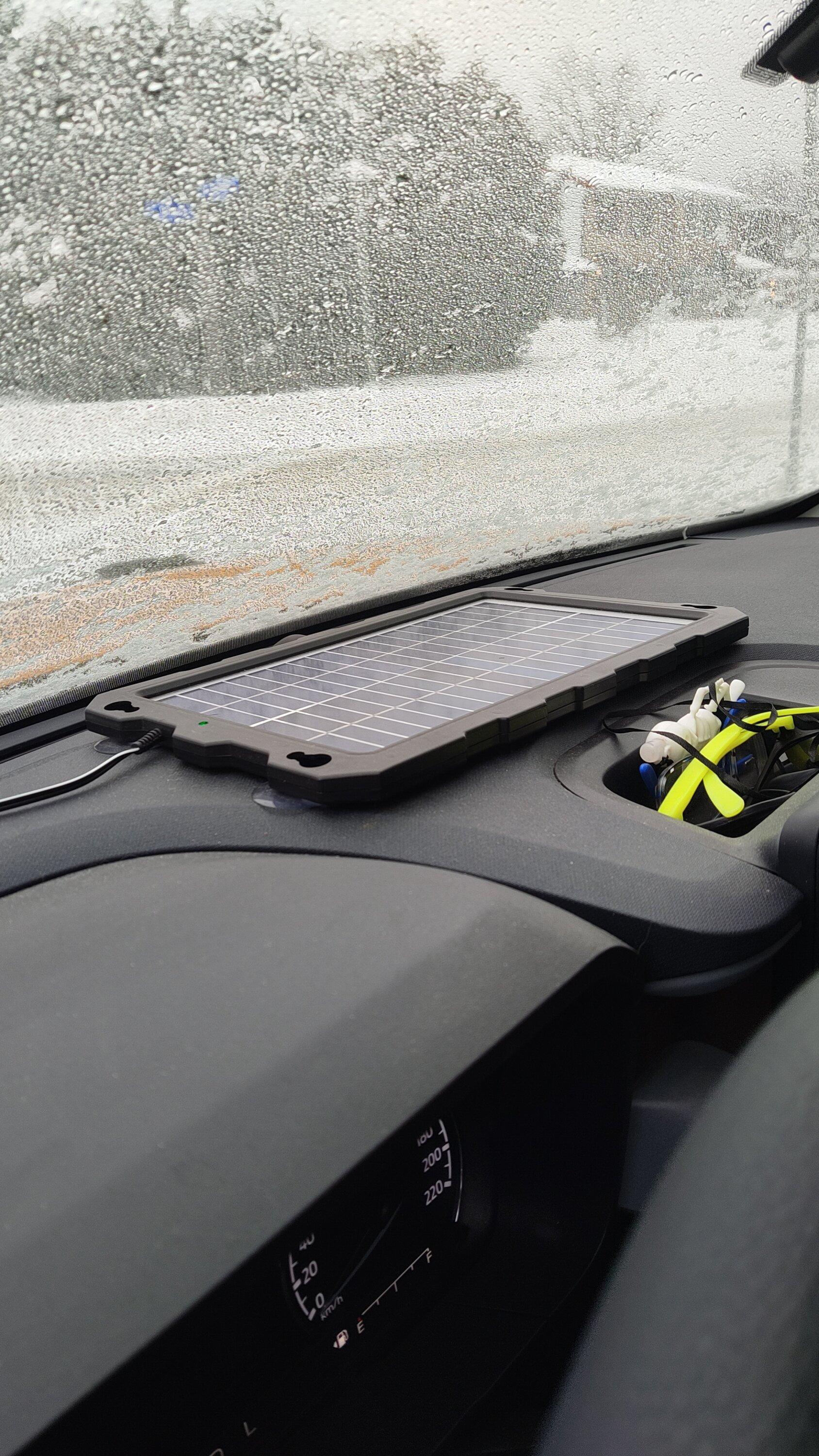

1. Solar charger
https://a.co/d/2eXLlT5

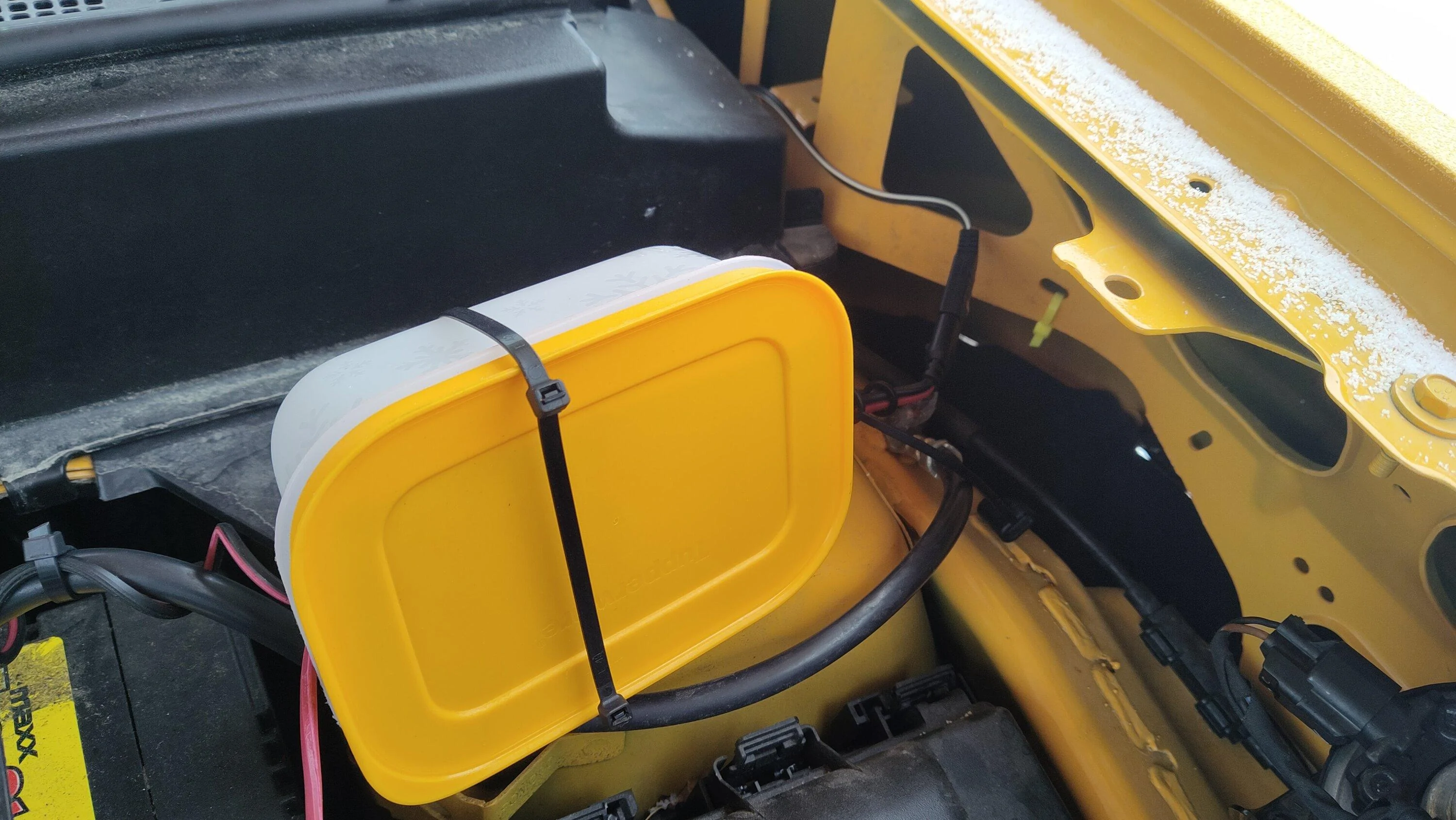

Solar charger regulator
Note: I put the solar regulator in the yellow sealed container (see photo).
https://a.co/d/hgJc163
Accessories connector:
https://a.co/d/iD3EmV1
2. Bigger battery will also help. I put a 24F battery. To get the stock battery out you will have to take apart the air filter box to slide out the battery as the stock battery has edges that hook into the battery tray. The 24f battery is taller so you will need a m8 bolt extension. Or you can get a longer bolt and put some over size nuts on it.

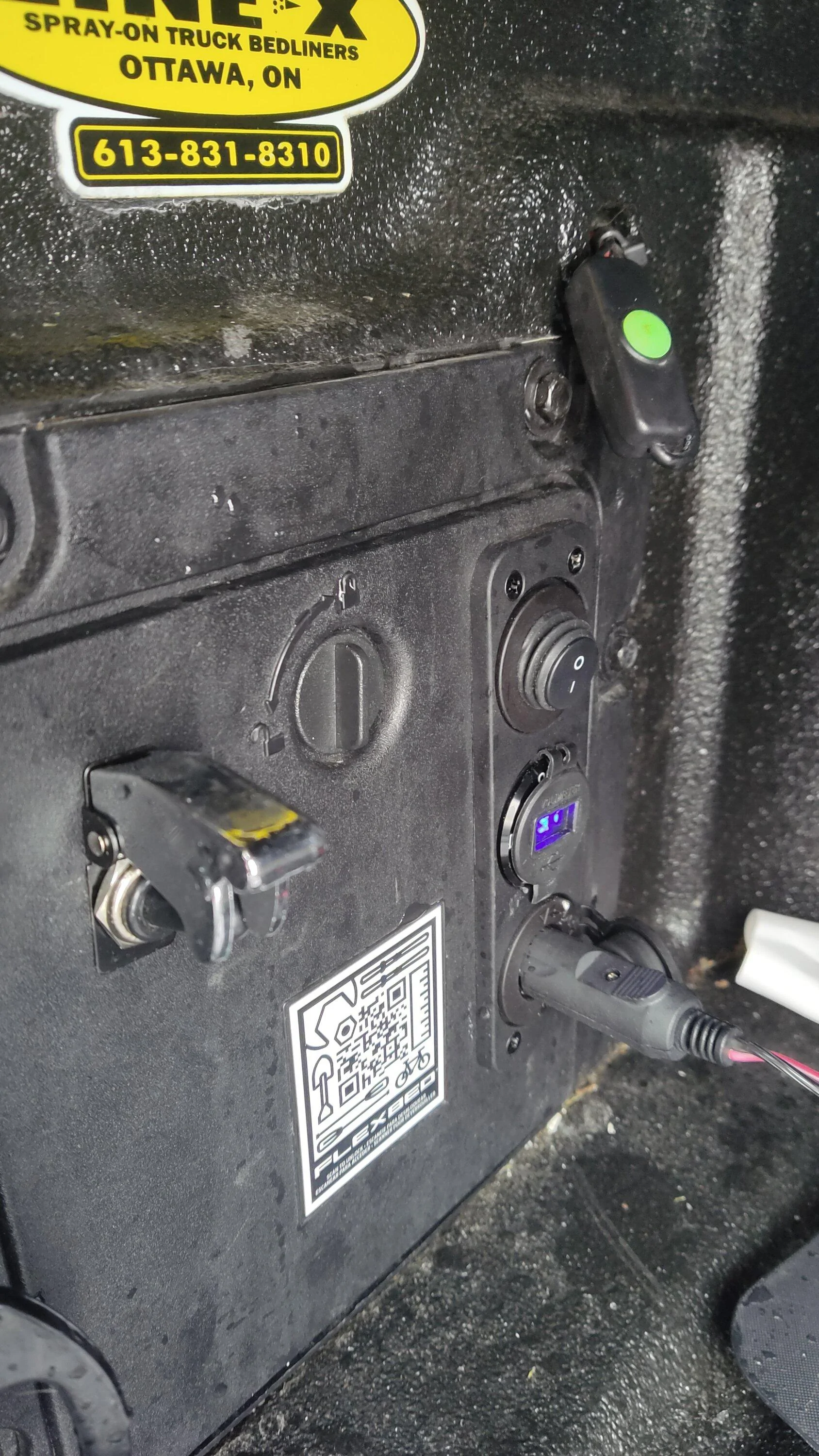

3. I put a charging station in the bed of my truck with a 3 way switch that goes truck power/off,/,external battery. The external battery is in the bed cubby and does have to be charged separately. I am thinking of putting a battery isolator so the truck can charge the external battery itself.
Battery isolator: https://a.co/d/3lBDtdG
Battery:
https://a.co/d/8X5Uc3Q
