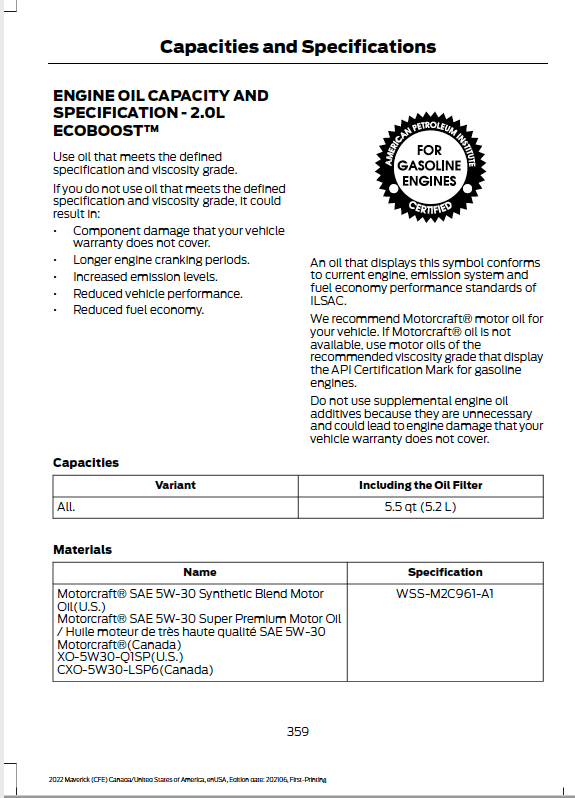

From the "released" Maverick Owner's Manual:
Ford Maverick Oil change schedule / interval? Synthetic oil? Screen Shot 2021-08-18 at 10.02.32 AM

FYI, I noticed a lot of maintenance plans only provide synthetic blend so make sure if you want full synthetic then insist on it. I hate that the hybrid is not 5 quarts! Don't like those odd quart numbers, Ford should have made 6 quarts instead. Who using a partial quart???
