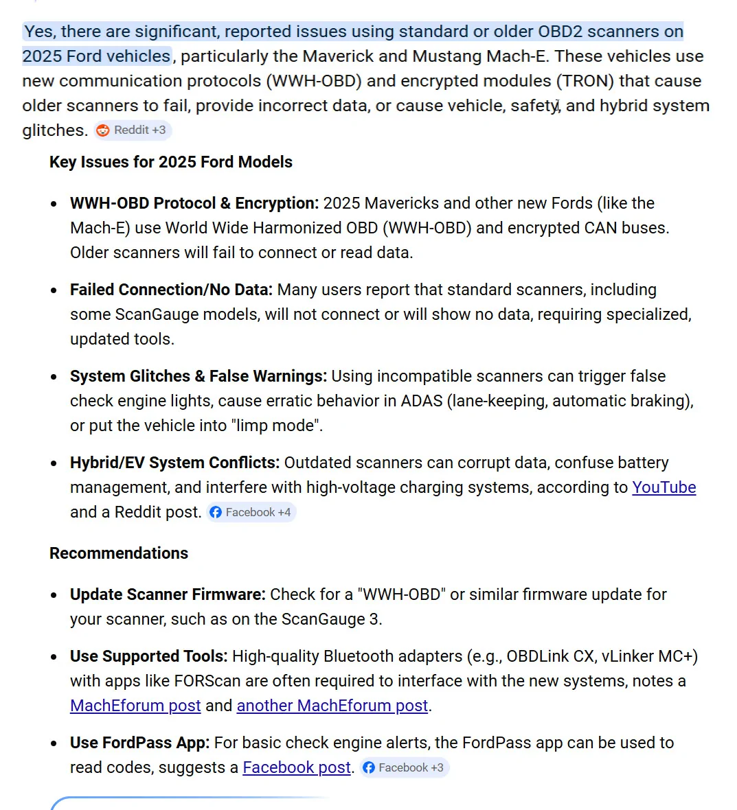

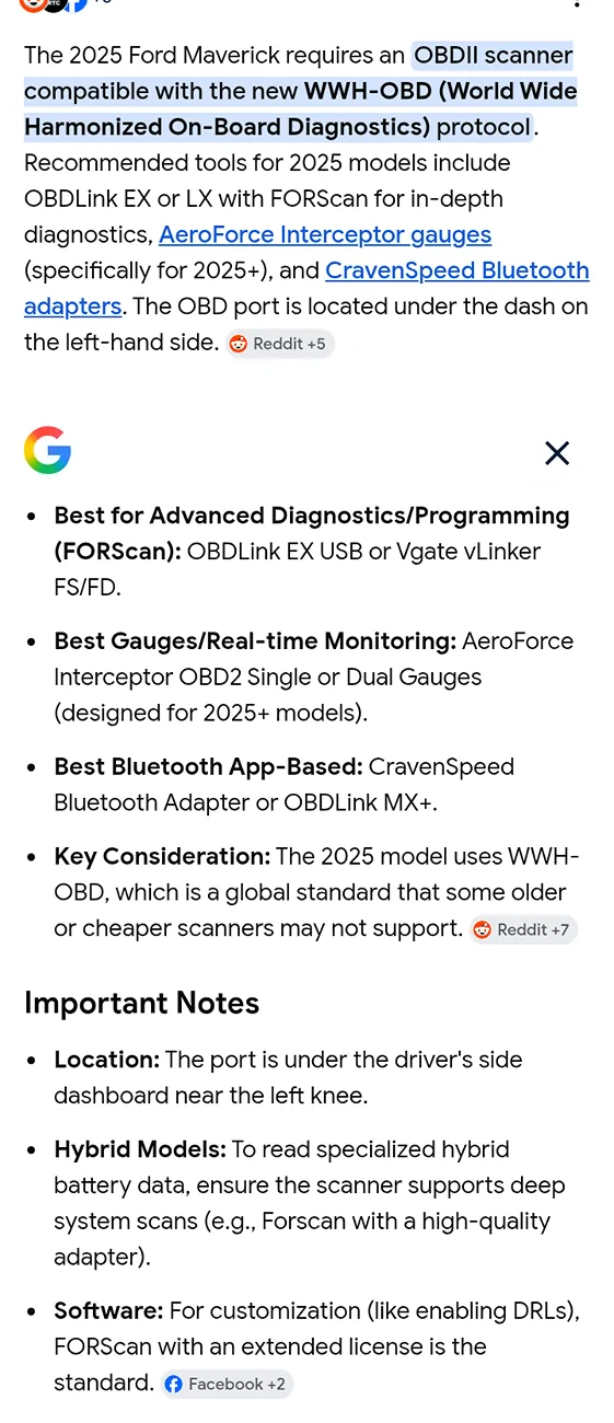

I can verify that the OBD scanners I have that work on my other vehicles do not work on my 2025 Maverick. Has anyone found one that does work?
Perhaps you need to update? Did you read the link in post #11 on this thread. The 2025 OBD has changed to World Wide.......etc

Hey James,
Thank you sooooo much for pointing that out, and others for posting the information, A case of not being able to see the forest for the trees!!! That is likely the problem. Now I search for a WWH-OBD Bluetooth Scanner

From ISO…
ISO 27145-4:2016 defines the requirements to successfully establish, maintain and terminate communication with a vehicle that implements the requirements of the WWH-OBD GTR (Global technical regulation). This requires plug and play communication capabilities for the vehicle, as well as for any test equipment that intends to establish communication with a vehicle. This part of ISO 27145 details all the OSI layer requirements to achieve this goal.
ISO 27145-4:2016 is intended to become the single communication standard for access to information relating to vehicle on-board diagnostics (VOBD). To allow for a smooth migration from the existing communication standards to this future world-wide standardized communication standard, the communication concept as specified in this part of ISO 27145 is based on two different data links:
- diagnostic communication over Controller Area Network (DoCAN), ISO 15765-4;
- diagnostic communication over Internet Protocol (DolP), ISO 13400 (all parts).

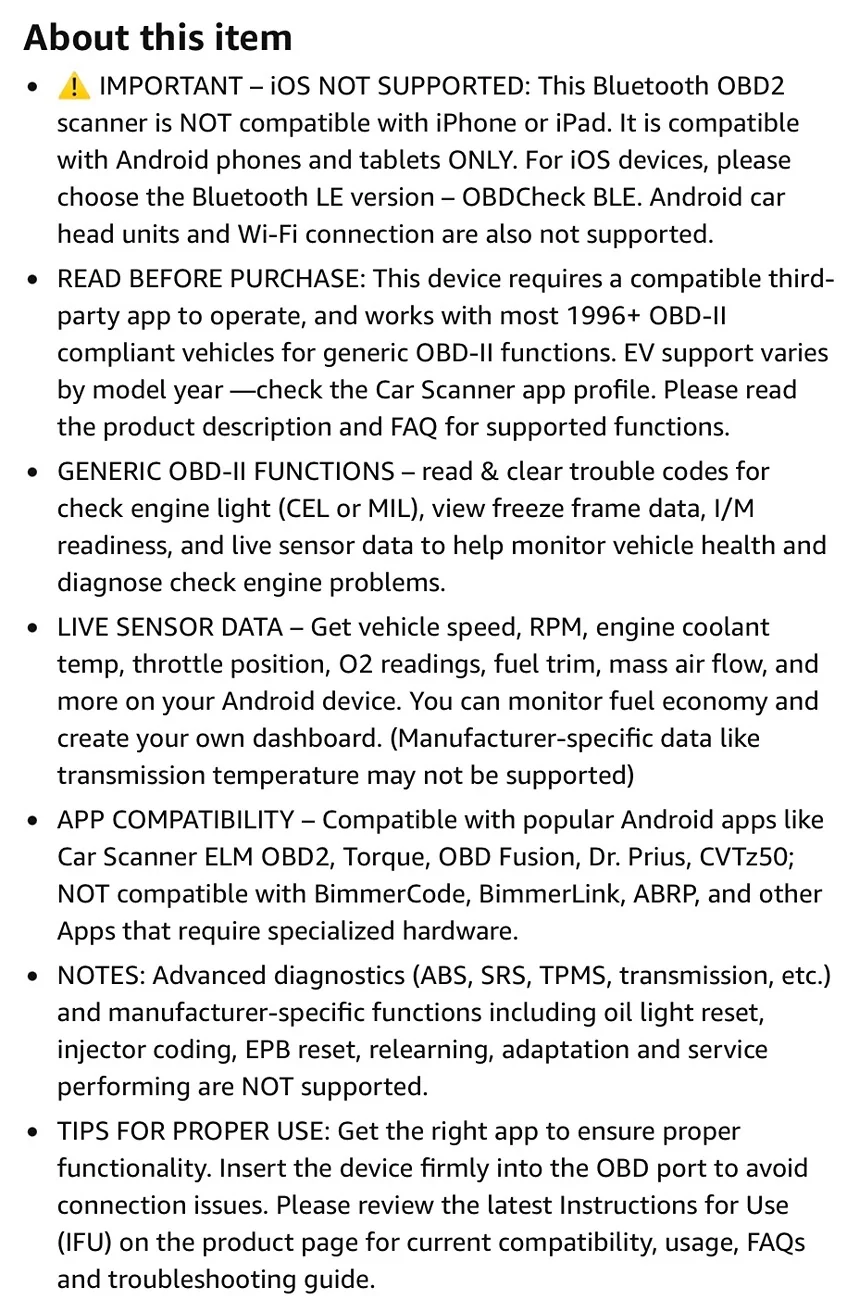

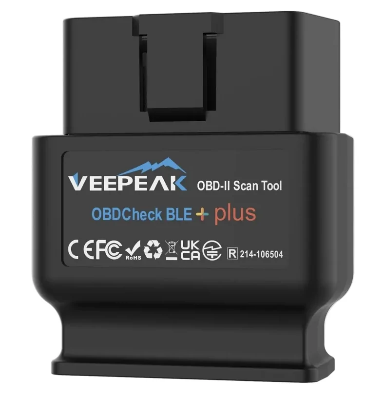

I am going to try this one when it arrives Saturday. Updates coming…
Ford Maverick OBII port unresponsive IMG_8106
Compatible OBD II Protocols
SAE J1850 PWM,
SAE J1850 VPW,
ISO 9141-2,
ISO 15765-4 CAN,
ISO 14230-4 KWP 2000,
NOT supported: MS-CAN, SW-CAN.

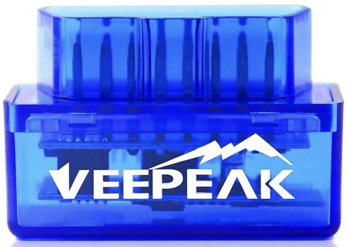

IT NO WORK!!!!
Ford Maverick OBII port unresponsive IMG_8111
Maverick Country Club
Larry
Nov 4, 2025
334
585
2025 Maverick Lariat Ruby Red Metallic Black Appearance Package
I will be contacting Veepeak customer support on Monday, hopefully they can help.

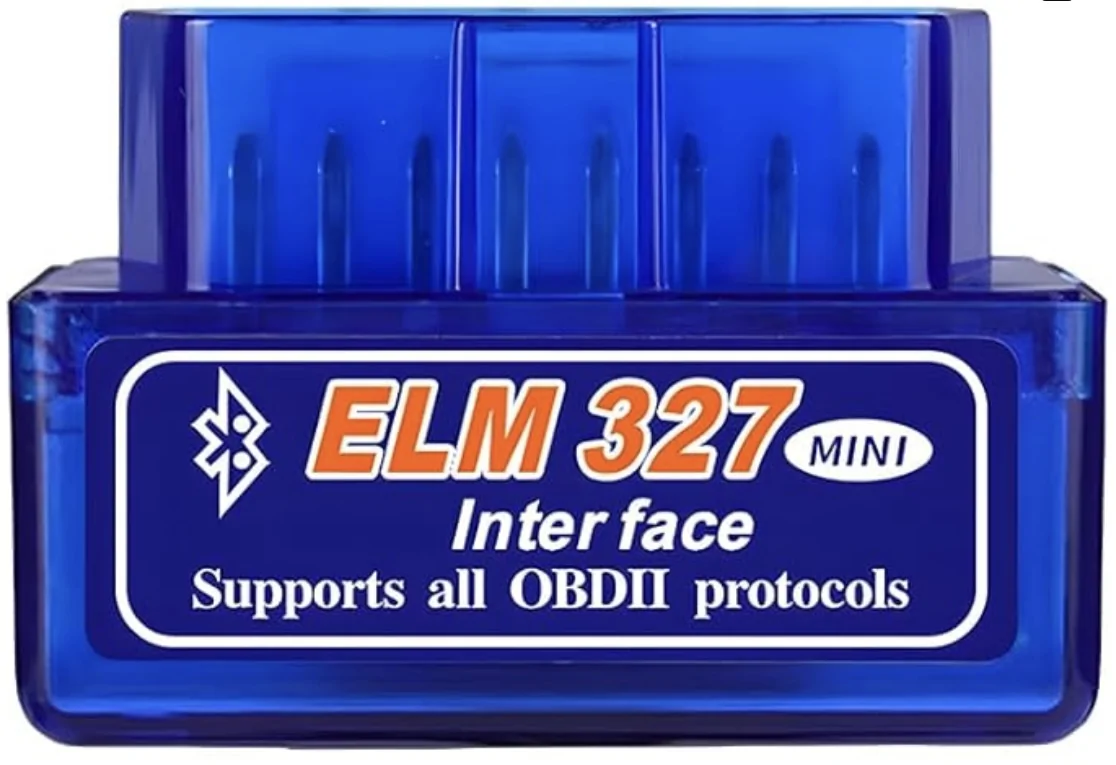

I‘m also having trouble connecting to the OBDII port successfully.
When I plug in either of my Bluetooth OBDII scanners in an effort to Bluetooth the RPM to my Android phone and use with the DragFX or RevHeadz engine sound apps to send the real-time RPM motor sounds to the sound system through a “C-type" cable.
Facts:
- The “C-type" cable connection from the Android phone to the sound system functions as I am able to use the DragFX or RevHeadz engine sound apps successfully without receiving the real-time RPM from the OBDII port.
- When I connect the diagnostic scanner that I successfully use in my older vehicles, it can’t connect to the Maverick. I checked the scanner manufacturer’s site and discovered I need to download an update but haven‘t yet.
- The OBDII scanner power light comes on when plugged into the OBDII port and connects to the Android phone as the RevHeadz app begins to connect but ends in a message of failure to connect. The DragFX shows no sign of connecting.

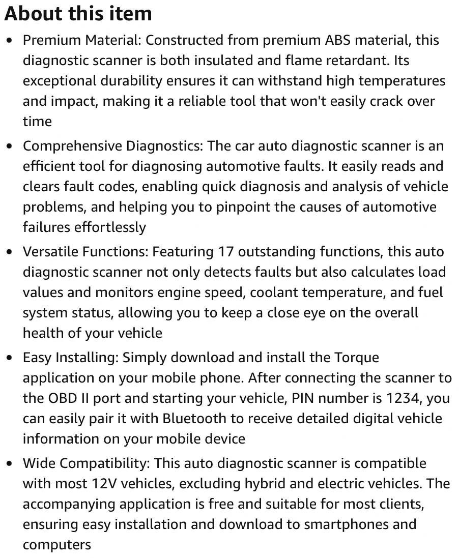

I tried a few Obd scanners without success. Bought this one off of Amazon and it connects. It is supposed to have two way communication which I really haven't tested. It does connect and seems to do what it says. https://www.amazon.com/dp/B0DP8PH63Q?ref=ppx_yo2ov_dt_b_fed_asin_title
