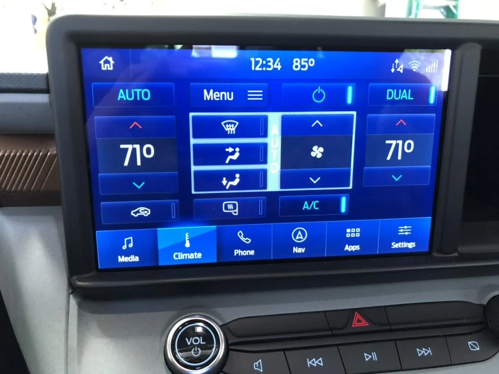

Mine was built on 4/19 and has the temp display dials. I recently added Nav to my Maverick and I also gained the climate tab, I can change temp from either.
My wifes '22 Bronco Sport doesn't have them and I know the '22 Bronco's also dropped them as well. Not really a big thing, you quickly adapt though my preference is on the dial.

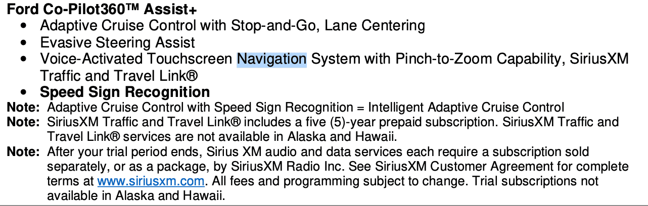

By adding Co-Pilot360 Assist+ to their 2022 Bronco Sport.
As opposed to the more basic Co-Pilot360 package on Maverick, and lack of navigation.

The thread that I used was "How To: Sync 3/4 swap for non Sync 3 XL/XLT", do a search on that. I didn't want to do a how to since it would mostly be a rehash of what they already posted. Basically you are just swapping out the APIM module, the important thing is you will need a Ford Sync 3 Gen 4. It is important to only get this version with NAV. Here is a link on eBay:
https://www.ebay.com/itm/255212358040?hash=item3b6bd78998:g:cRYAAOSwrWthhHDm
Unless you have a Forscan that you can program the module make sure you buy it from a vendor who will program your VIN, module has to have your VIN. Other than that it's just a matter of swapping the APIM. You can access it by pulling off the temp controls, you will see that in the "How To: Sync 3/4 swap for non Sync 3 XL/XLT" thread. There isn't much room to work for disconnecting the cables, I found that disconnecting large connector first allowed me to move the module around to get to the other cables.
