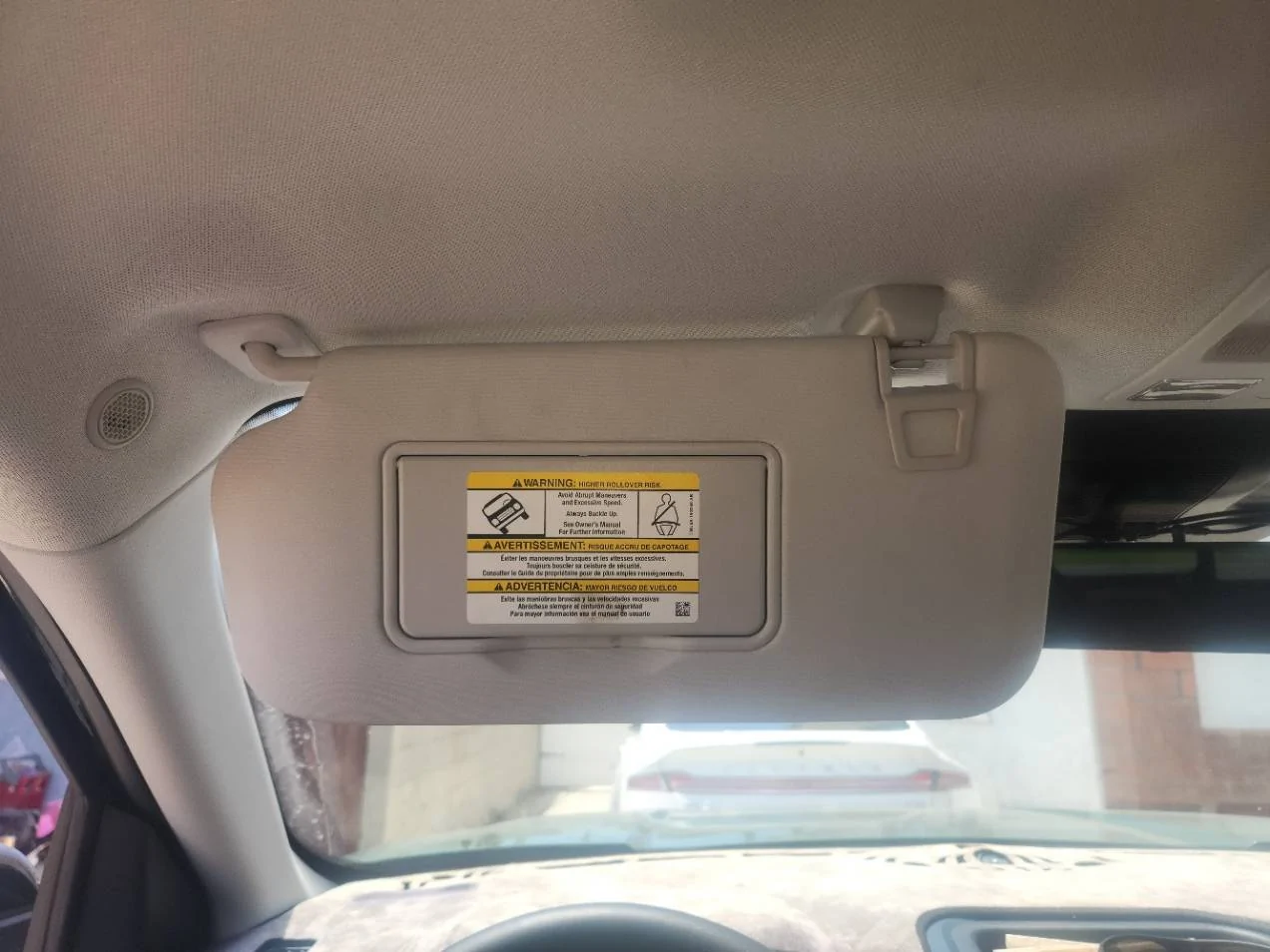

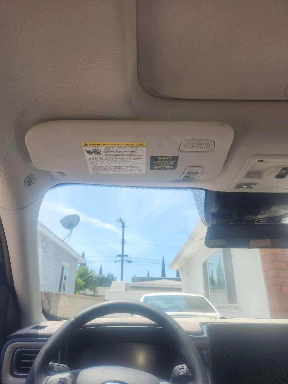

The Bronco sun visor with homelink fits the 2025 Maverick. Pretty much a plug and play only a little tight on the right holder mount
I've been running a Homelink visor from a '21 Escape for a couple of years now. It's actually a better fit than the Bronco Sport, the mounting bracket is slightly different on the BS. I've been happy with it. I did install a auto dimming mirror, had a Ford auto dimming mirror left over from an old car and install it, ran a line and tapped off the connection for the visor. The biggest reason I wanted the visor was my Bronco has the Homelink visor along with several other older Fords I had and I just naturally reach for the visor.
