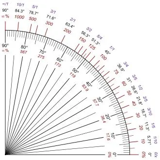

A 22% grade = a 22 foot drop in elevation per 100 feet of travel.
