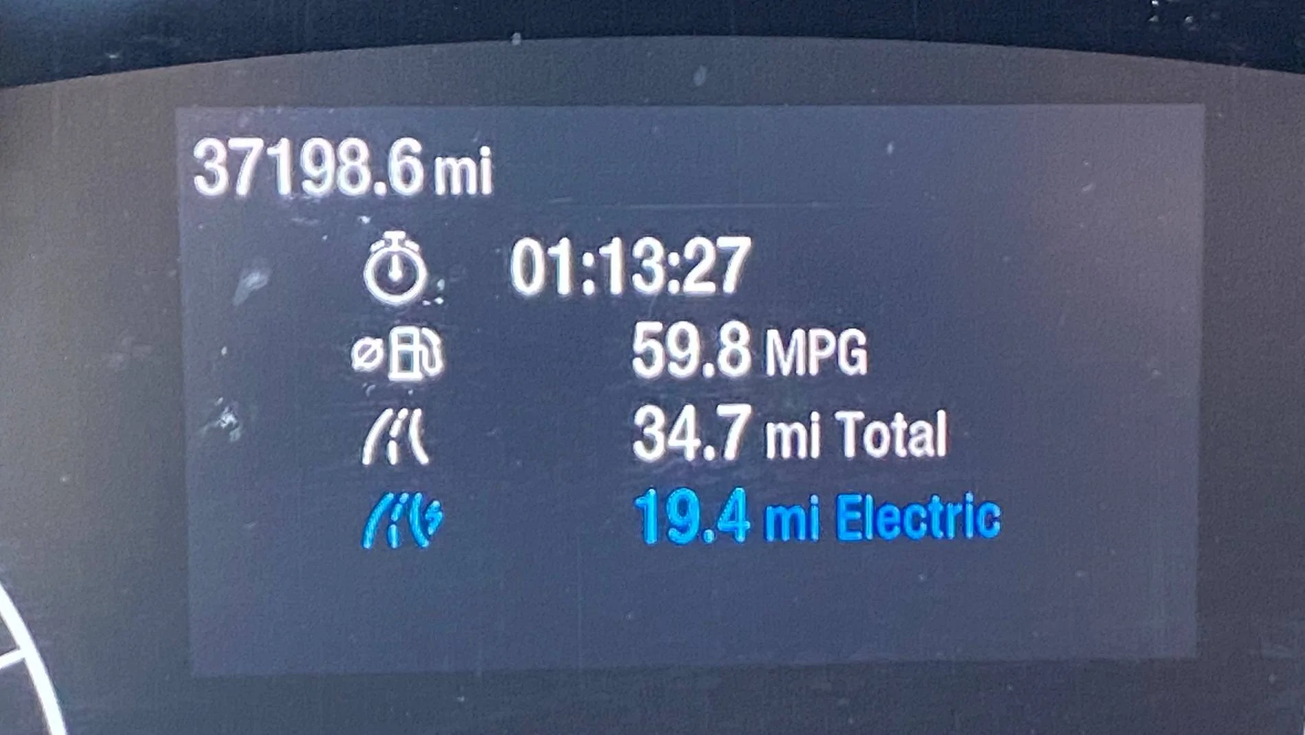

5 mile trip. Impressive. Do it for a 300 mile trip and I will be impressed. I got 35 mpg on a 99 mile trip but I know the EB does not get that all the time. Small sampling is not accurate.
When not towing, I get at least 700 miles per tank. A lot of the time 750 miles. Two times, 800 miles. 840 was my best.
What does that work out to?
Ford Maverick Cold Starts and Multiple Hybrid Engine starts IMG_3445
I do this five days a week.
That's 56% fewer hours on the ICE engine versus a non-hybrid. Probably inconsequential in the long run 🤔
