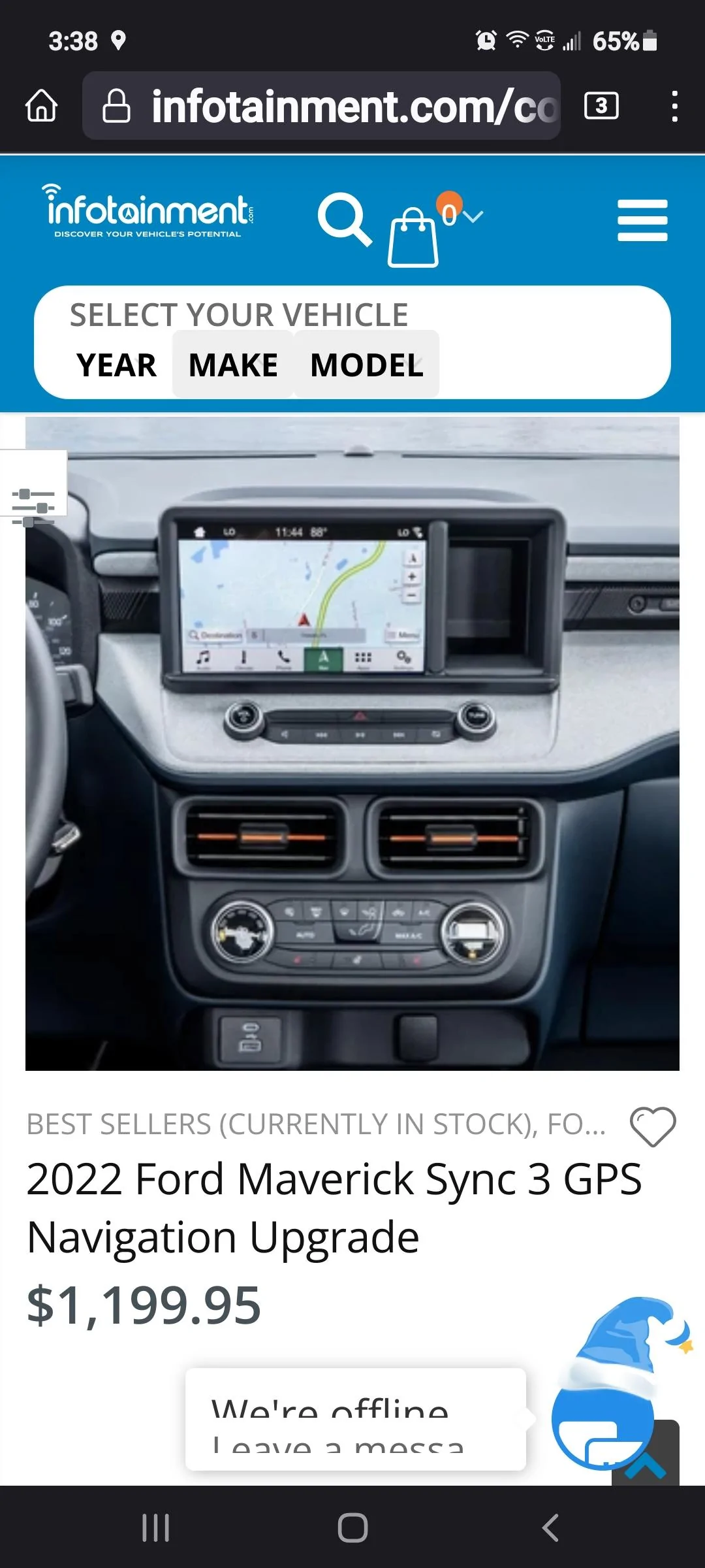

We need to open up a Lariatt with Sync 3. These parts must be interchangeable as the head unit in the Lariatt is the same. We may need some more cables to connect everything.
They may have photoshopped the Navigation onto an XLT dash but if they didnt this is proof it can be done.

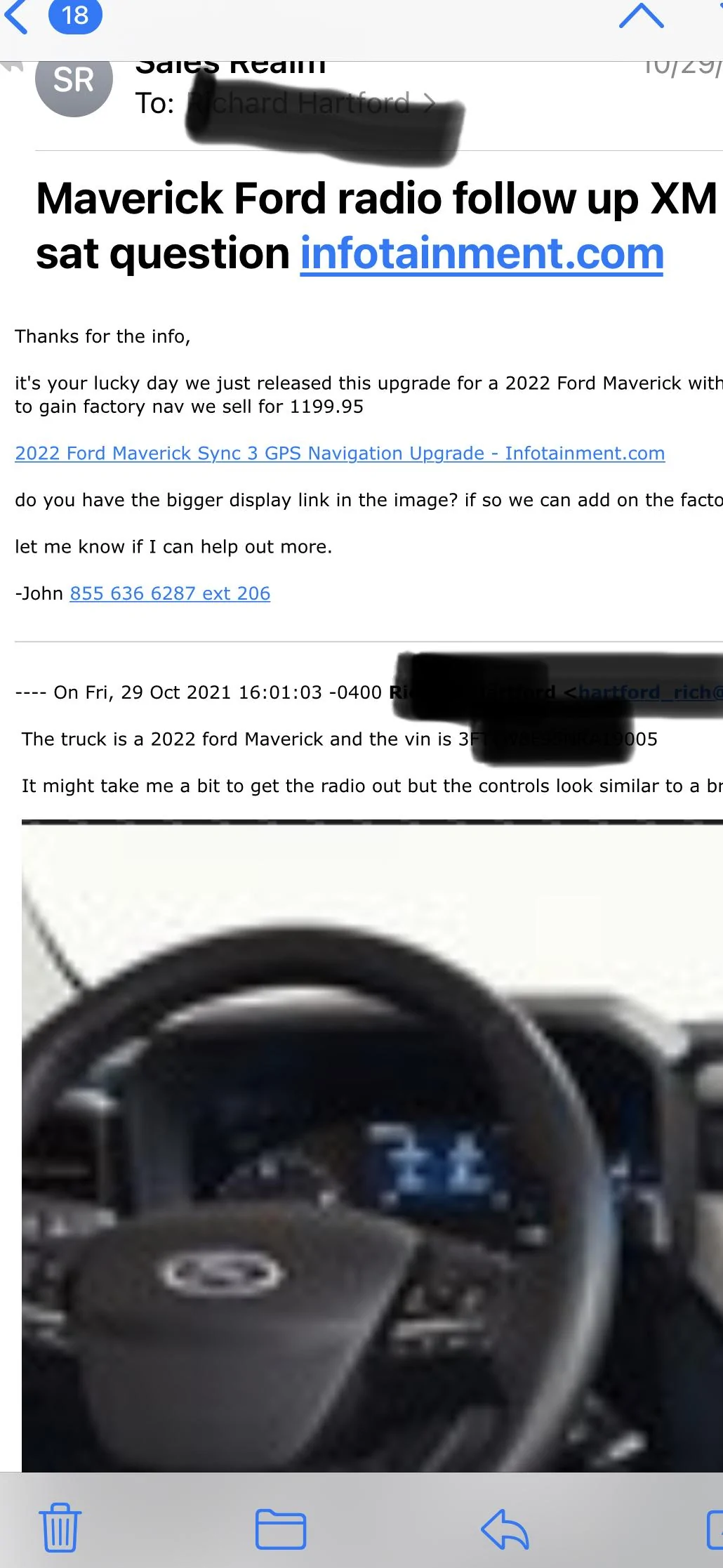

so I emailed infotainment in October asking them if they had any plans on Maverick upgrades. At the time there was nothing on the site.When they replied they said “ good news we just launched our Maverick upgrade” with a link to that page so it’s 100% photoshopped.
