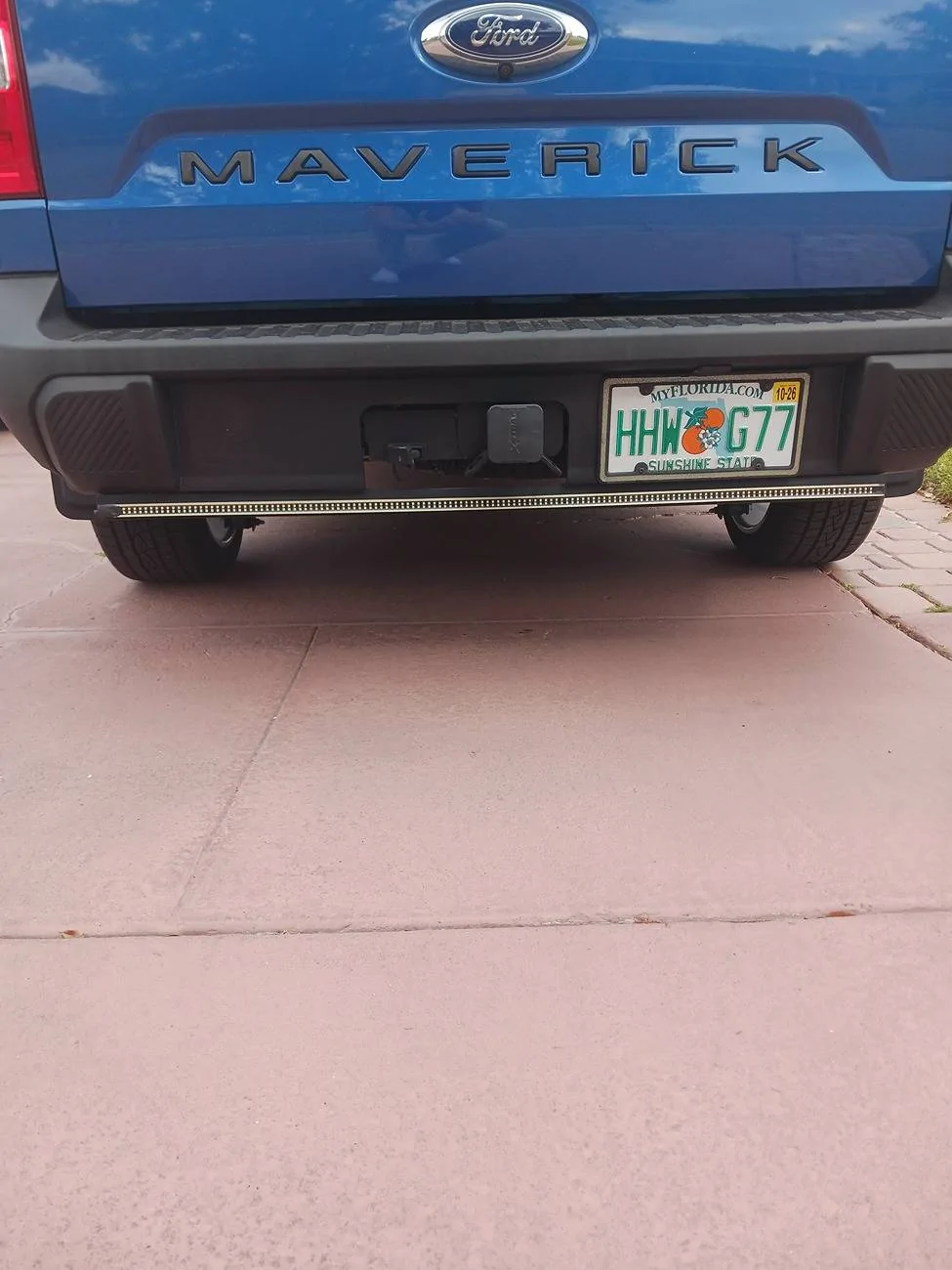

i am wanting to add a led bar to add more break lights so some dumbass doesn't rearend me and they total my truck.
looking on ebay and i see a bunch that are 60 inch and i measures my tailgate and nor even close. Not sure how they advertise it for a maverick
what size has people used ? types ? brands? and is there away to NOT attach to the trailer as this turns off bliss
thanks so much for your help

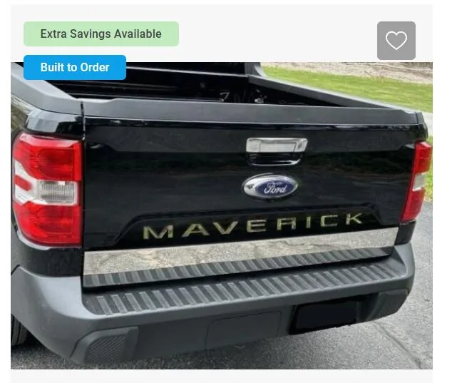

Where did you get the chrome accent for the tailgate? Love this. CARiD ?
yes I just did a google search for Chrome lettering Ford Maverick,
My son bought me a set, he said they were chrome but they are white.
