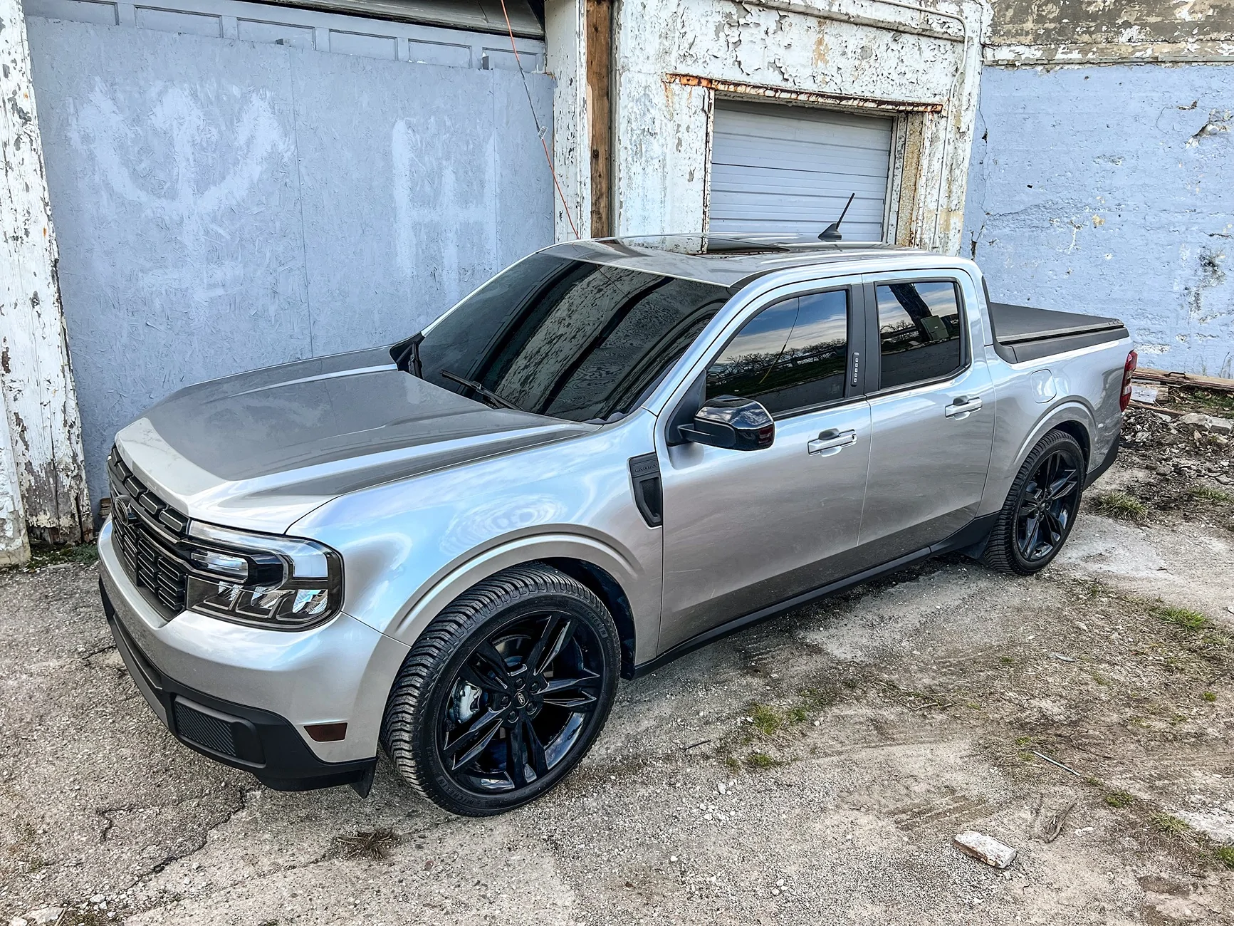

ART 129 is a real nice design
Ford Maverick New wheel selection confirmation 1775397896423-6s
For the lug nuts, you need to check with the wheel manufacturer. OEM lug nuts are "cone", aftermarket wheels can't be cone or acorn, make sure you get the right ones to match
You could also look for 2025+ Lariat OEM rims

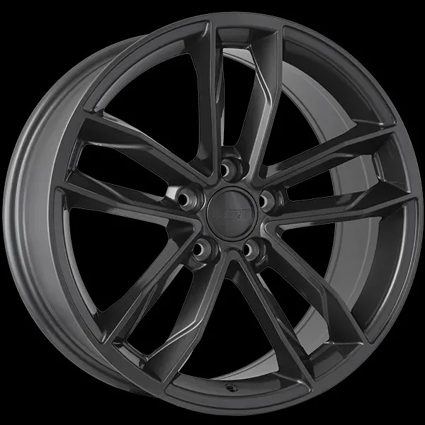

Looks like the 129 wheel has the wrong bolt pattern and the FC04 and R241 are 18" wheels not 19" needed for the tires you bought. Watching this thread as I'm looking for matte bronze wheels that fit my stock 225/55R19 tires that only have 4.5k miles.
