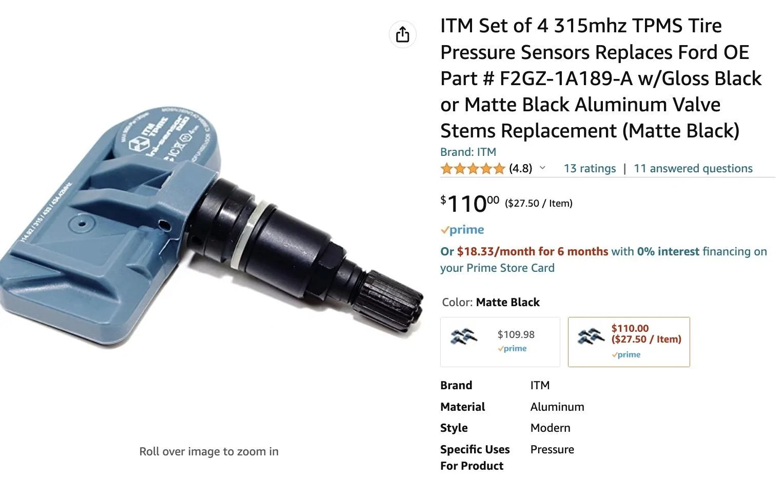

So I am trying to find the correct TPMS sensors for my new wheel/tire setup. The wheels are matte black so I wanted matching satin black valve stems. Will these below work? Also, I already own the TPMS programming tool so I'm guessing it will also work for these.
Anyone have any recommendation for superior TPMS Sensors/Stain Black values stems?
315mhz TPMS Sensors on Amazon
Ford Maverick TPMS & Valve Stem selection Image 4-25-23 at 7.31 PM
Ford Maverick TPMS & Valve Stem selection Image 4-25-23 at 7.34 PM
Yes the maverick number you have in your search F2GZ-1A189-A should be anything that replaces it, myself I got a whole set less than $40 when I had my new set of wheels done without any problems.
