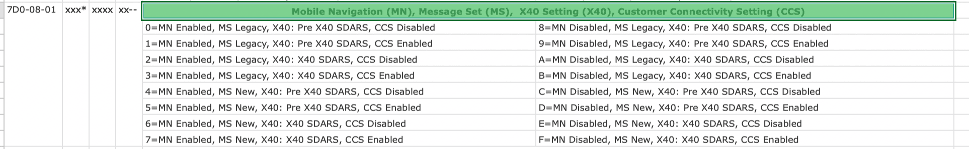

Just figured out how to do this on the lariat after doing some decoding.
APIM AS BUILT
7D0-08-01
xxx6-xxxx-xxxx
Write the Changes!
Factory digit for Lariat's is a 7
This disables Customer connectivity settings which I am almost sure will disable this screen!
Ford Maverick NEW FORSCAN MOD to Disable Annoying Radio POP UP Screenshot 2024-06-17 at 1.27.53 PM

Yep with this mod you can keep ford pass active and you do not get this message anymore!
