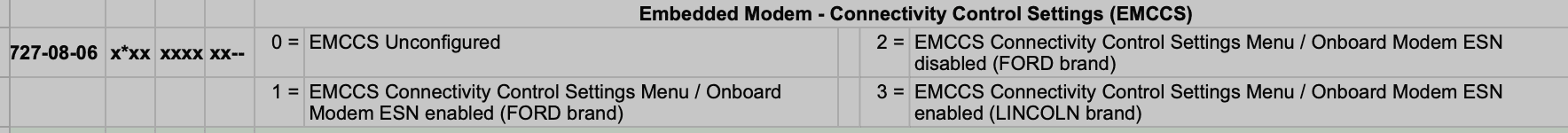

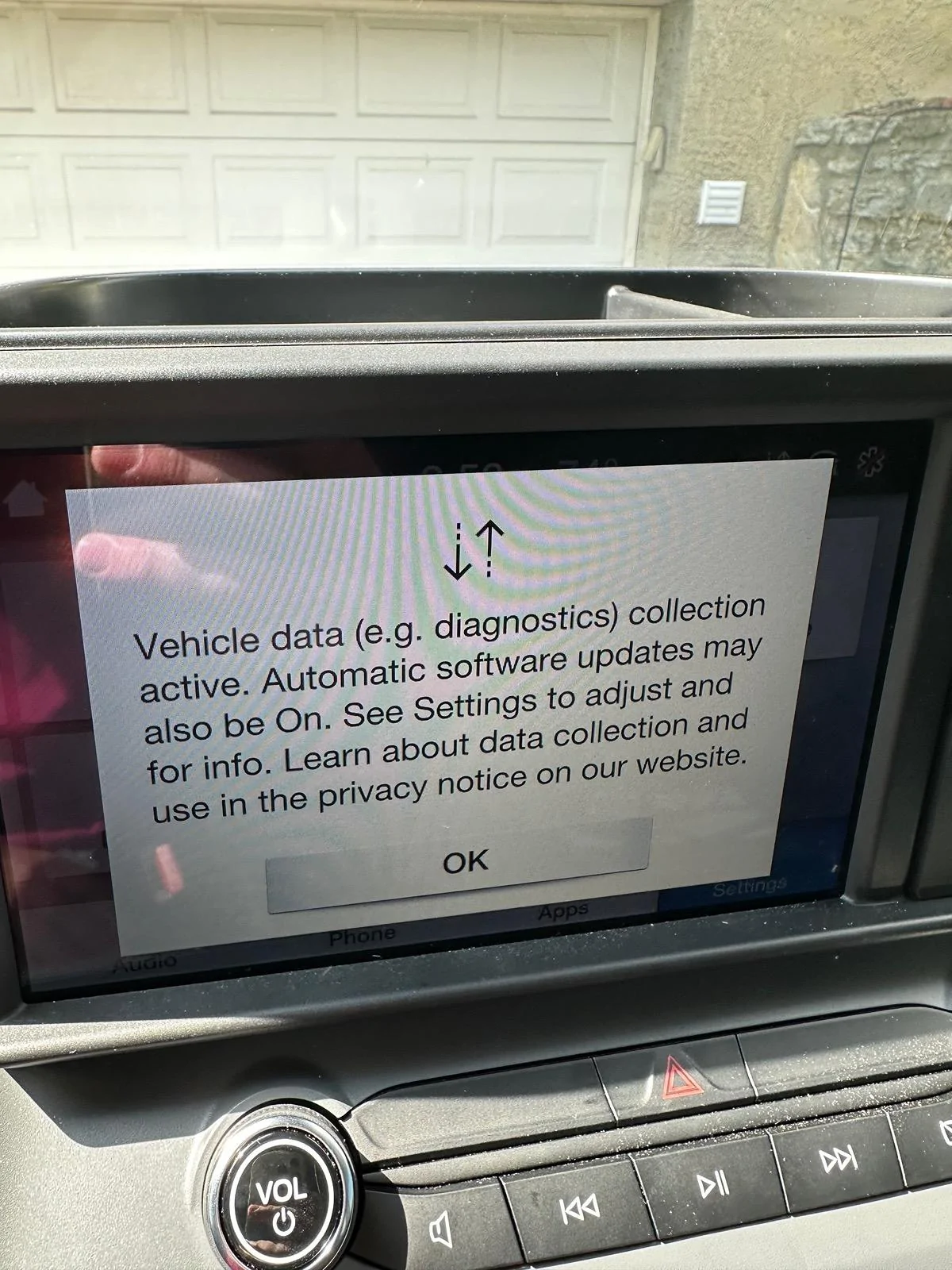

Check out this annoying pop up that comes up every single time you get in and drive the MAVERICK. (pictured below)
Many people have requested I try to remove this pop up via forscan and I HAVE FIGURED IT OUT! Coding Instructions below.
Please let me know if this works for you Maverick Owners!!
EDIT: ONLY WORKS ON XL, XLT. This coding change will NOT work on a LARIAT.
I believe a change would need to be made in APIM in the Lariat not the ACM!
ACM as Built
727-08-06
x2xx-xxxx-xxxx
Factory Digit is a 1. Change it to 2. and WRITE THE CHANGES

A bunch of people on reddit complain about this screen. So I find how to disable it. Then I post about it on here and everyone on Maverick Truck Forums swear they have never seen the screen in their life. :cwl:
SMH:facepalm:
I see it if my phone doesn't connect to the Android Auto app in time....so I don't see it every time, but just enough to make my BP surge a bit.

Yes I got the same pop up. The weird thing about it is that I went into my settings to see what was going on. The system said it was down loading some update I guess. However the the graphed stayed a 0% for a long time. I just gave up on that. I will see what happens this week to see if I get this message again.
