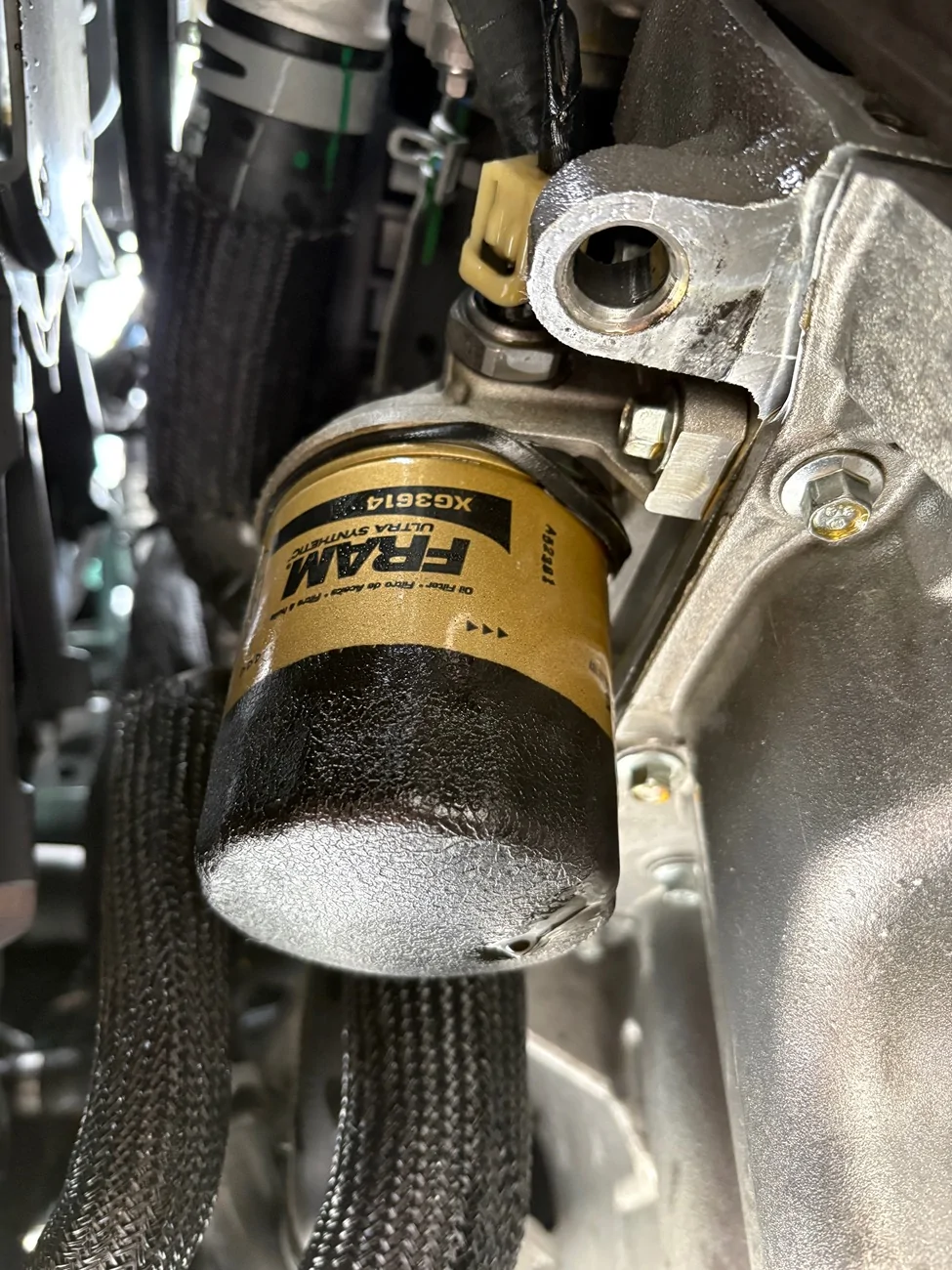

I CAN say say with certainty I’ll never forget to check moving forward.
Not sure how the hybrid is laid out, but most every car I've owned has allowed me to visually see at least some of the filter housing mating surface. I have made a habit of going a step further and wiping that surface off all the way around with a clean rag. It isn't a bad idea to clean it, plus I get to lay my fingers on it and prove there isn't an old gasket left.

I would swear it wasn’t there and that I saw it but clearly I did not 🤦‍♂️

Wow - are you sure that's the correct filter? I once had O'Reilly's pull the WRONG filter for a car as they keep them behind the counter and you don't pick your own like in AutoZone. It threaded in, but the gasket was the wrong circumference. Also made a BIG mess as it self-unscrewed (much more to the story, including O'Reilly paying for a new turbo install for our old EcoBoost Escape, but you get the idea). I always compare old to new filters when installing to make sure they match, including gasket design.
is it also possible that the gasket from the old filter got stuck to the engine, and when you screwed on the new filter you double-gasketed it?
Wonder how that happened. Good Luck!
Had the double gasket issue on my snowmobile a few years ago... Got about an 1/8 mile from the hotel after arriving and blew oil all over the trail and the entire engine compartment. UGH !!

First time in my life I’ve had gasket fail on an oil filter and it created quite the mess…
Sorry Cal, that sucks.
But as "Aleks" posted. You found the problem, remedied it. Now you're just looking for that fiber splash Shield.
