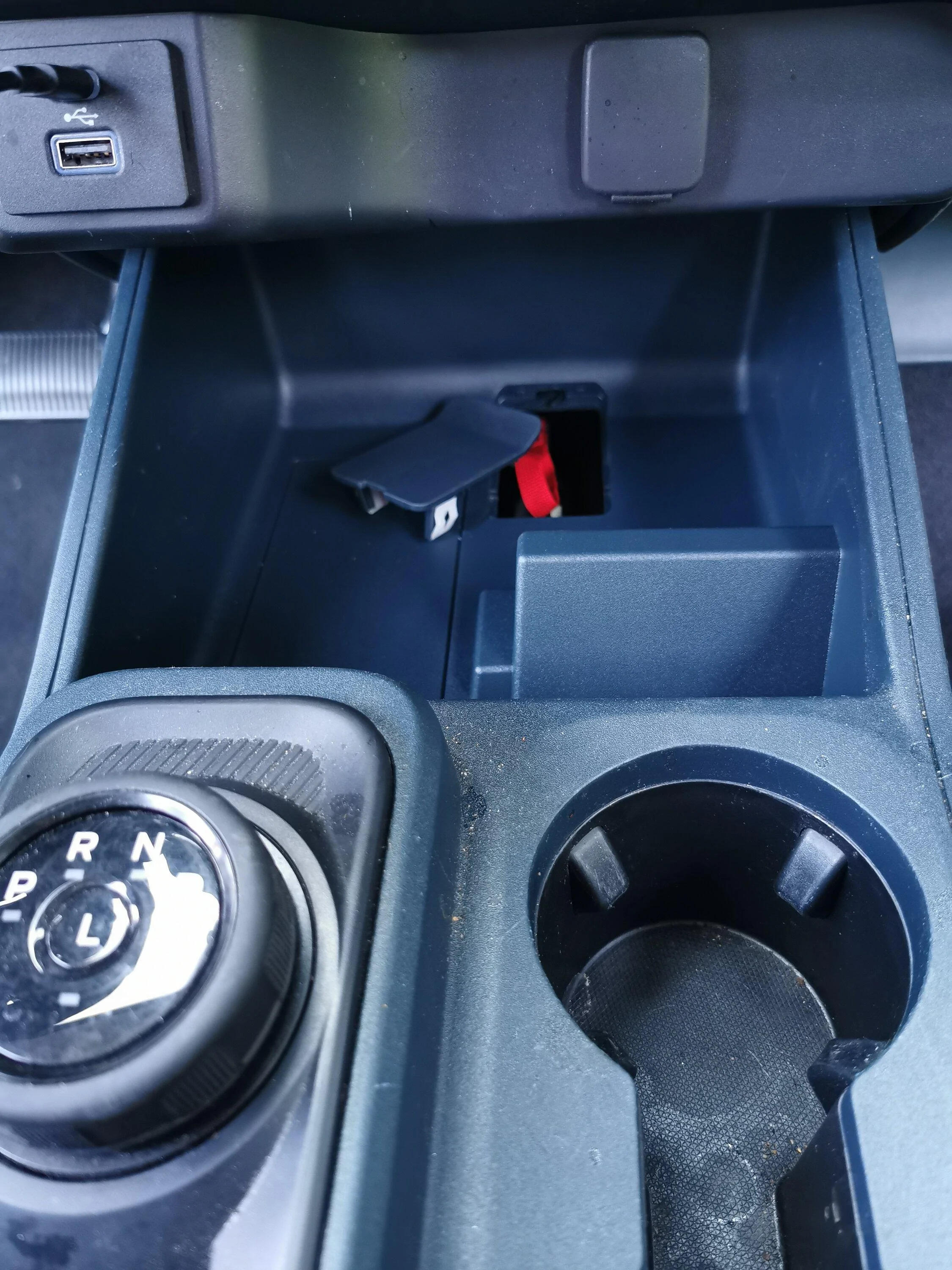

I'll take this. BMW puts this under the car beneath a plastic panel. A total pain if you need to get neutral. This looks great!

Manual park release cable, not park break. Basically like putting the transmission in neutral.
If you have no power and can't shift it into neutral for towing, you can pull that to free the transmission from Park.
I wonder how many tow truck guys know about this.

What does this red thing do? Can't find any info in the manual.
Thanks
I'm wondering how 🤔 you found that, I'd have the Maverick 10 years and never think to look there.
🤣. Can't wait to see what else you might find 💰

Lol. I was giving it a deep clean and found that.
