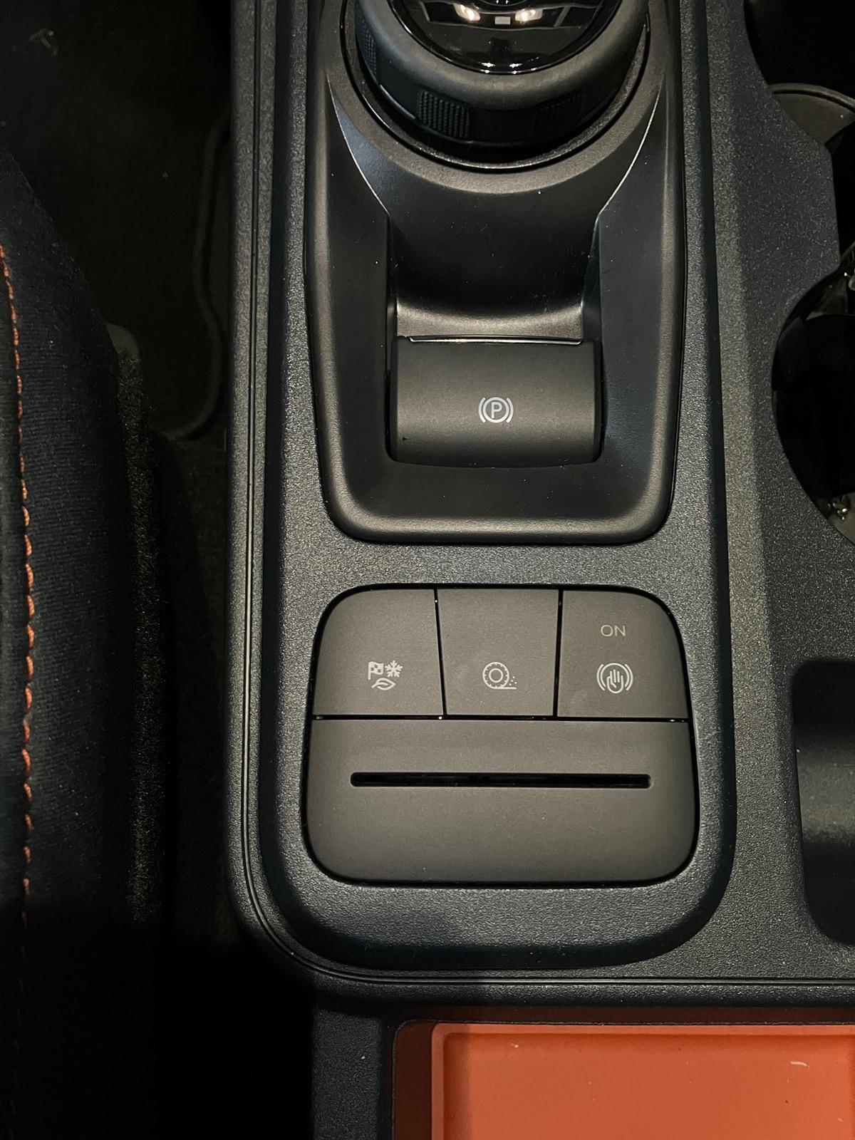

Why does my ‘24 XLT hybrid have ( or not have)switches that aren’t in the manual or quick reference guide? The console switch on the right in the photo? It’s not in the symbol index.
And the auto start- stop shut off switch? I read about it in the manual, I know what it looks like.

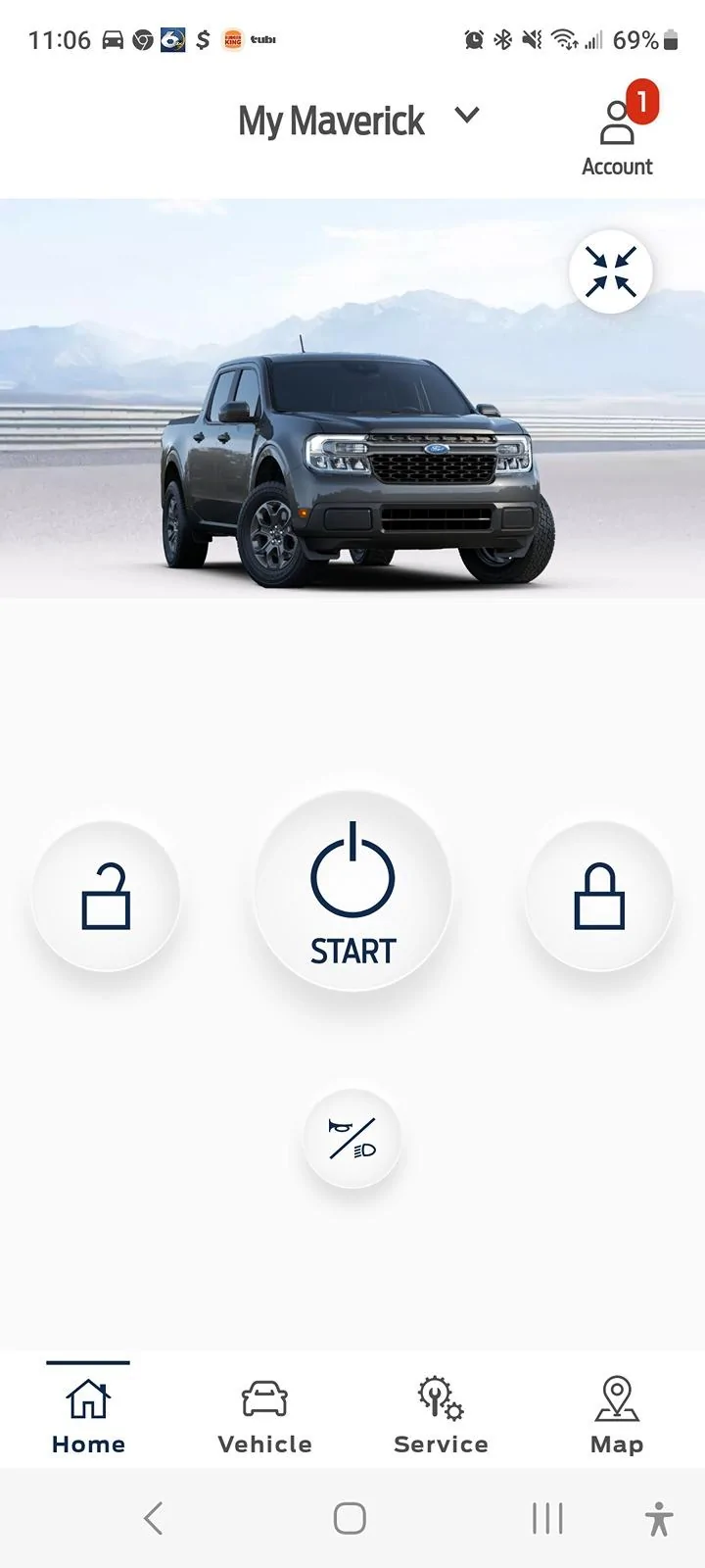

Auto start stop will be on your Ford Pass App it will crank your car at a set time the switch on the right if you are talking about the switch with the hand once you stop at the light and release your break it will sit there until you mash the gas your car will not roll I believe it's called Break assist I could be wrong about the name but not the function
That is a "scheduled start," not the auto start/stop being discussed here. The two concepts are not related.

maybe I'm confused about auto start then I thought that meant you can hit a button to start your car without being in it and you can also do that from the Ford pass and at the same time you can schedule a start to crank up at the same time every day two different start features so maybe I'm just confused about auto start I thought auto start

Apologize one of my earlier comments about the Ford Pass App it is a remote start on the app not auto start

You are correct I was incorrect that is a remote start that I'm referring to not auto start

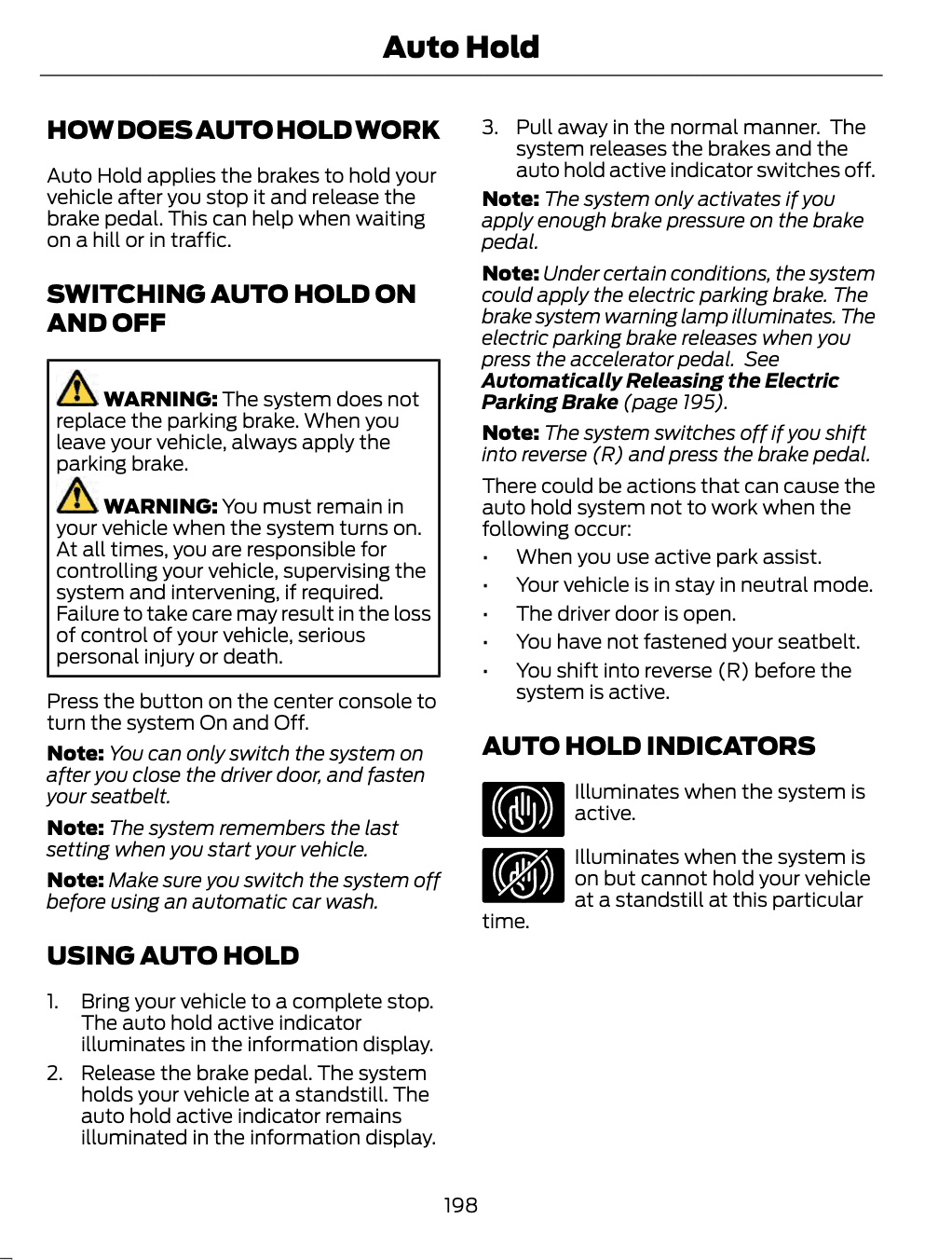

The switch on the right activates your brake hold function. When you pull up to a stop light with it turned on, you can take your foot off of the brake pedal and the brakes will stay engaged. Just press the gas and off you go.
