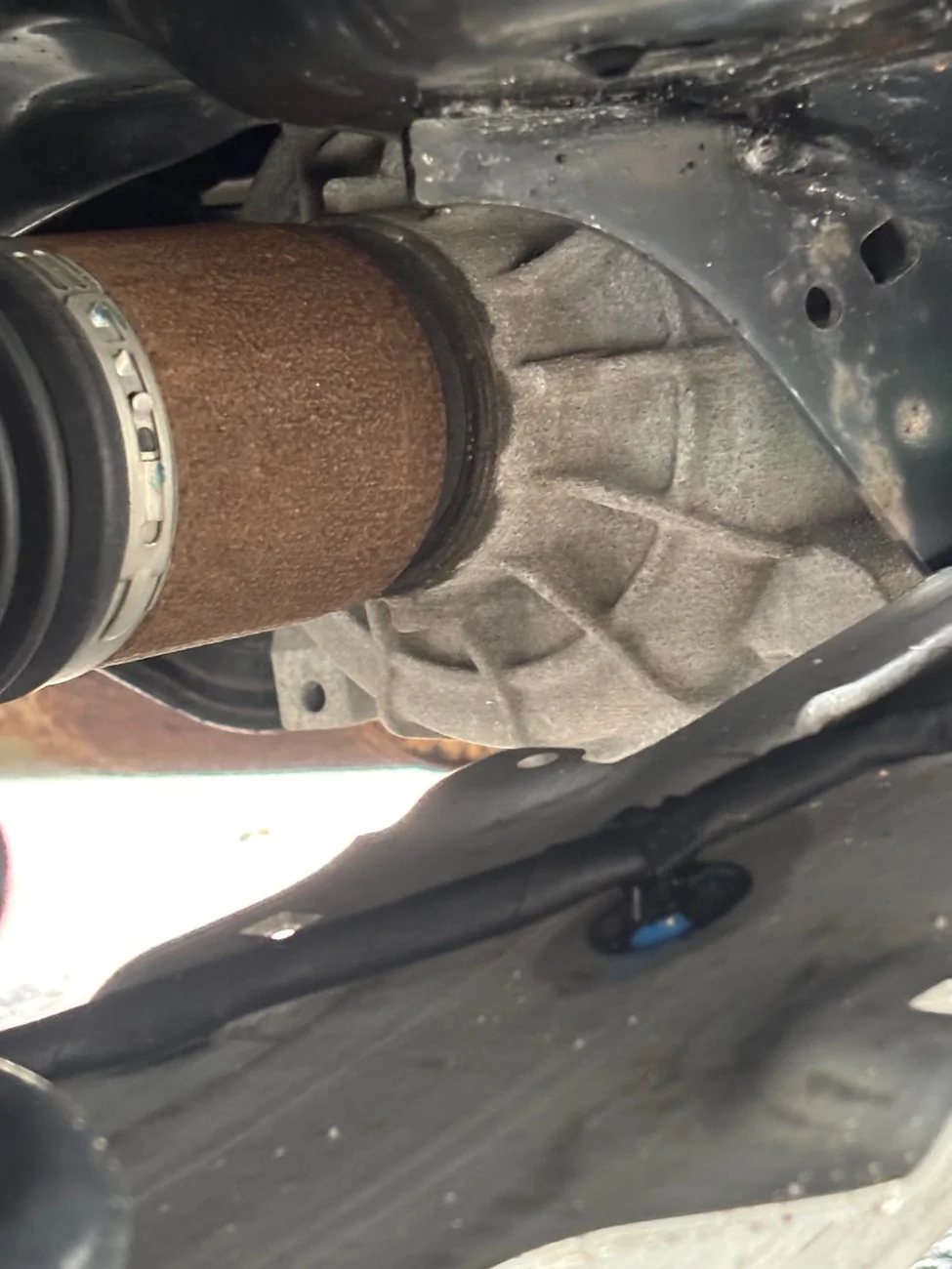

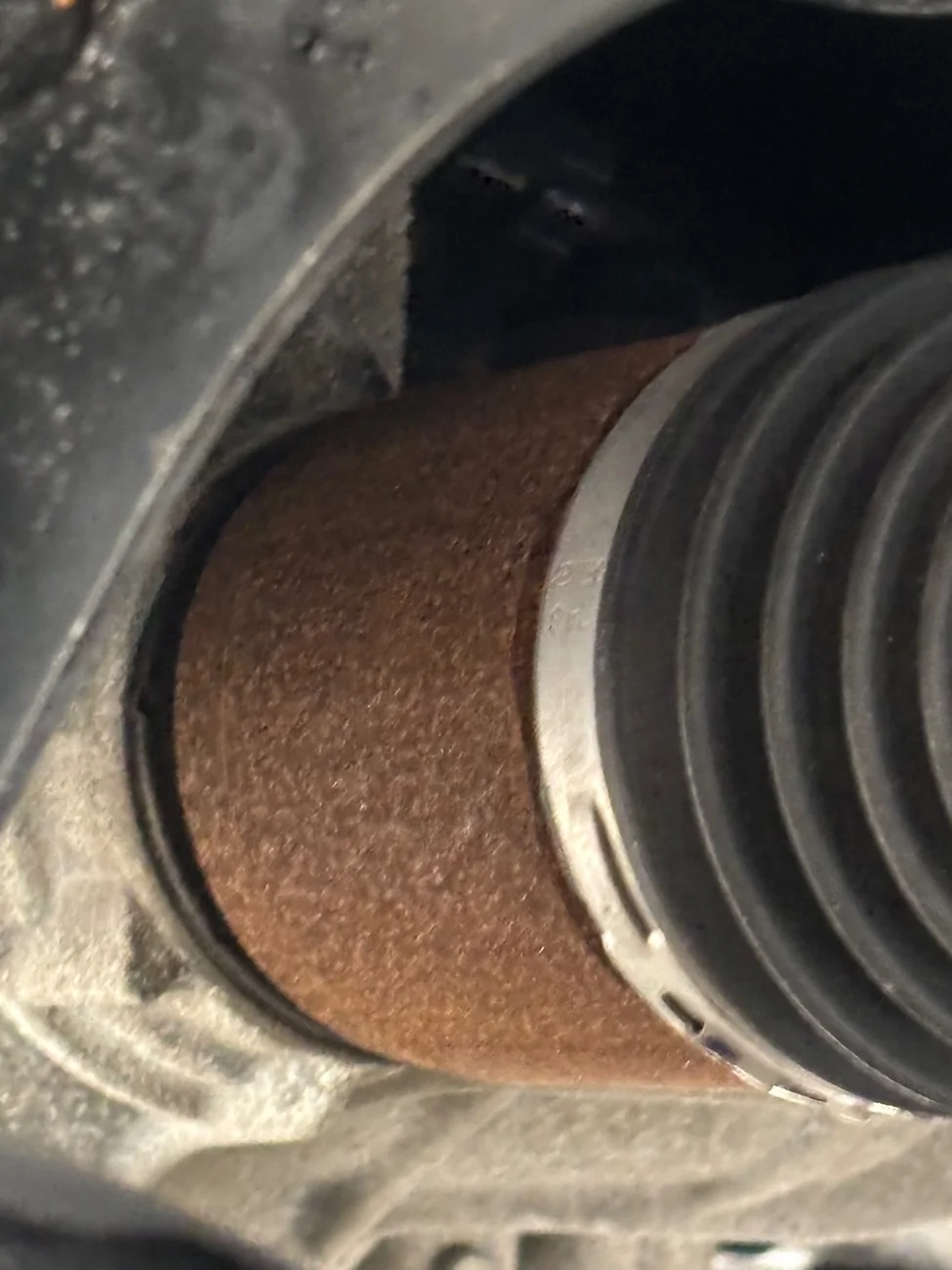

I've been listening more closely for this sound and it might be coming from the rear... I took a look and there appears to be a leak where the driver's side axle goes into the RDU. A picture of the passenger side is for comparison.

Seeping aint leaking. Prepare yourself for that dealer response.

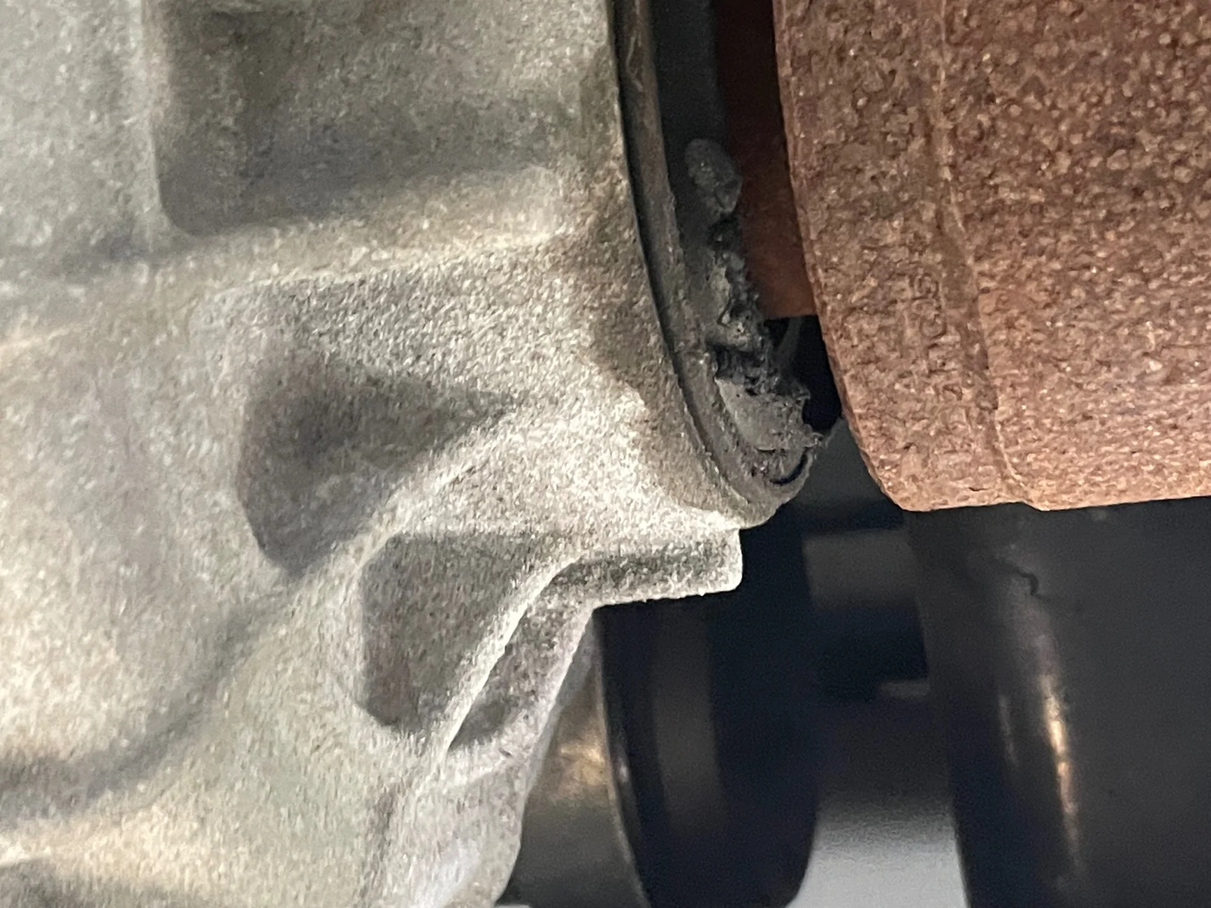

I have an appointment with the dealer in a couple of weeks so I'll see what they say but I took a closer look at the RDU and there's some "gunk" build up where it's leaking.

Ask the service tech confirm that the RDU is "full" of fluid.

New dealer on a visit today "Rear differential does show signs of slight grease seepage around axle seals but this is considered normal and is not indicative of a rear differential gear oil leak. Ford won't do anything about it"
I chased that rabbit a couple of times and all I got was tired...
