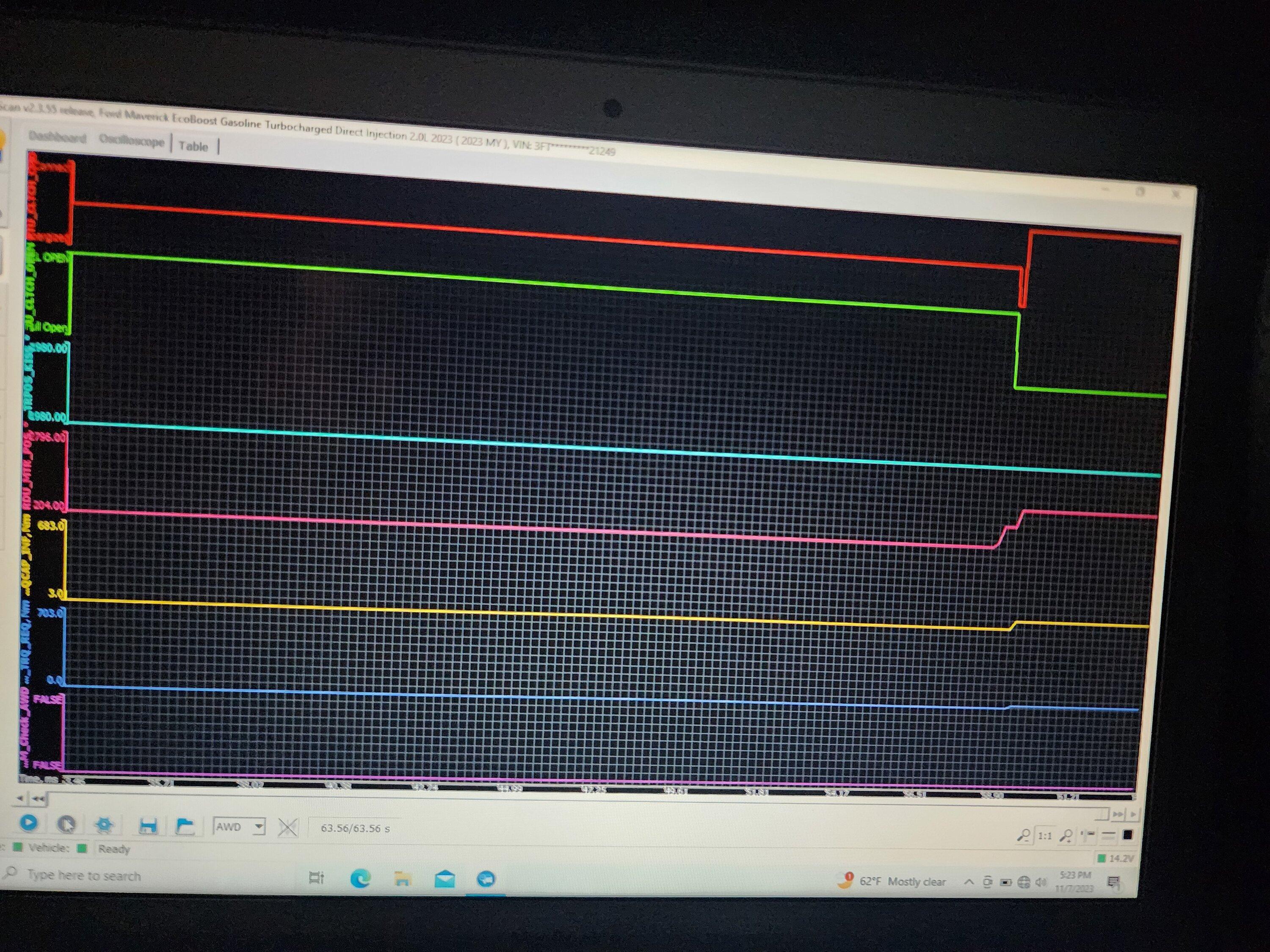

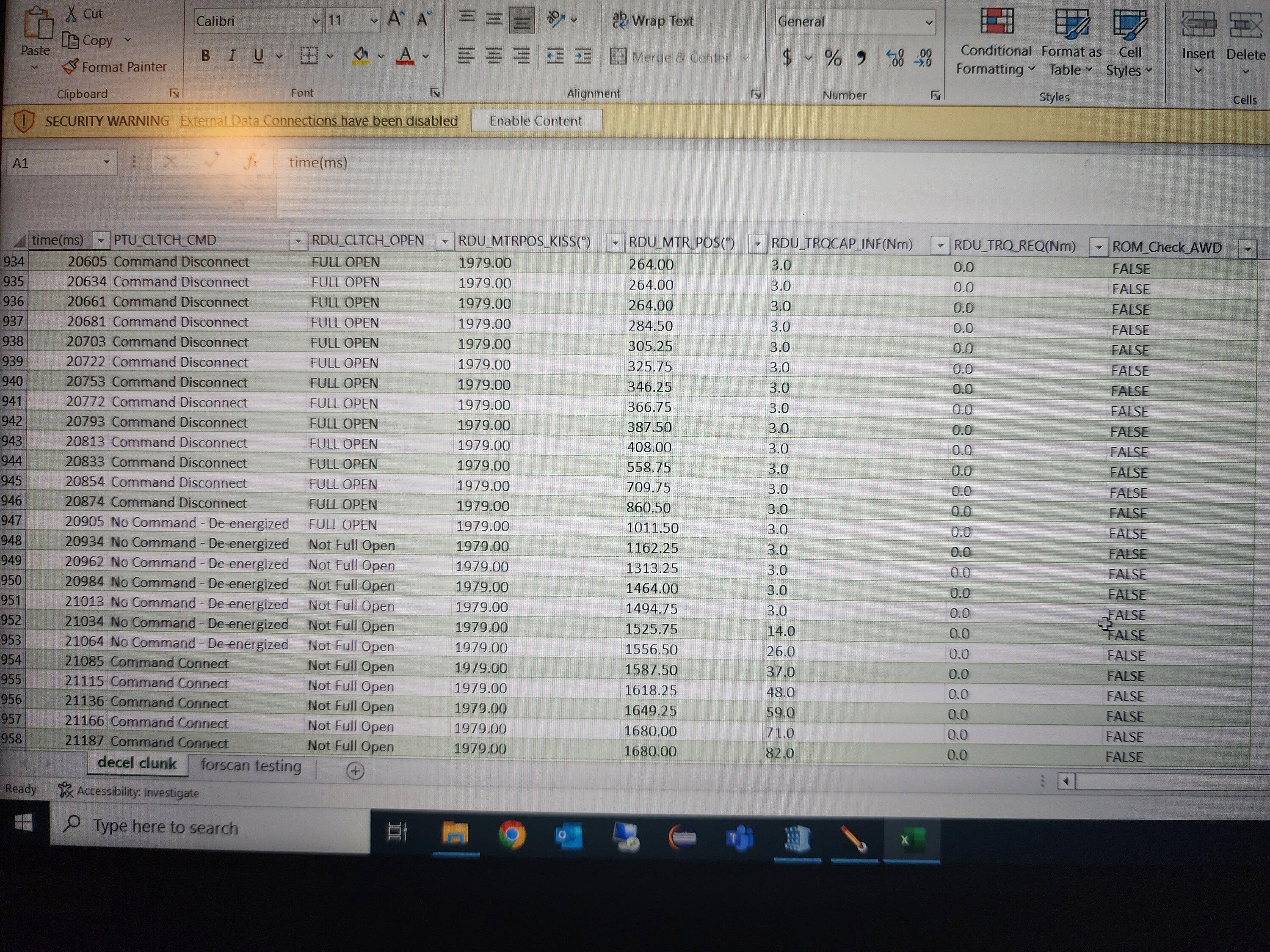

I have never used forscan but I’m interested in learning more about what you’re showing
in the first image, the spike in the yellow line for -RDU_TRQCAP_INF is what I assume to be the “clunk” event?
was it engaging and then disengaging the driveshafts or doing something else?
I think the main parameter of interest out of those that I posted is RDU_MTR_POS. I believe the magnitude of that value corresponds to the clutch engagement in the RDU. I highly recommend forscan, lots of tutorials out there. It is a great diagnostic tool for nuanced issues like this one.

i feel like this could be the PTU.
I am leaning towards the RDU, reasoning detailed below:
- The clunk noise is very noticeable from the rear of the vehicle. No perceptible noise from the front.
- There are multiple service bulletins out on other Ford vehicles with the same style AWD system with a rear disconnect drive unit making noise during low speed maneuvers. I believe the service bulletins call for a software update to correct the problem initially. A software update coincides well with the steps I took to fix the issue, even if it is just a temporary fix - AWD module relearn.

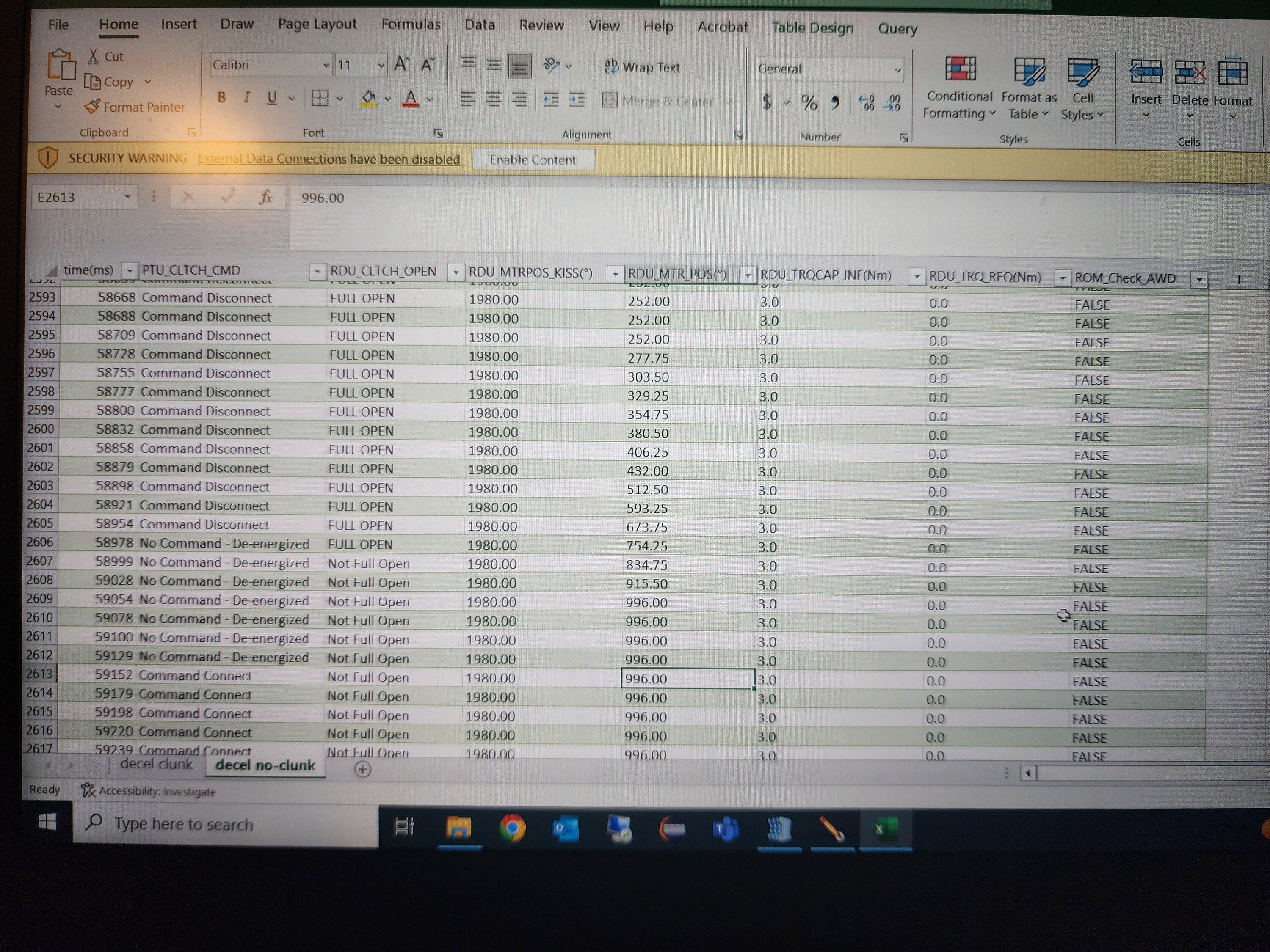

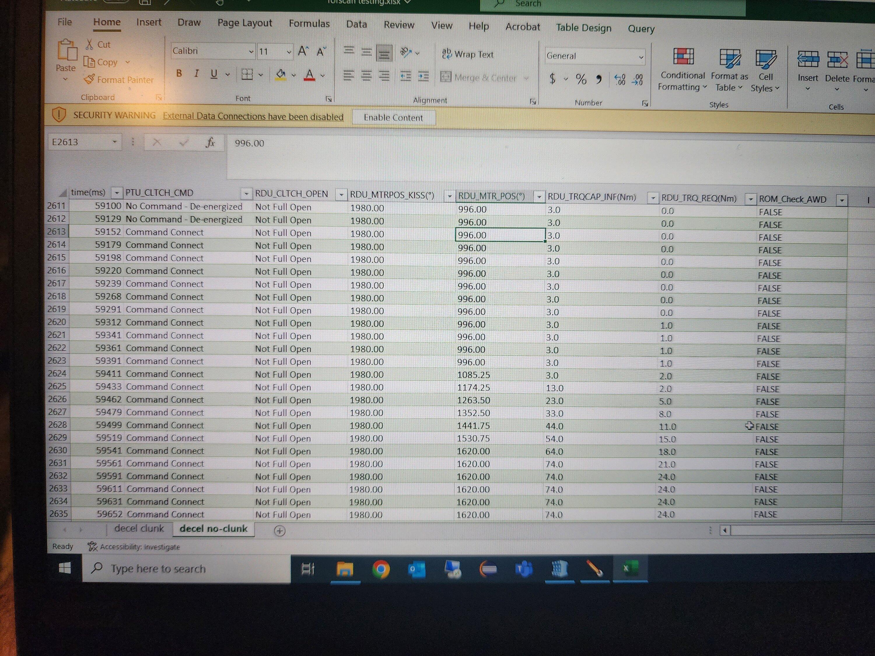

- If you look at PID RDU_MTR_POS in my pictures above there is a huge difference in how fast the clutch engages in the first picture (prior to the adaptive learn reset) and the remaining pictures (after the adaptive learn reset). I have this information exported to a csv file and in the first picture the clutch goes from minimum engagement to full engagement in ~505 msec, in the remaining pictures the clutch goes from minimum engagement to full engagement in ~832 msec. It also doesn't ramp in one sweep like the first. It ramps up roughly halfway on the scale and holds for ~337 msec. That initial ramp and hold likely makes for a very smooth and unnoticeable engagement where the full ramp before was noticeable.

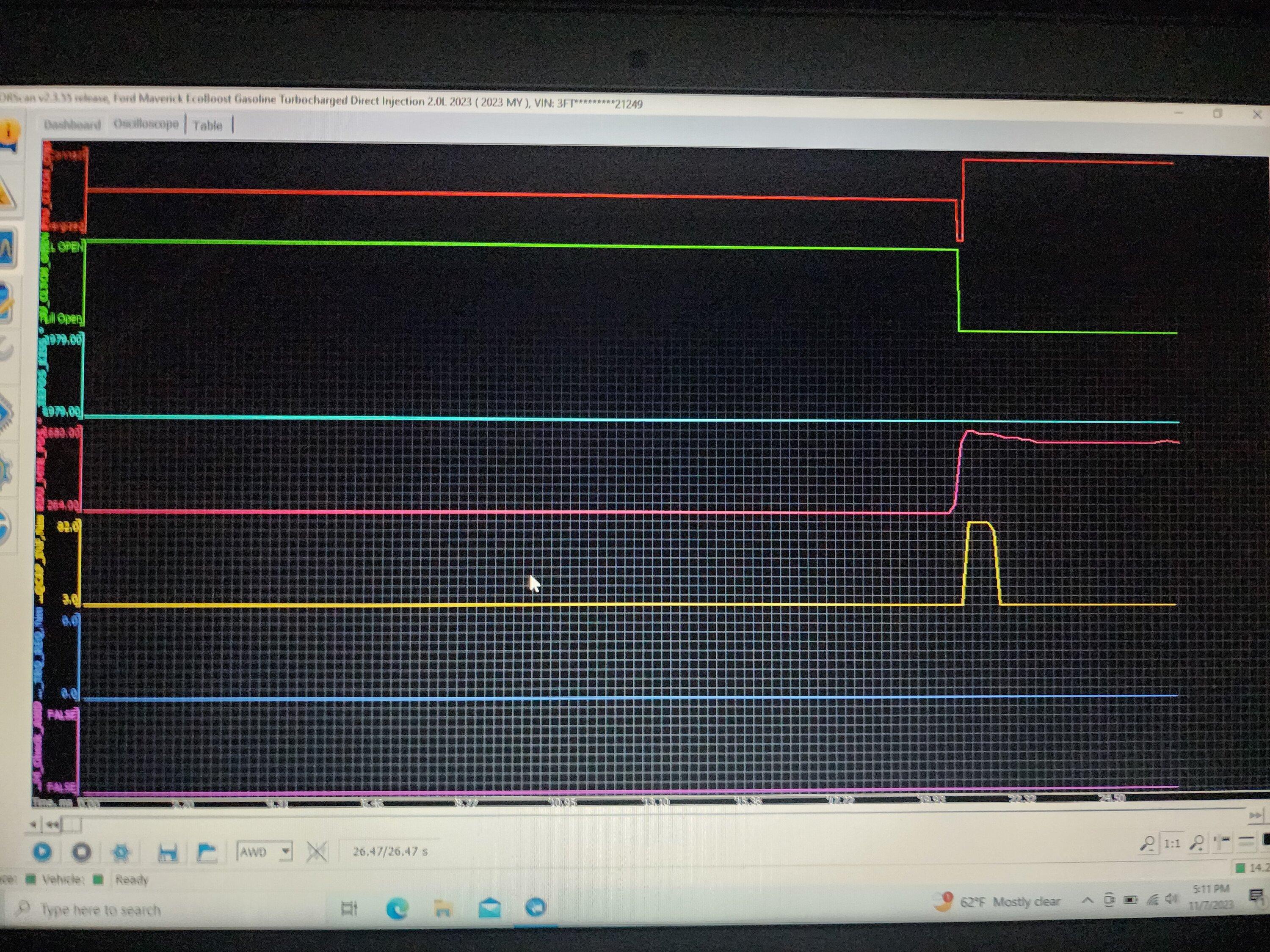

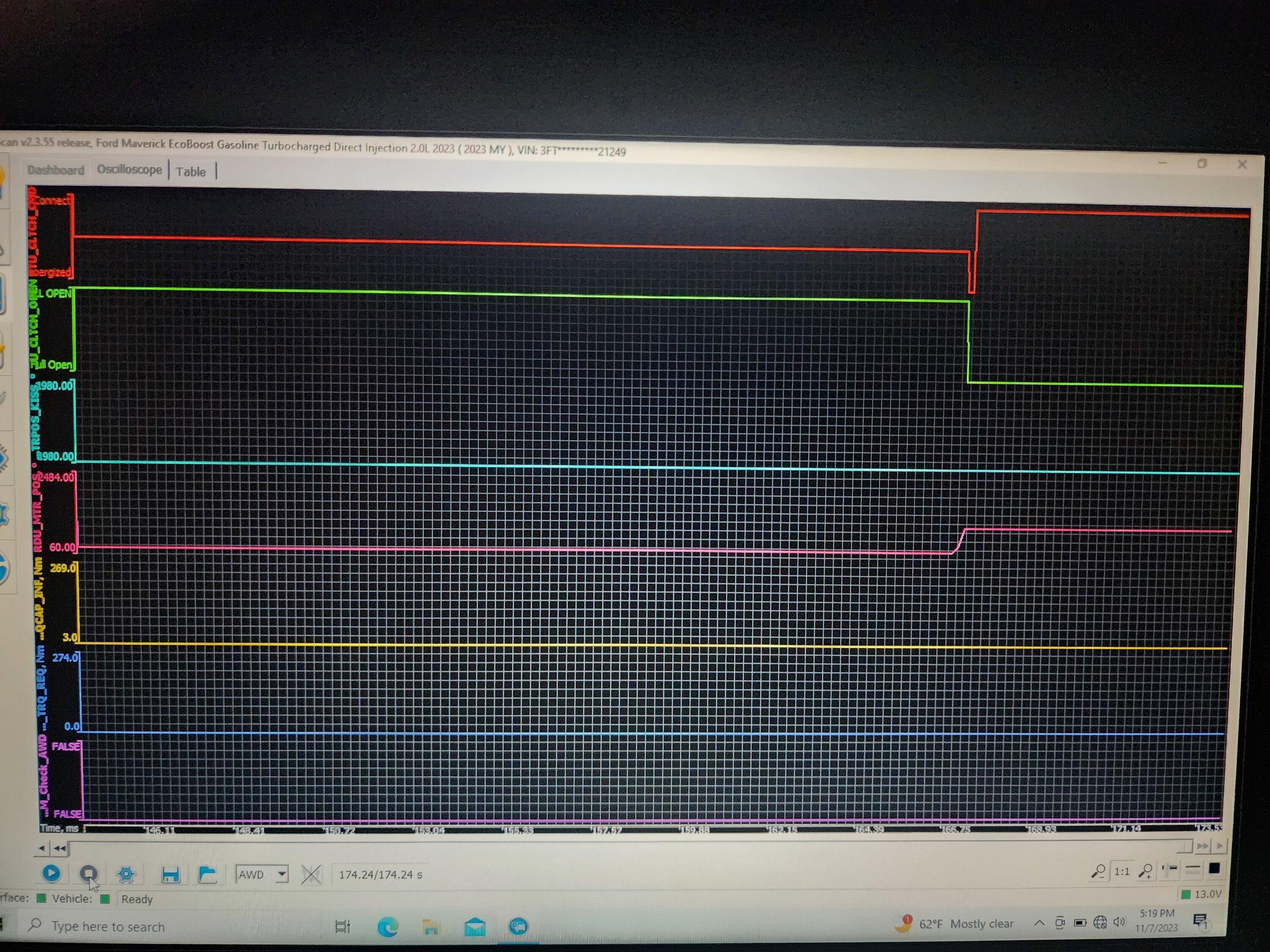

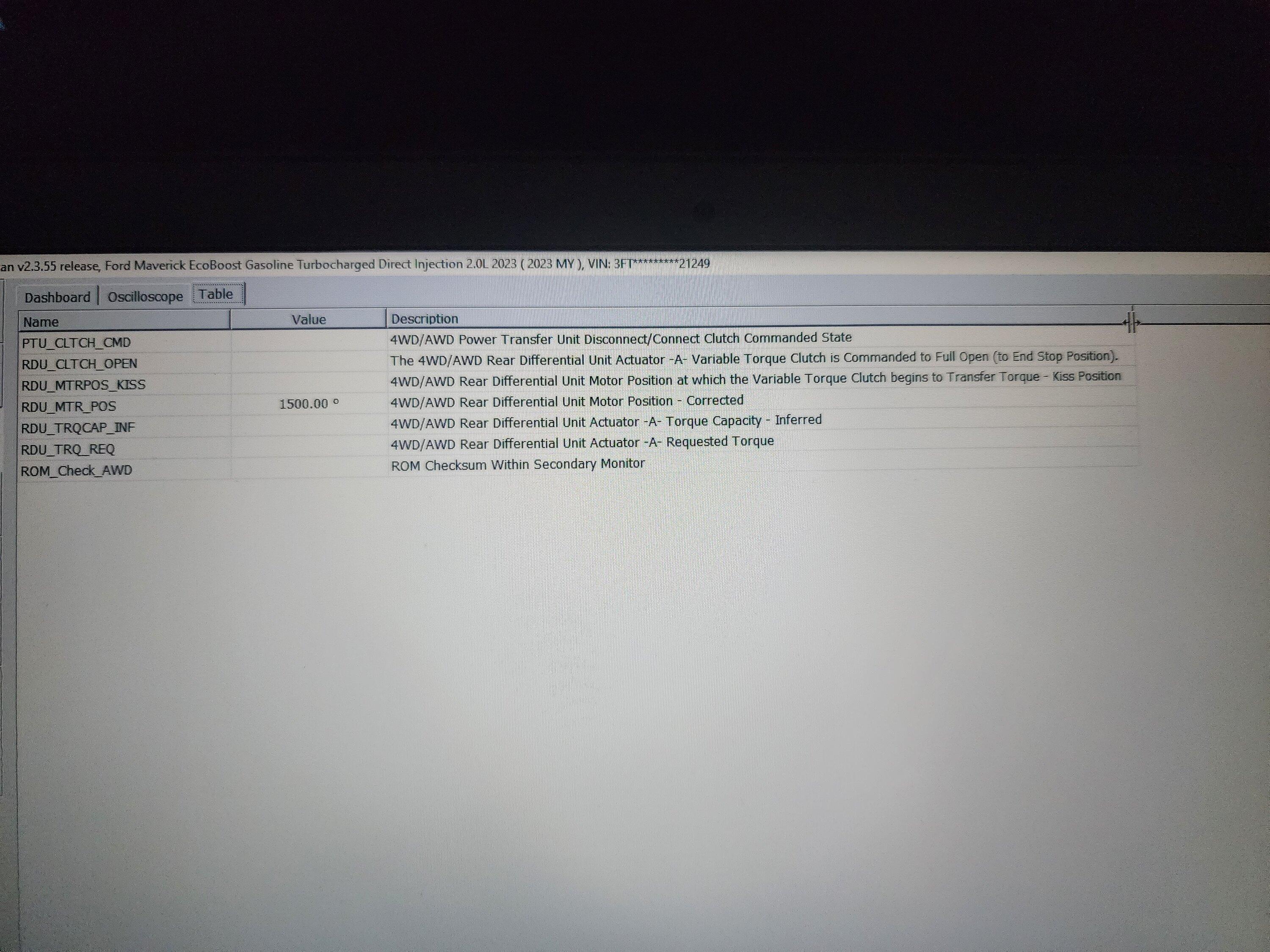

I checked under the truck and everything is secure, no suspension movement anywhere, driveshaft and half shafts felt solid at the RDU. So I went and hooked up forscan and got it to clunk immediately. It happens right at 16mph only while decelerating. See attached forscan images of PTU and RDU PIDs. The first picture is an event capture during a clunk. The second picture is the list of PIDs and the order they are plotted, see summary below as well.
-PTU_CLTCH_CMD
-RDU_CLTCH_OPEN
-RDU_MTRPOS_KISS
-RDU_MTR_POS
-RDU_TRQCAP_INF
-RDU_TRQ_REQ
-ROM_CHECK_AWD
The third, fourth, and fifth pictures are event captures without a clunk after performing an AWD module adaptive learning reset. I figured I would try an adaptation reset on that module to see if it would clear up the clunk or at least change it to further confirm my theory of the RDU being the issue or related to the issue. Had good results with cleaning up clunky shifting on an F150 with the notorious 10 speed. Sure enough it drives completely normal again. I exported those recordings to a csv file and will do some more detailed analysis tomorrow. Will report back with additional information and if the clunk seems to be gone still.
I feel like I need to add some additional information to the pictures above. As mentioned previously I think the main PID of interest here is RDU_MTR_POS. It is the PID that changed drastically after the AWD module adaptive learn reset. The pink and yellow lines also appeared to be different. However, after additional testing today those lines track inferred and requested torque. They really only start to pickup when the RDU has actual load applied to it during acceleration or sitting still in drive with torque applied to the RDU and the RDU clutch engaged. They do not start picking up during deceleration even with the RDU clutch engaged. I believe the varying results on those two traces is a result of me not coming to a complete stop during testing or coming to a quicker/slower stop.

Pictures of the csv files for clunk and no clunk events. The first tab is the clunk event and the second tab is the no clunk event titled forscan testing.
Ford Maverick FX4 Ecoboost Rear End Clunk During Deceleration 20231108_175510
Ford Maverick FX4 Ecoboost Rear End Clunk During Deceleration 20231108_175553
Ford Maverick FX4 Ecoboost Rear End Clunk During Deceleration 20231108_175610
