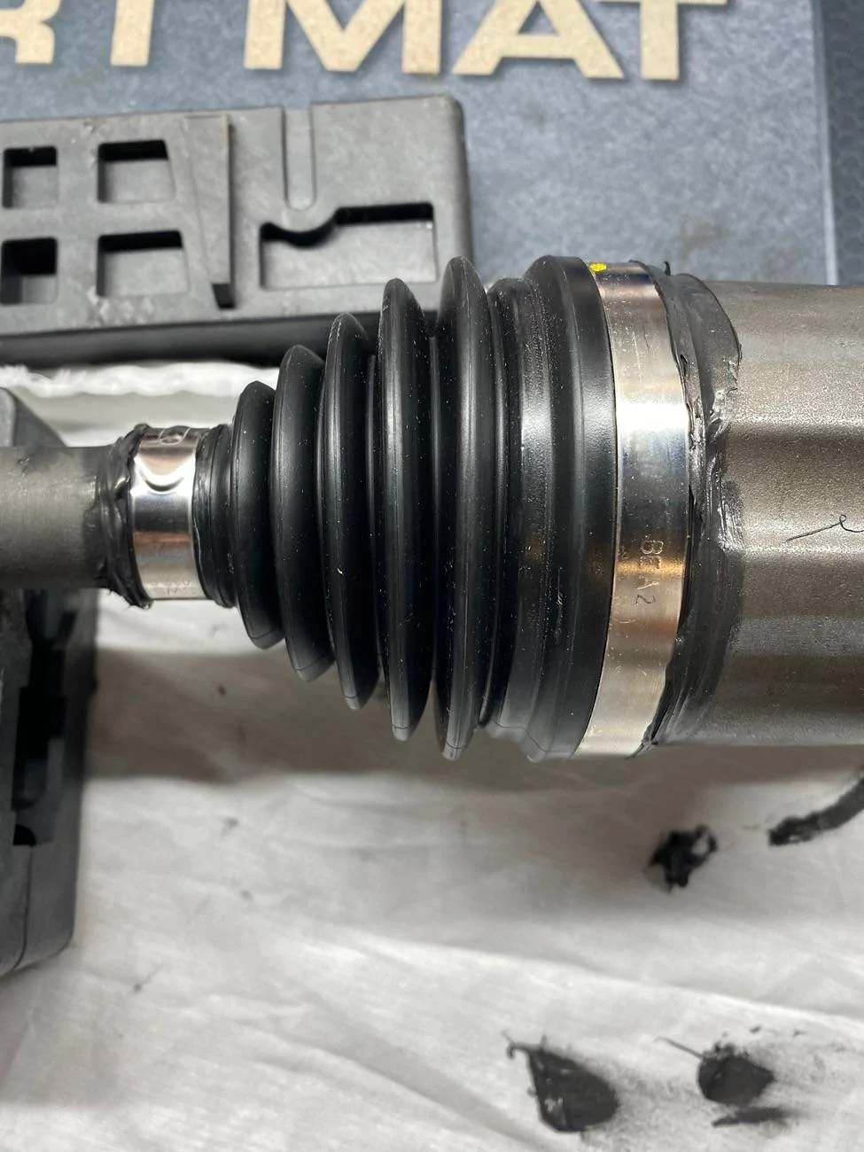

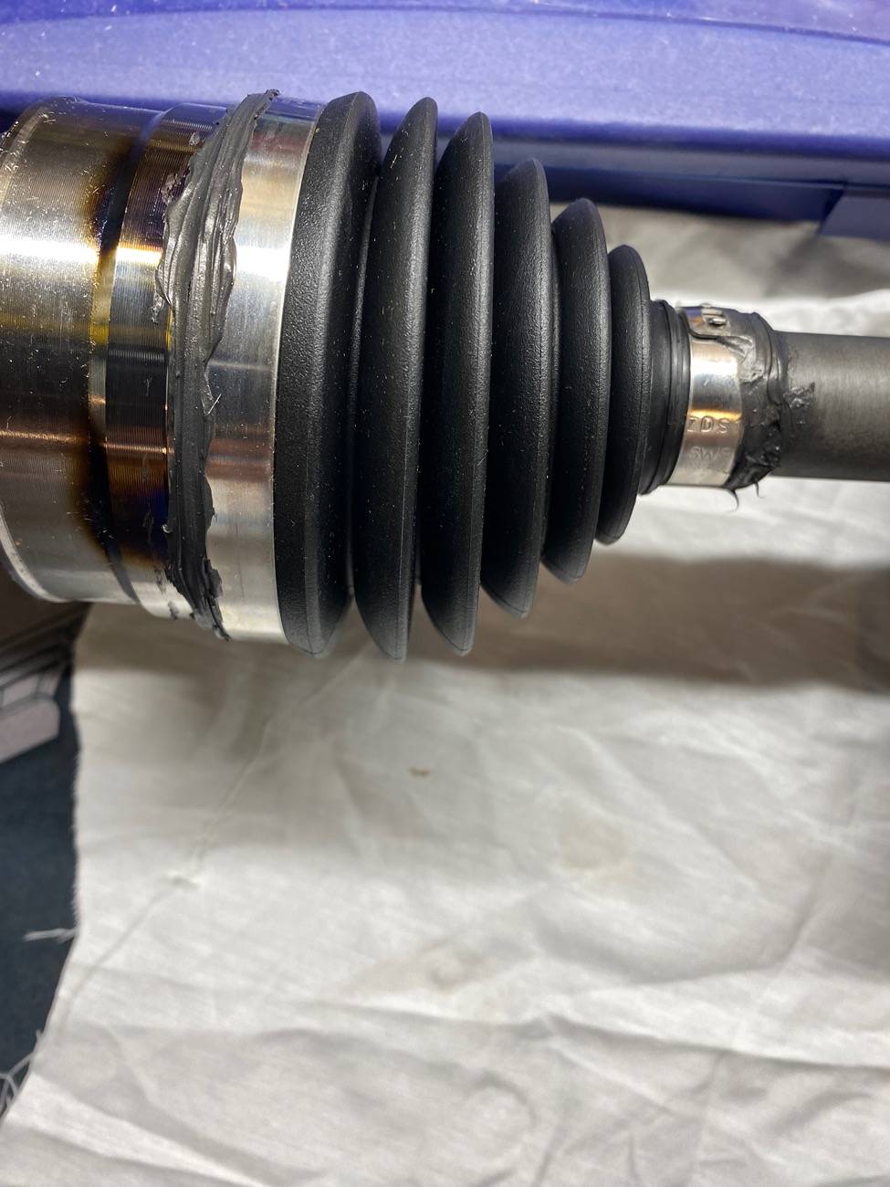

I changed my oil the other day. While underneath, I took a look at my CV axles and I didn't see any leakage. I have just over 9,500 miles though.
Looks like it is seeping out where the clamp is. See that dark part of the axle shaft. Mine is doing the same thing.
