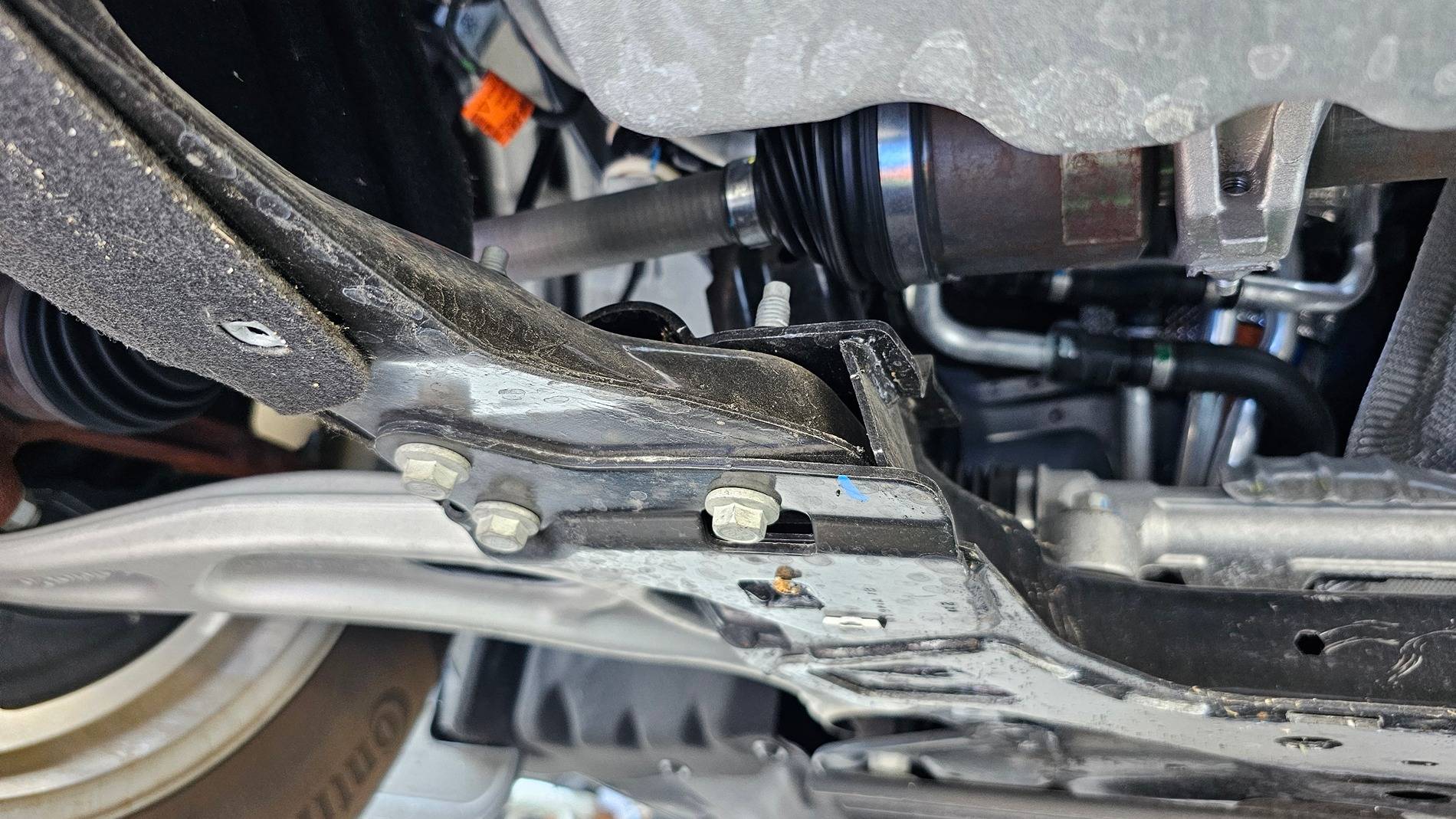

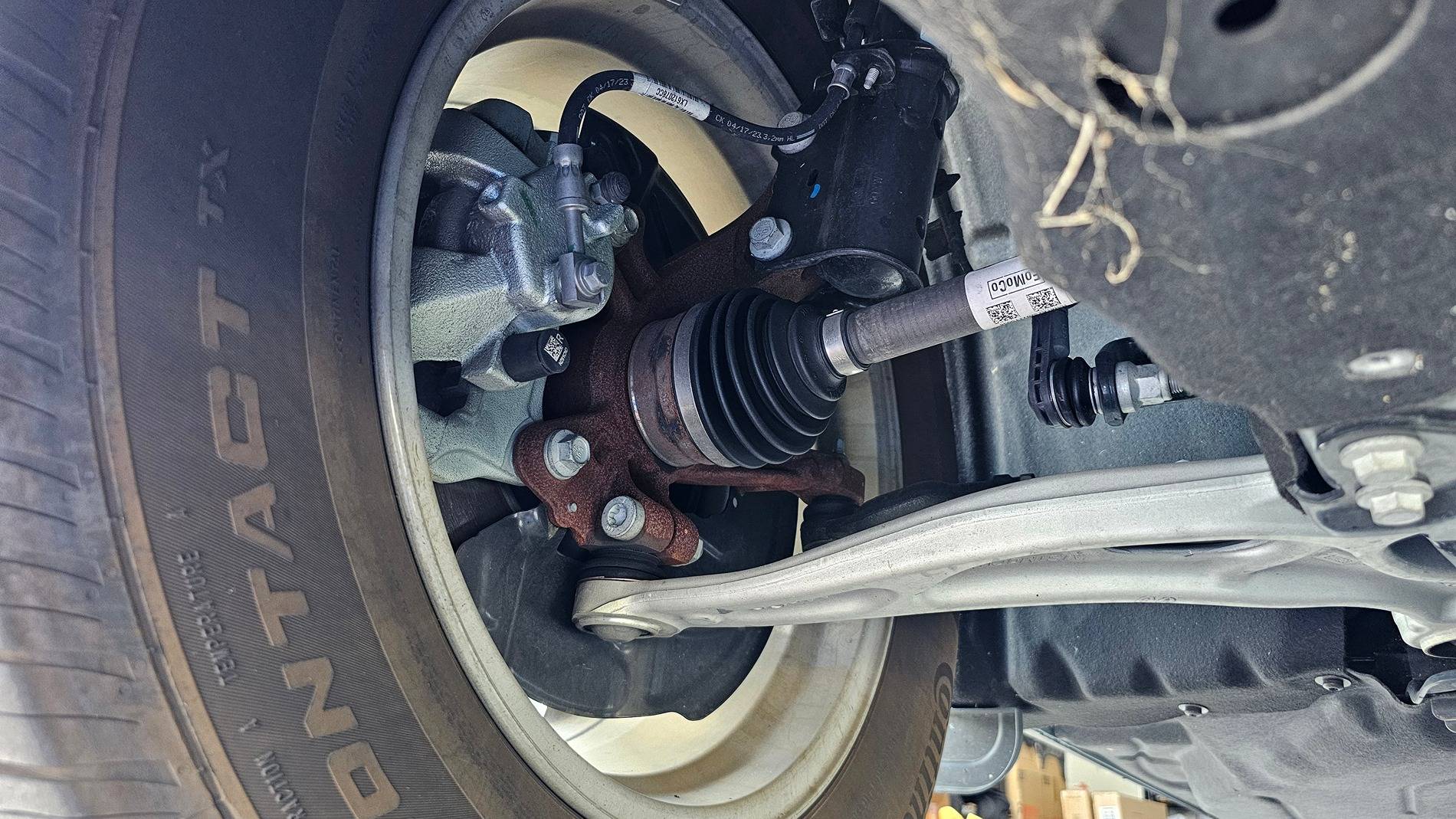

I changed my oil the other day. While underneath, I took a look at my CV axles and I didn't see any leakage. I have just over 9,500 miles though.
