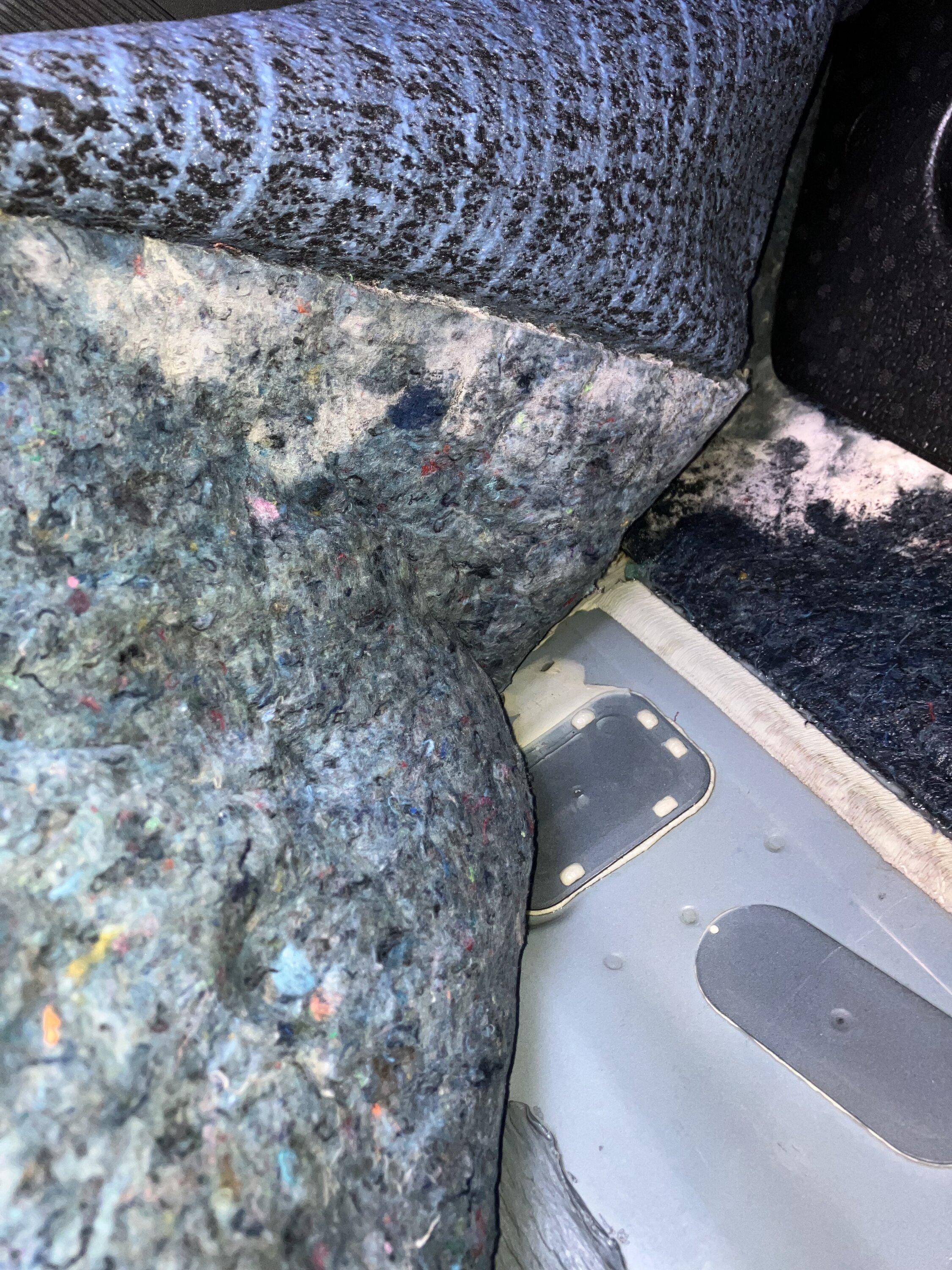

Have you checked the caulking along the seam up under the dash. You will have to move the mat back out of the way to see it. If it is damaged it will leak at these seams. Had a ranger do this and used silicone to seal and water stopped getting in. Just a thought.

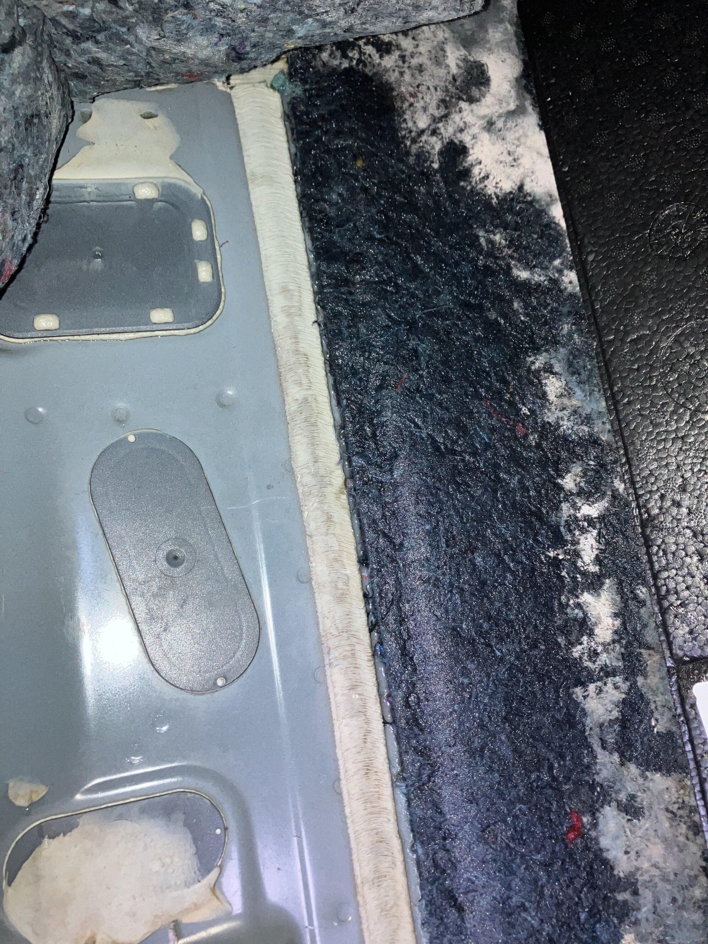

Have an appointment for this now next week after I noticed it was wet under my passenger hard floor mat and mold started growing. The service writer at the dealer tried making it seem like this was my fault by implying I probably drove through a deep puddle.
I see this and the loose engine cowl, anything else I should tell them? They said it wont be covered under warranty if it came from driving in the rain vs rain getting in somewhere up top which I think is BS.
Built jan 2023, keep it in the garage so I never noticed until driving while raining 1.5 weeks ago. No clue if it only gets wet when driving or if parking outside in rain would cause it too.

Dealer can't find anything but said they can keep it overnight to see if they can see tomorrow. Guess I have to wait and see, will probably sell if they can't so I don't have to deal with corrosion and mold.

Same here. Been to the dealer three times for multiple days at a time and they've found nothing. Praying for a recall at this point or I'll sell early.

I would say it's possible to have a windshield that was not sealed properly, or moisture from the A/C is being trapped inside somehow. I don't know where the 'door' is to change the cabin air filter, but that could let rain in too, if it's not snapped tight.
The cabin air filter gets changed by pulling out the glove box. It’s behind there.
