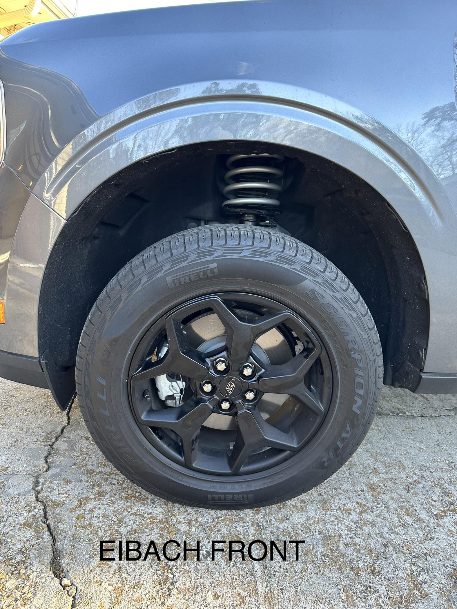

I’ve had them on for about 500 miles now. I really like them! It will definitely be a “tighter” feel similar but imo smoother than a Tacoma. Still haven’t swapped front camber bolts but those ARE needed for Eibach kit. It’s barely noticeable but me/Ford service noted a positive camber.
Overall I think it still a great deal with lifetime warranty, you just need to factor in any labor you’re unwilling/unable to do. Vs some of the spacer kits being pretty close to 100% DIY. Lmk if you have any specific questions.

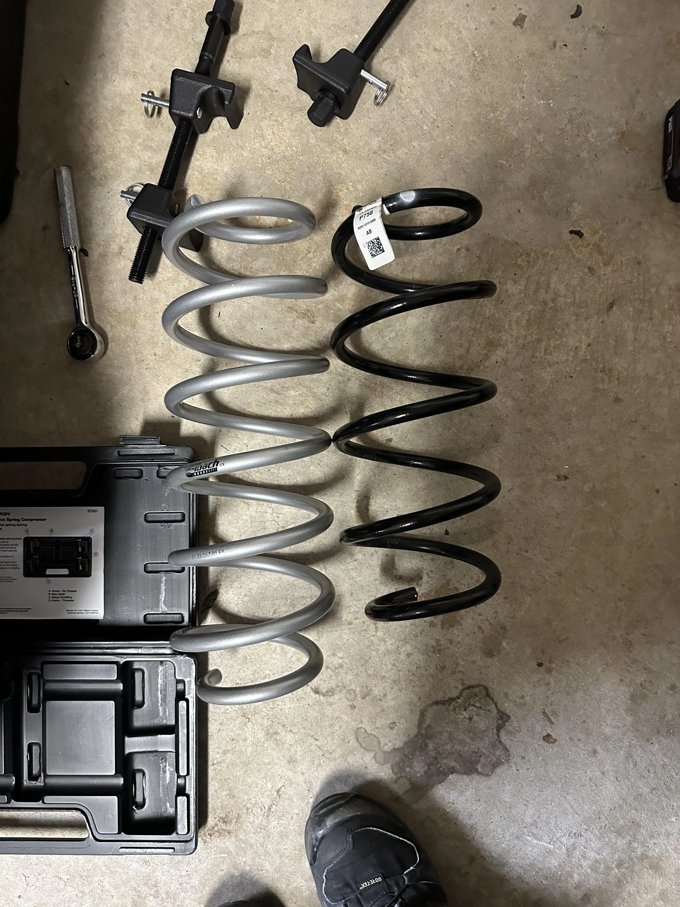

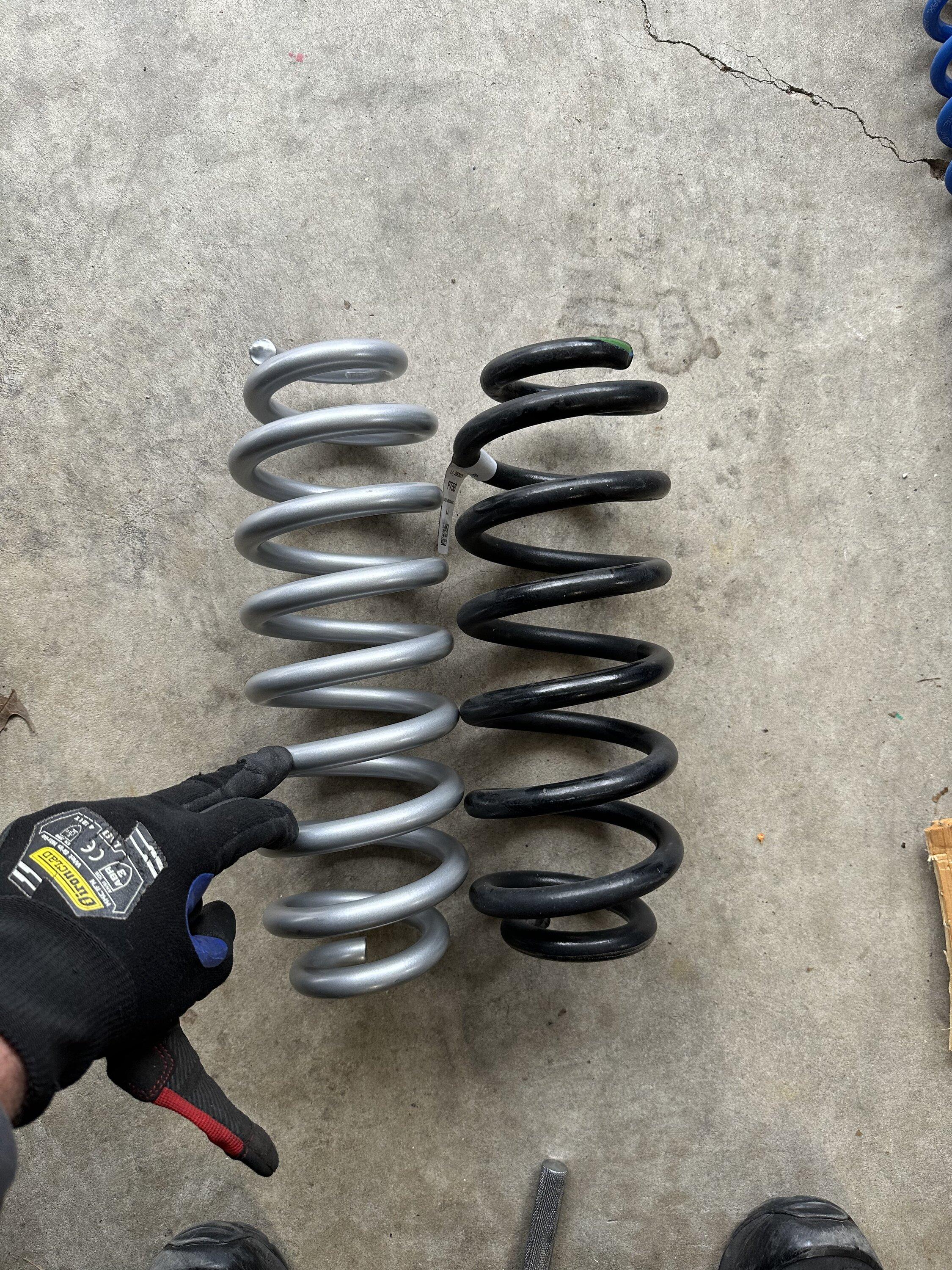

Been a while, but wanted to follow up. I finally got around to beginning work on installing the Eibach lift. I have the passenger front done. Was able to use the Harbor Freight strut compressor. Wore eye protection and was as careful as I could be. Will continue work in the morning.

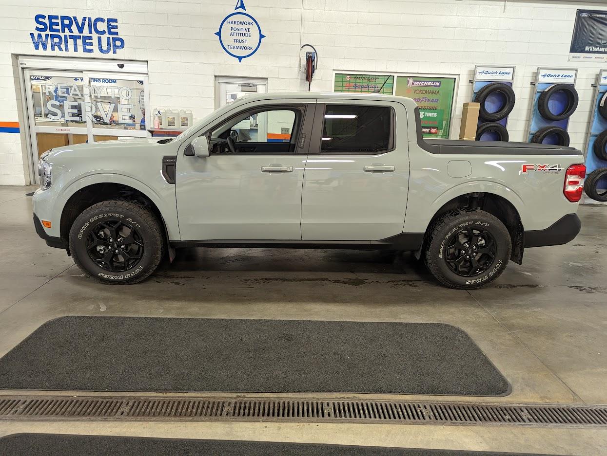

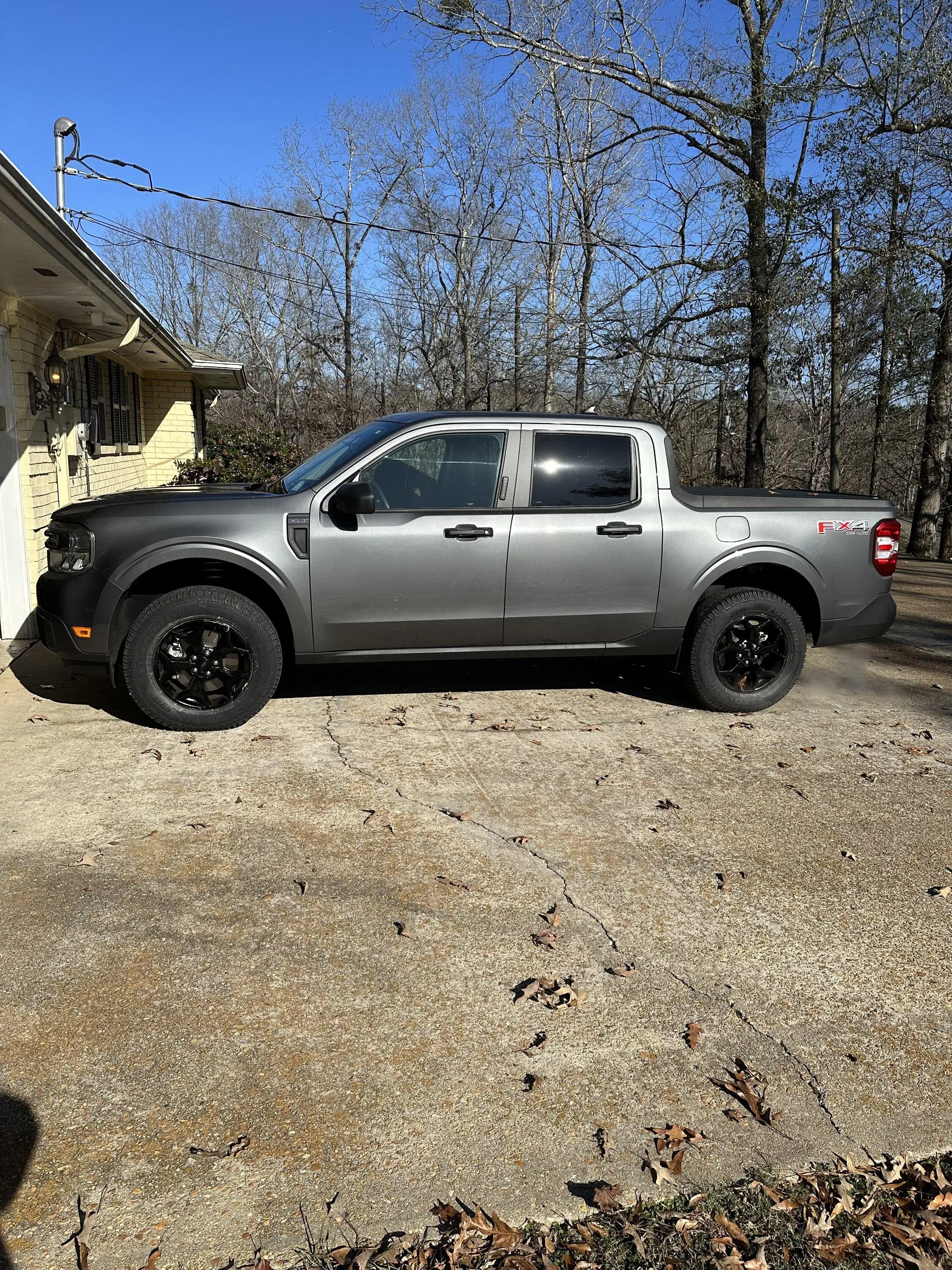

Nice here is a pic of the just under 2 inch H&R lift springs installed - Really happy with them although they did remove the "rake" - So nice to get all that low hanging plastic up off the ground.

Looks great! Do the H&R front springs provide more stiffness, like what Toner experienced with his front Eibach springs?
At first it was pretty much the same but now after 4 months or so on the stock shocks its a bit stiffer/bumpier but still is a nice ride to me- Does great clearing rocks/ruts and what not -

how does it ride vs. OEM? regards!
