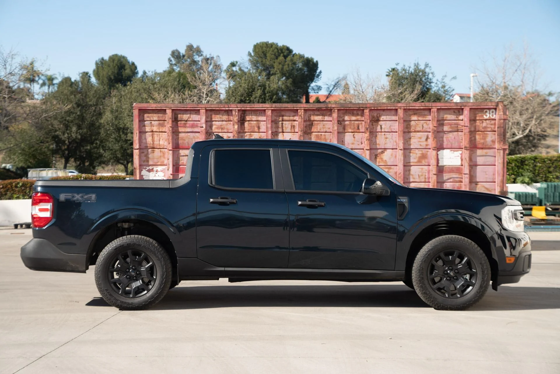

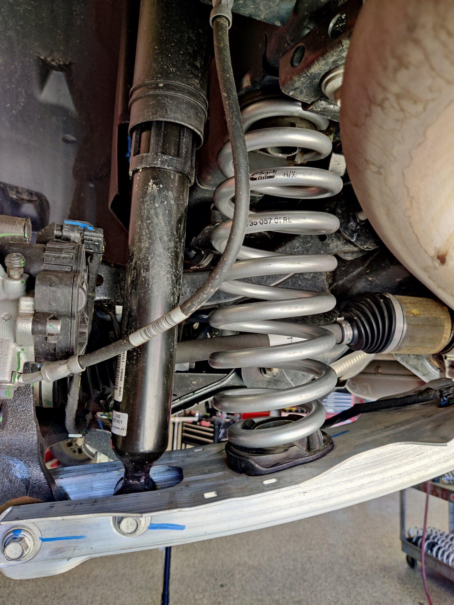

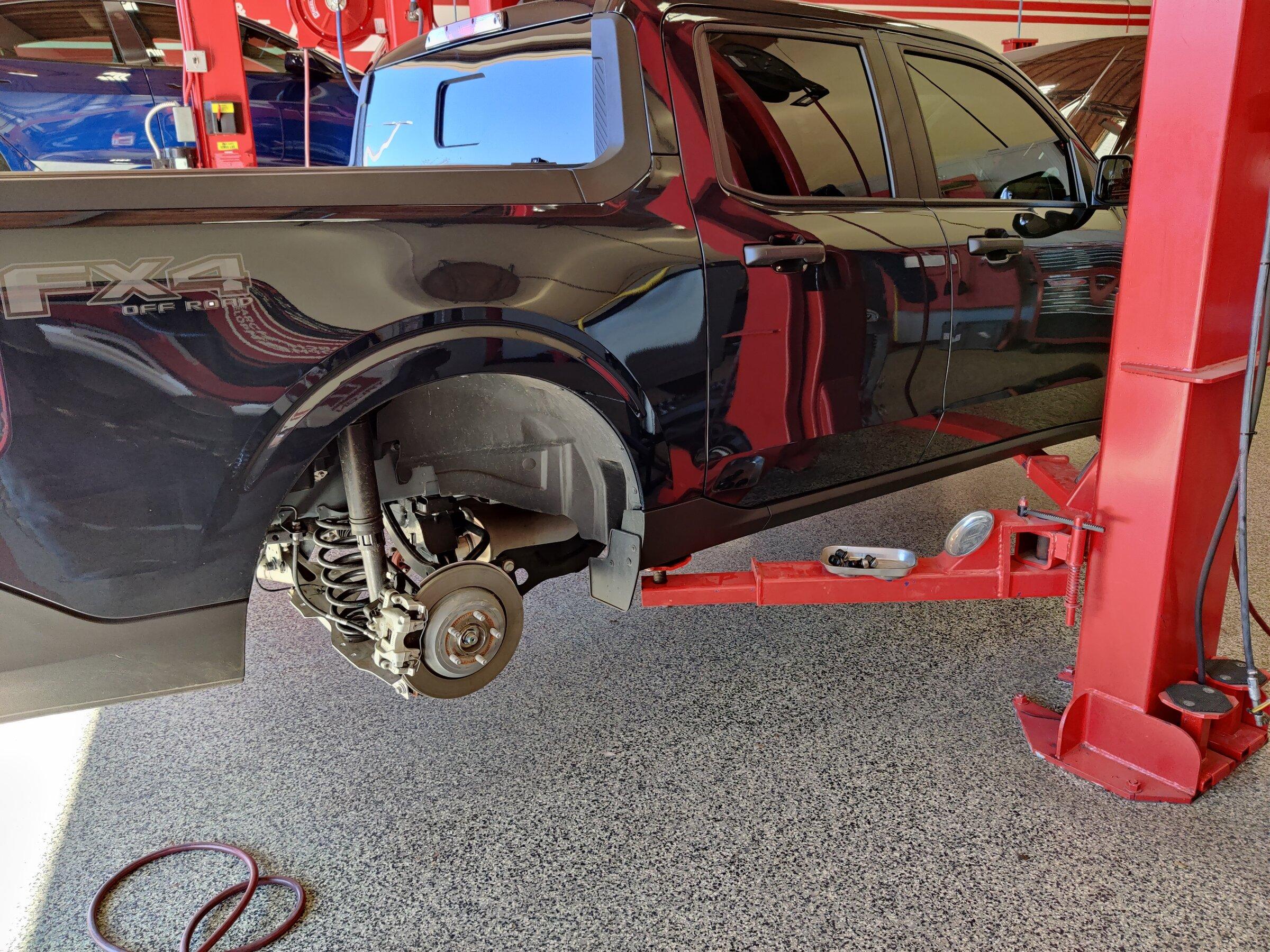

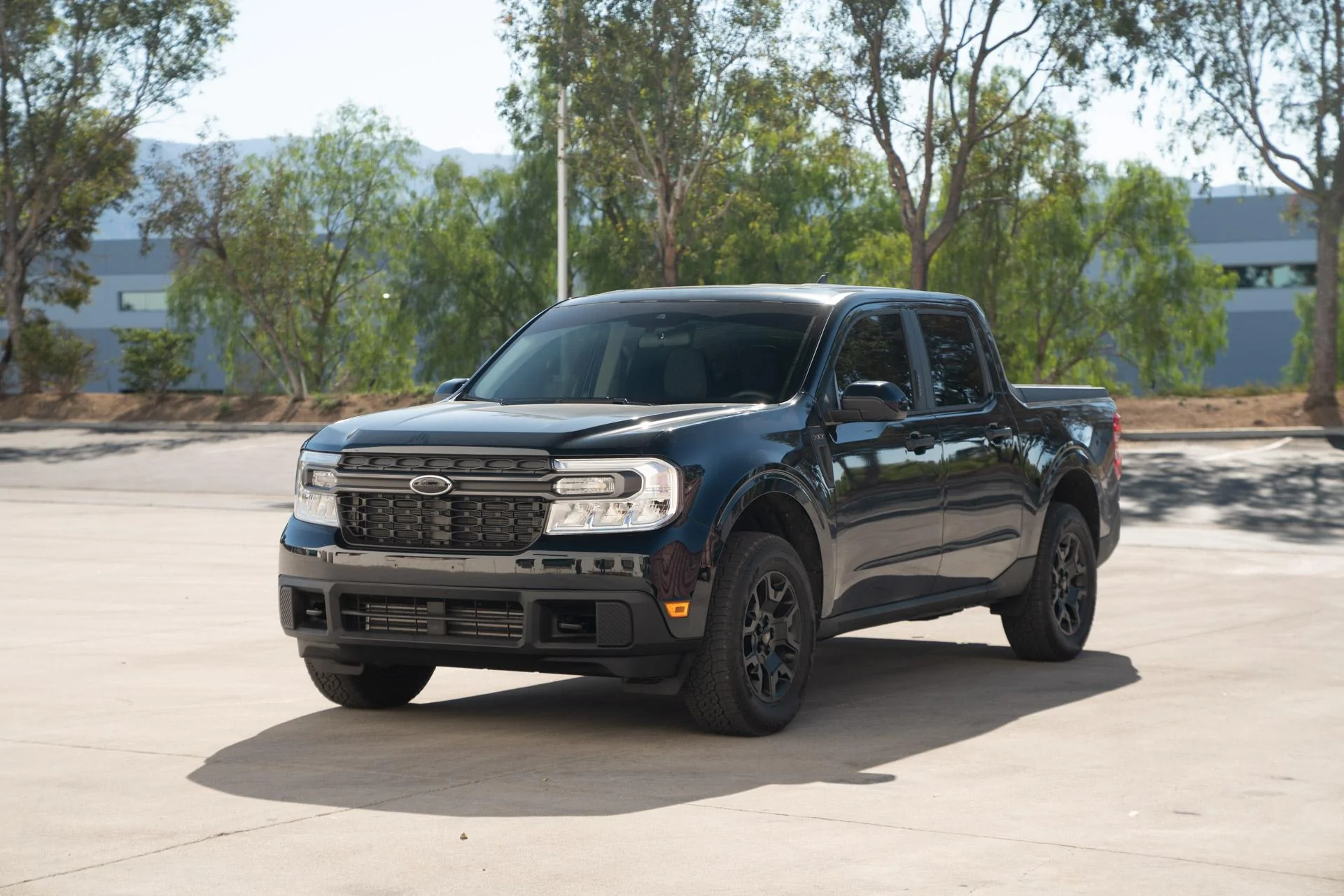

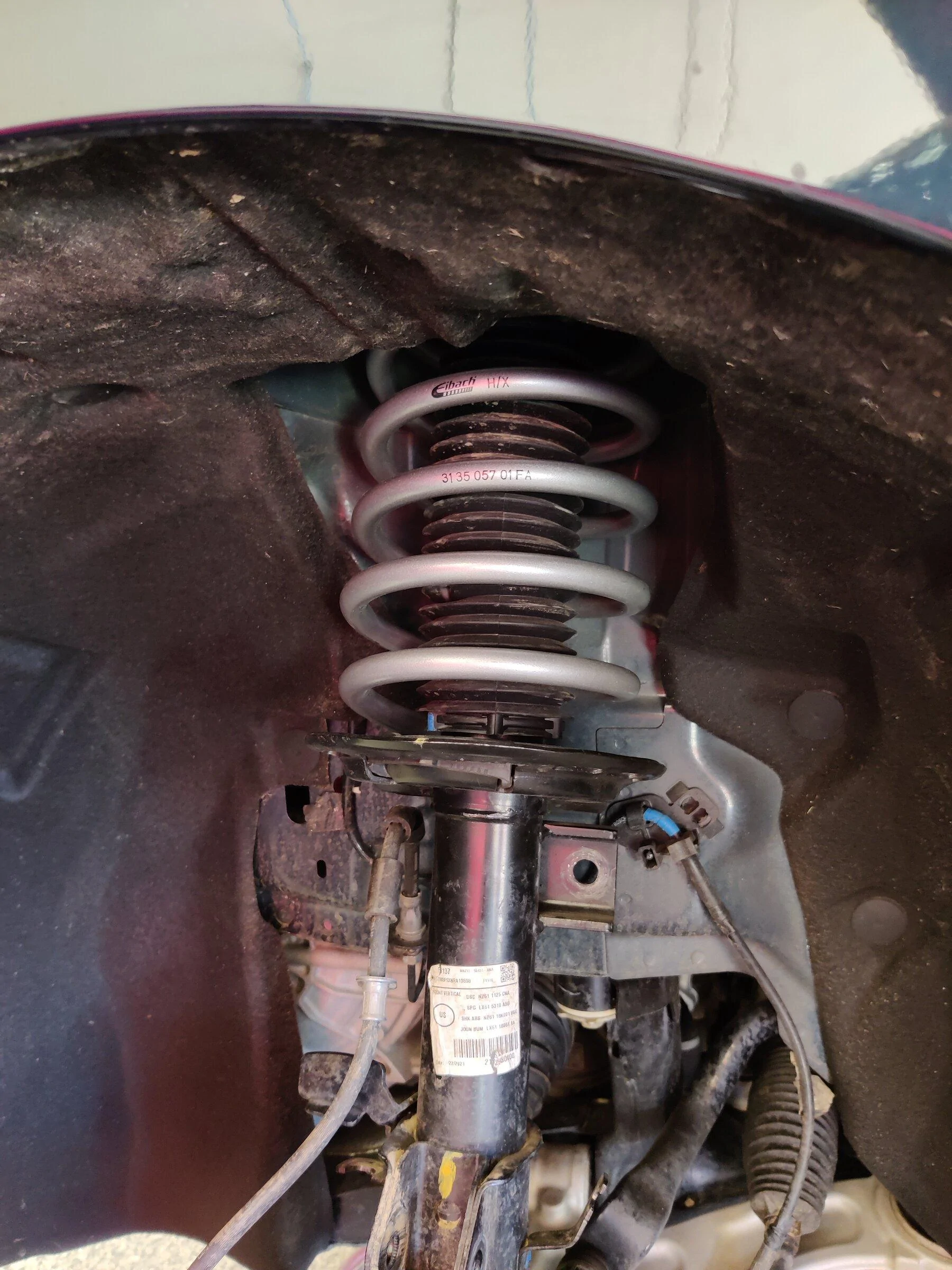

So we finally were able to test fit! The vehicle we originally took data off of was preproduction, and we knew we would have some adjusting to do. We didn't quite meet our target heights, but are making some adjustments and will re-test fit!
