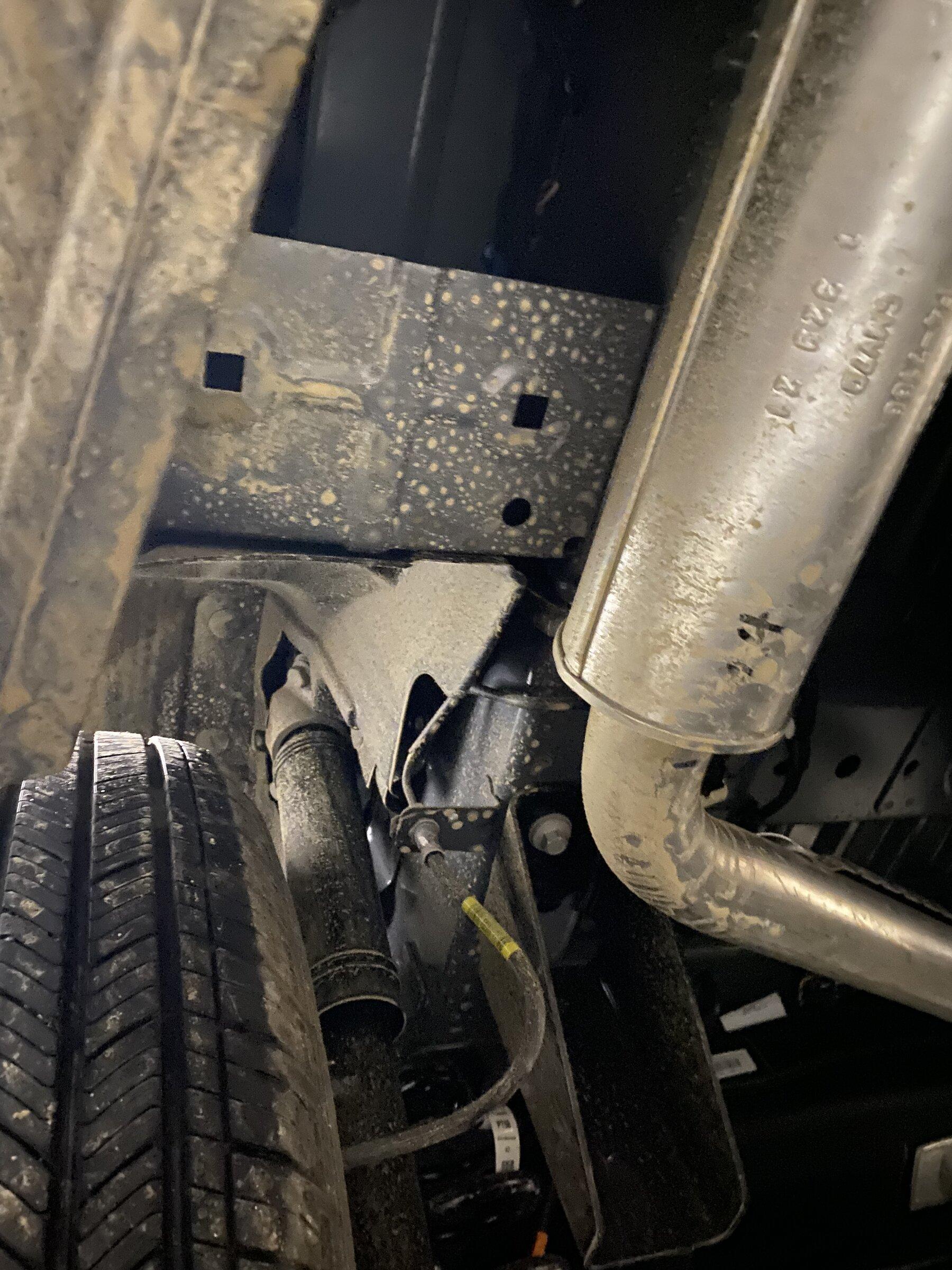

Driver side:
Ford Maverick Mud / salt / debris trap 3F2DCDCD-5446-40D4-A120-660081B8BD06

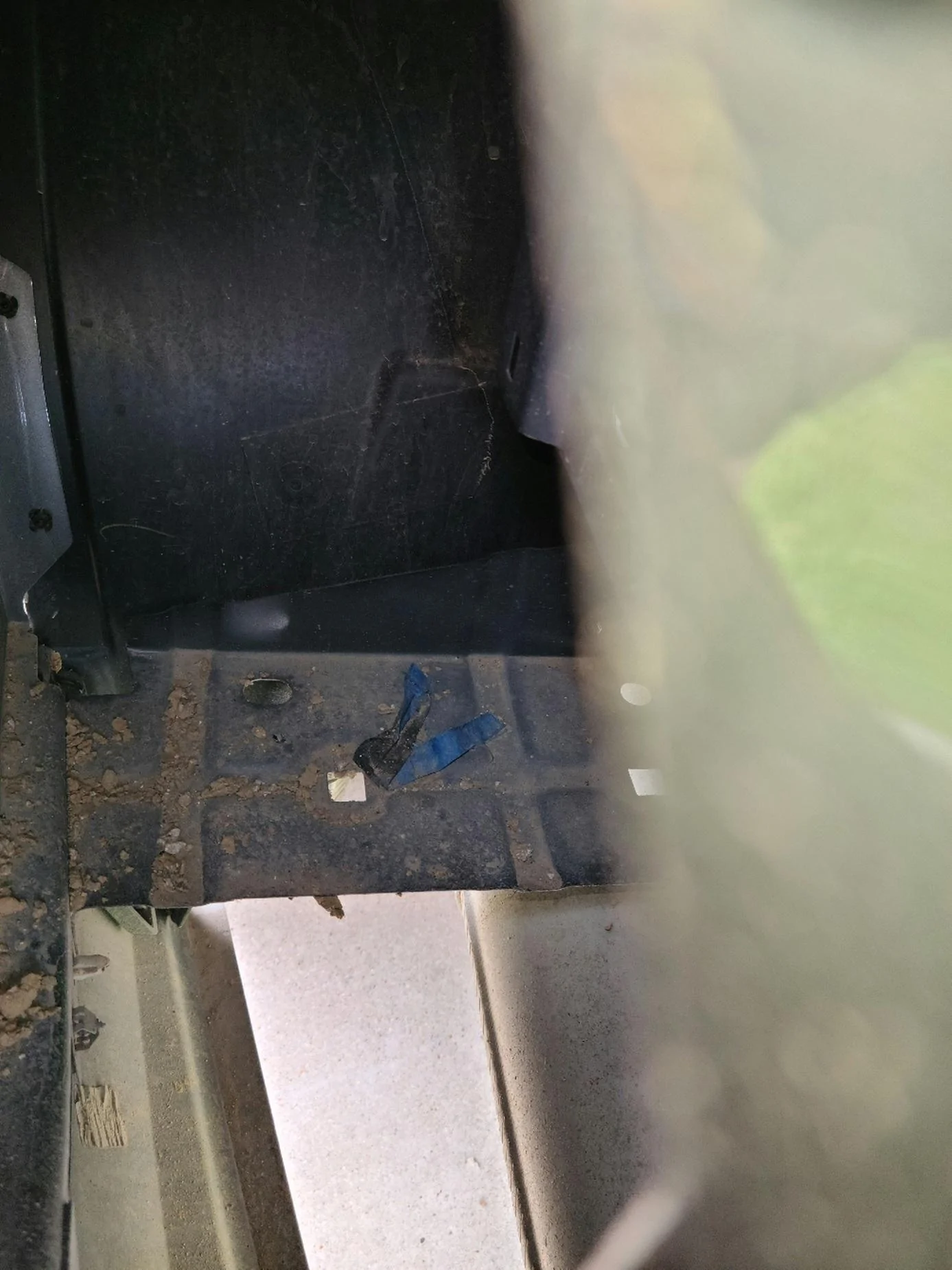

Passenger side:
Ford Maverick Mud / salt / debris trap 378D6795-7FEB-4825-B647-D755C4656722

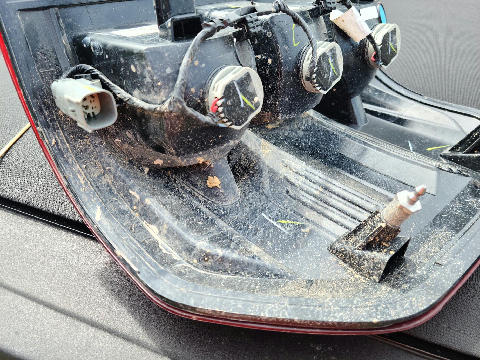

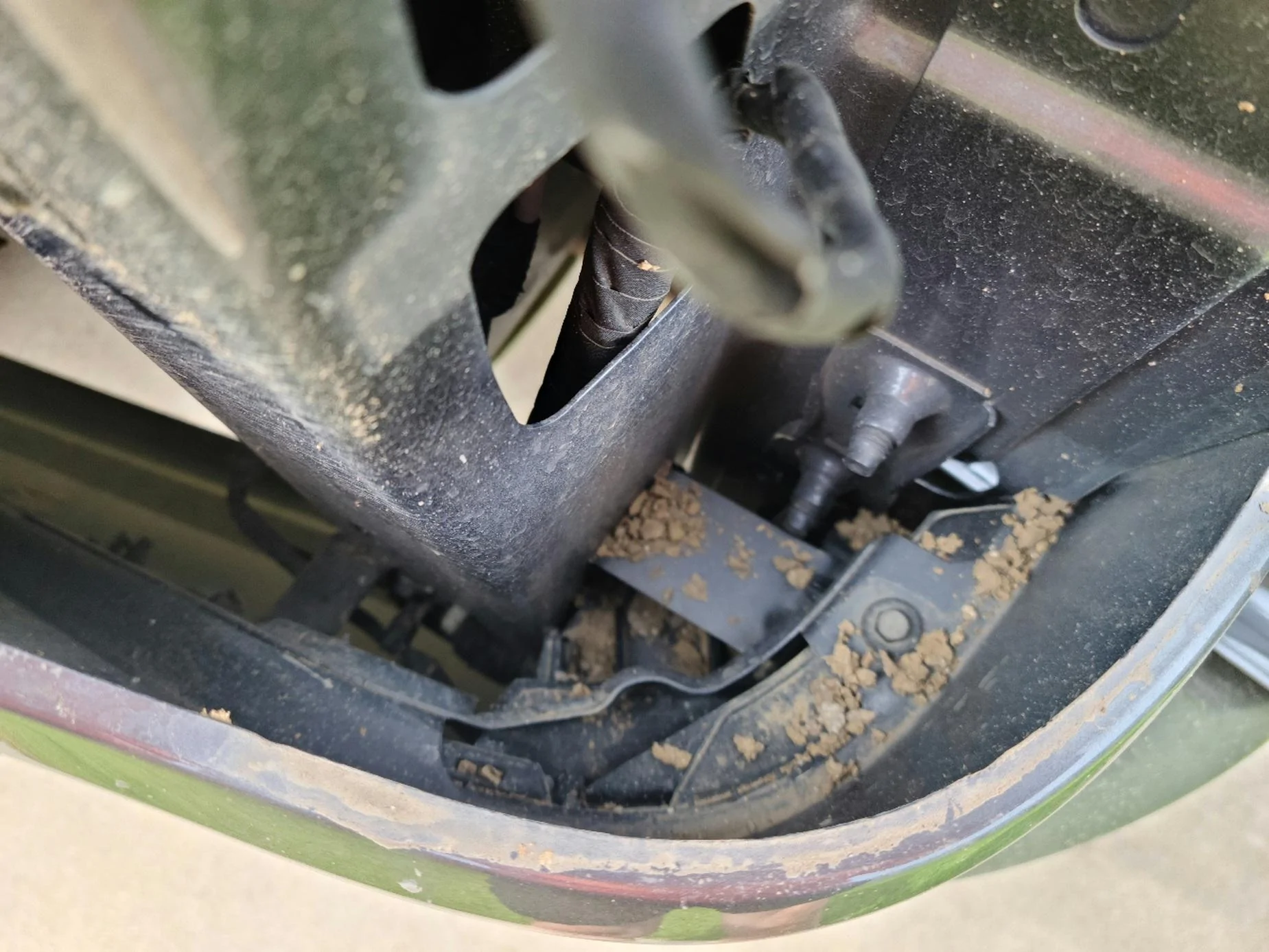

On today's wash I decided to pull the left rear taillight and have a look, here is what I found - not terrible, but would be a problem if left, especially for folks in salted roads areas:
Looking straight down in light opening
Ford Maverick Mud / salt / debris trap 20220605_103340
Looking forward to wheel well
Ford Maverick Mud / salt / debris trap 20220605_103436
Back of light assembly
Ford Maverick Mud / salt / debris trap 20220605_104632
Not a big deal some may think, but remember this gets a spray down every other weekend at least when I wash the truck.....
