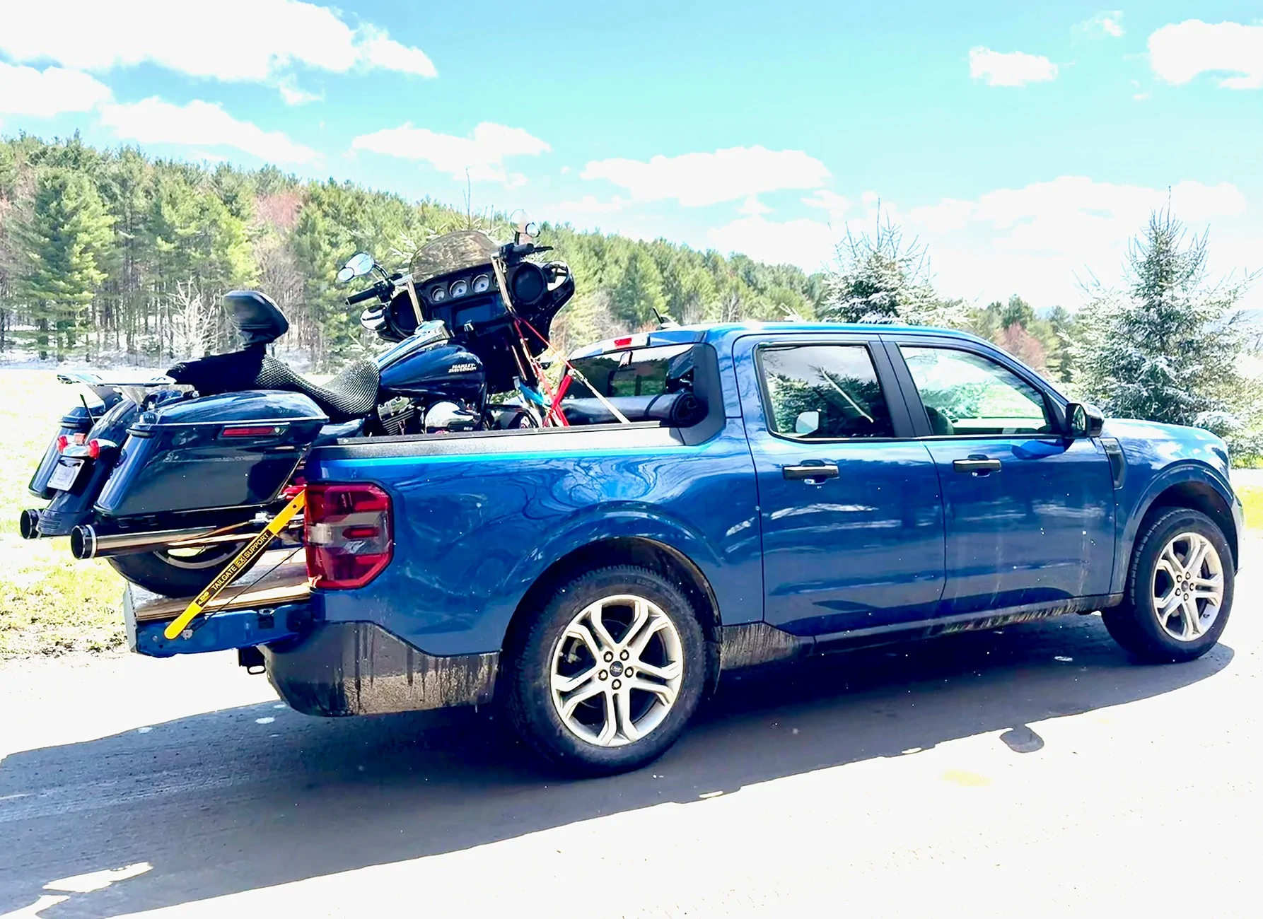

I store my Street Glide in a heated garage in Vermont each winter. I've towed 200 miles with the U-Haul 4x9 motorcycle hauler and got 23mpg in my 23 hybrid. That trailer is unnecessarily heavy but safe. This year, I bought some ramps, fitted a sheet of 3/4-inch plywood, tailgate supports, and loaded it in the back, and got 32 mpg over 200 miles. I would expect the Aluma trailer to get 25-26mpg or so based on the wind and rolling resistance.
