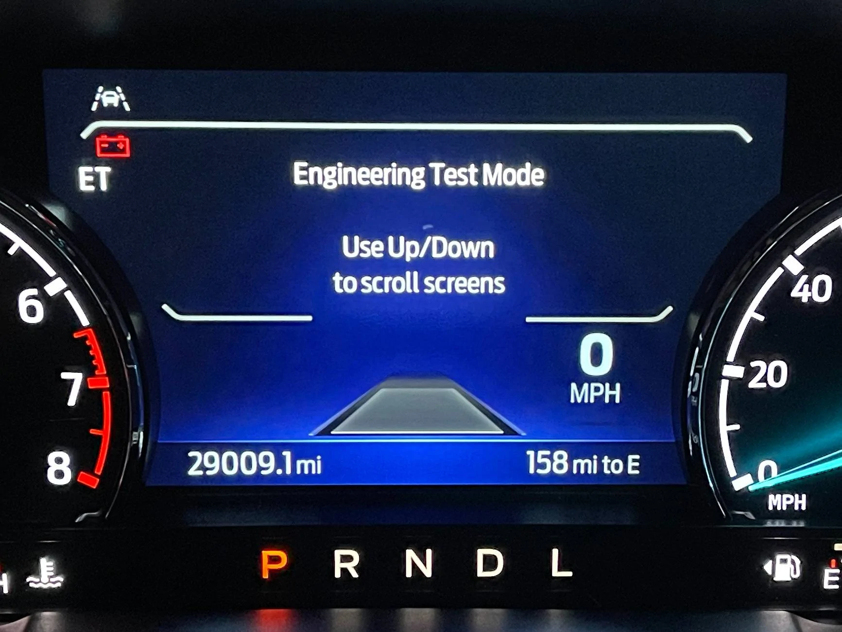

  1. Enter Engineering Test Mode
    • With the truck off, press and hold the right-side OK button on the steering wheel.
    • While holding the OK button, press and release the Start/Stop button (or turn the key to the "on" position). You do not have to start the engine.
    • Continue holding the OK button for 5-7 seconds until you have entered Engineering Test Mode.

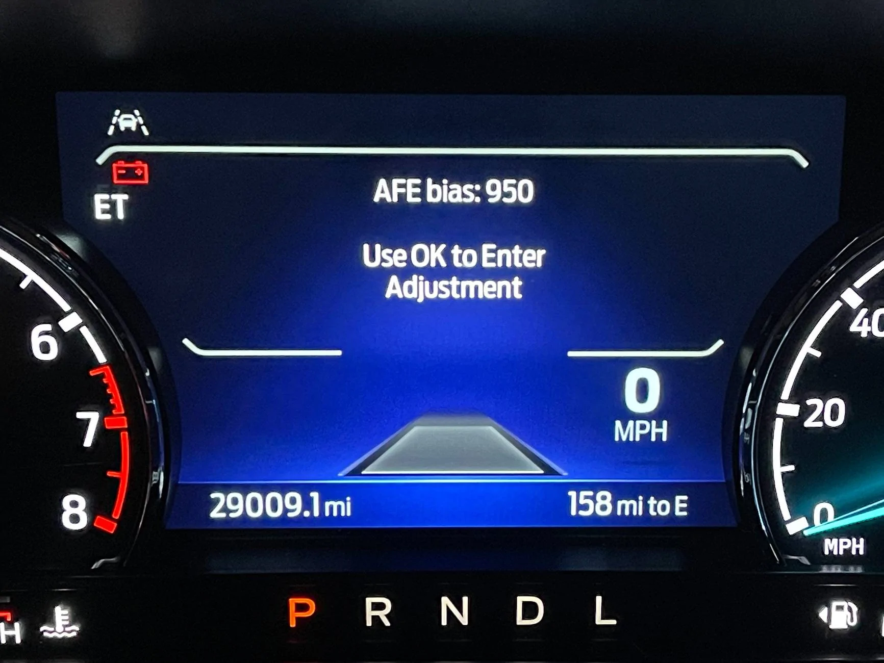

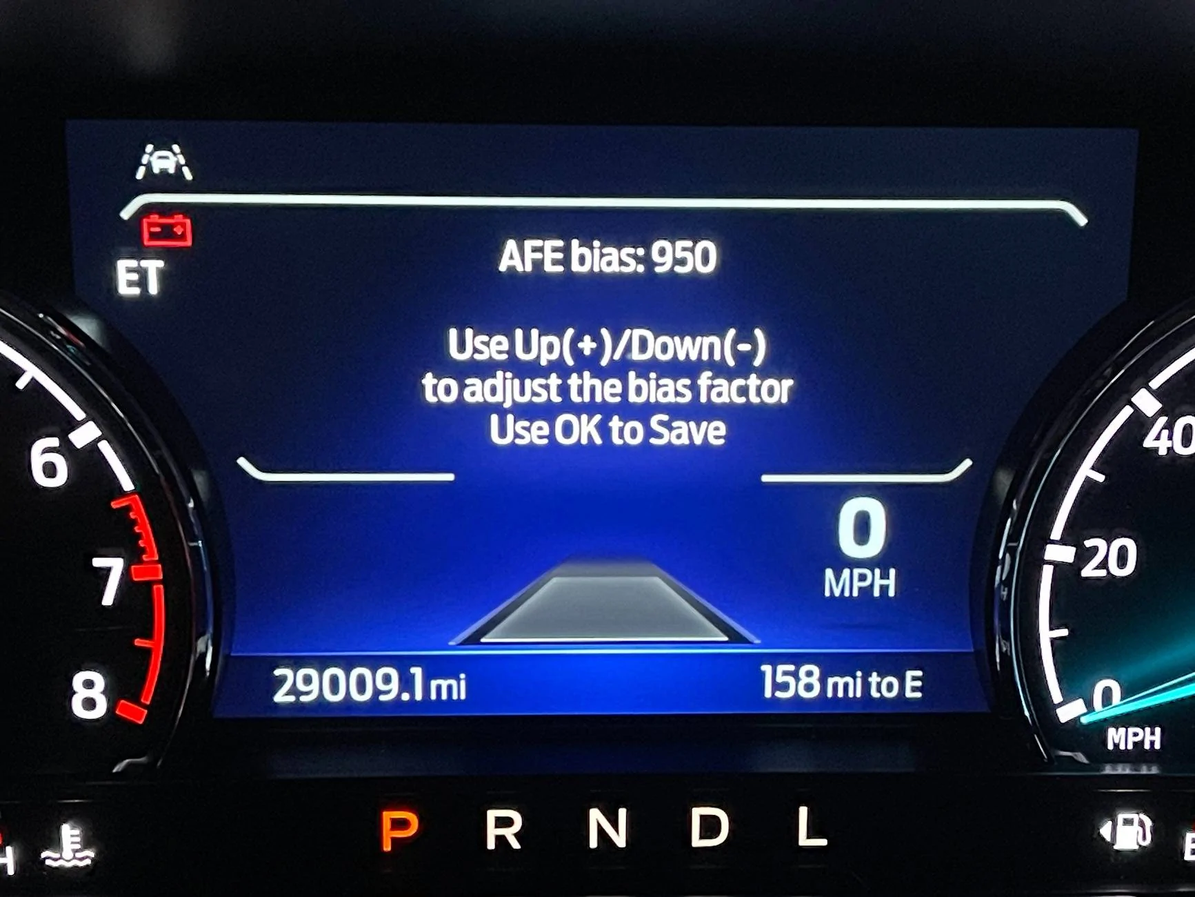

  2. Adjust the AFE Bias
    • Use the Up/Down buttons to navigate to the AFE Bias option.
    • If you haven't made adjustments yet, the default value will be 1000 (representing 100%).
    • Use the formula or Siri Shortcut below to adjust your AFE bias so your truck displays a more accurate MPG value.
    • Turn the truck off to exit Engineering Test Mode.

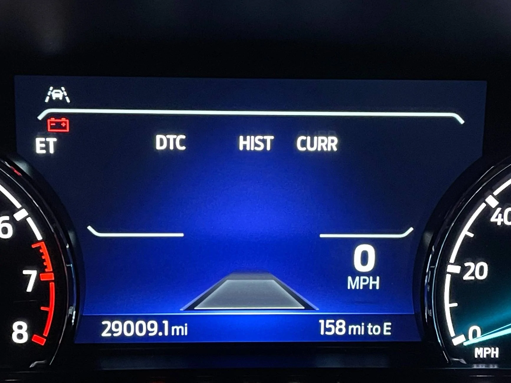

    • Engineering Test Mode also provides access to diagnostic trouble codes, RPM, coolant temperature, and other valuable data.

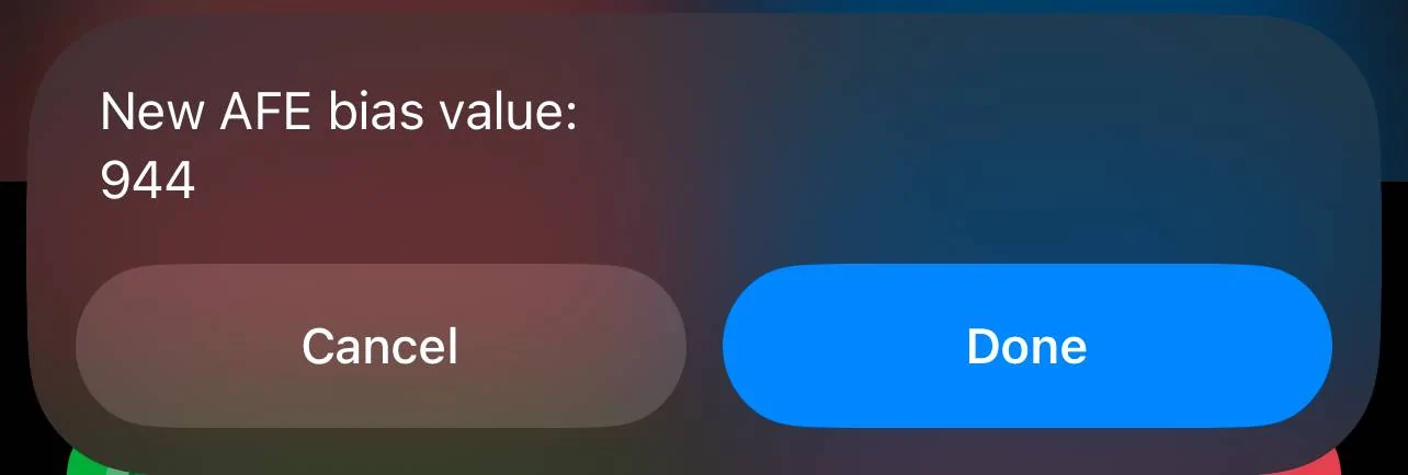

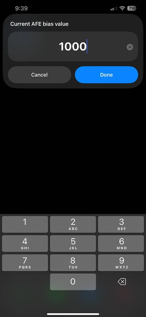

Calculation Formula
Current AFE Bias value X Calculated MPG / Displayed MPG = New AFE Bias Value
Pro Tip
I recommend repeating this process multiple times over a few fill-ups to calculate a more accurate average. When I did the math, I noticed some variance, so taking multiple readings will help you get a more precise result.

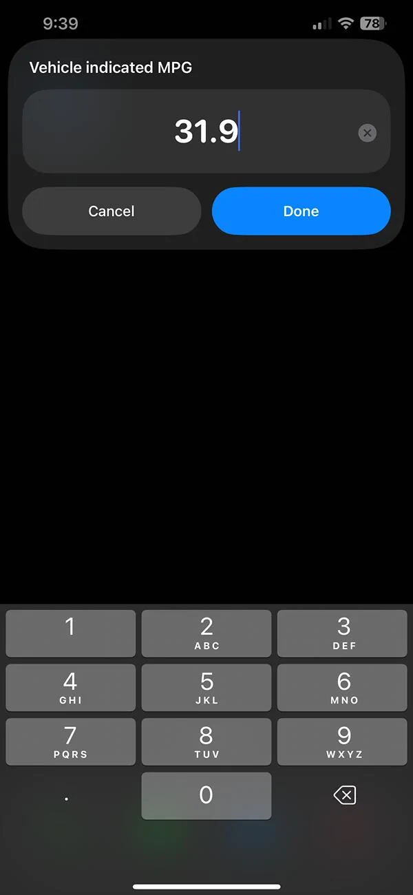

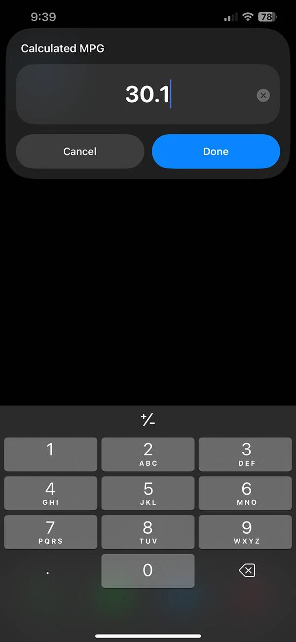

Siri Shortcuts
For iPhone users I’ve included a Siri Shortcuts link below that quickly calculates the new AFE bias value, even if the current bias differs from the default value of 1000. This shortcut makes fine-tuning your MPG quicker and easier on the go.
https://www.icloud.com/shortcuts/679729a810094cee9e26bb64b5142c66

Main Engineering Test Mode Screen
AFE Bias menu.
I have already adjusted mine from 1000 to 950 (100% to 95% readout)
Diagnostic Trouble Code Menu. There are many more menus as well.
Siri Shortcuts app I built.

After you press and hold the OK button you need to press the start button WITHOUT starting the truck. In order to do that simply keep your foot off the brake. Keep holding the OK button until "ET" lights up in the cluster.
Then, you may have to clear the Seat belt and other warning messages just like you would when getting ready to drive. At this point you are in Engineering Test mode BUT you may not be able to see the display.
To rectify that press the "Hamburger stack" button

I have a 2025 and was having a lot of trouble getting this procedure to work. The screens are very different from prior years. I think I have figured it out for 2025 model year.
Procedure to access Engineering Test mode is the same. Hold OK and press start- keep holding OK until a grey ET shows up on the dash. At this point I waited for a while for the alerts to cycle through. After I cleared the seat belt warning, I still had ET on the dash but had a blank screen. When I toggled up/down with the button, I saw the screen like, acknowledge that I changed something but I still couldn't see anything.
Next, I hit the hamburger stack on the right of the steering wheel- The three stacked lines. That was the needed input. Engineering test screens became visible and I was able to edit my afe bias down to 950 (all of my actual mileages have been 5% off).
tldr: hold ok to enter ET mode. if you can't see the info screens, hit the three stacked lines button.
