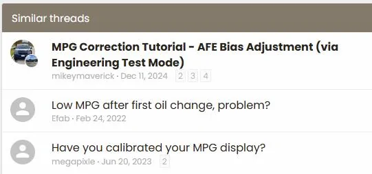

These shown below your thread will now give you more info.
