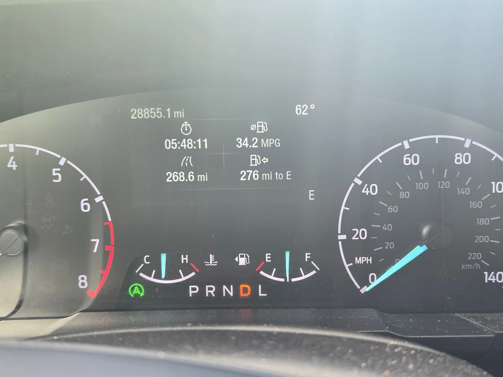

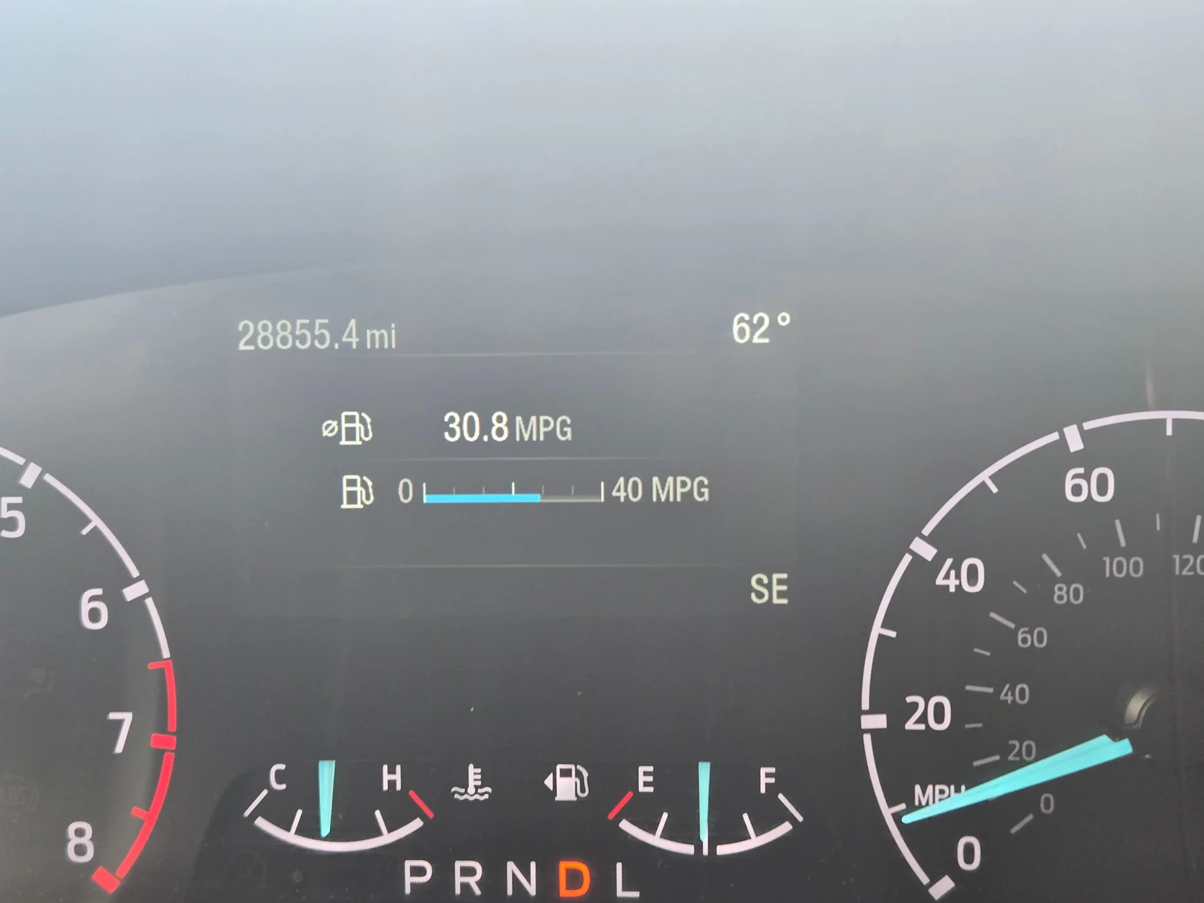

I've been getting very good mileage on my 2022 Ecoboost XLT AWD with towing package. I have almost 29,000. No longer interstate trips, mostly rural roads and using AC. 30.8 MPG since day one!!!
