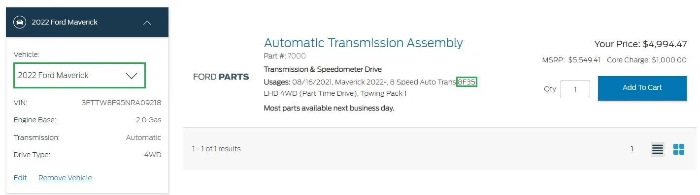

In a direct email from them when I asked if they were concerned about making 373wtq on this chassis.
Even the Ford parts site says that all Ecoboost versions of the Maverick to include the 4K tow package models are using the 8F35. Seems like hearsay to me......

I don't have my Maverick yet. If you guys want to make sure, look at the trans for some part numbers and see what cross references. I don't take their word for gospel, but I have a hard time believing a trans meant for a max of 258 lbft is holding up to over 400lbft at the crank. I don't know for a fact, I'm just forwarding info I have received. Like I said, I'll do more research whe I actually have my truck.
