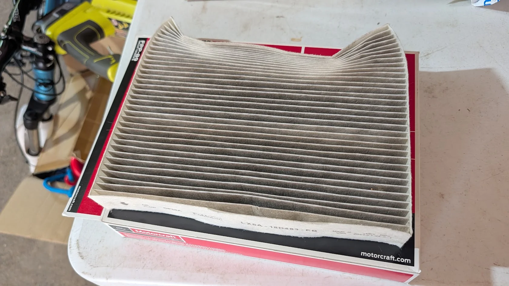

Damage?
Eh - probably just dirty. But a bear to clean anyway.
Just like your home system that people fail to replace filters on and it freezes up the coil, usually sensors are going to cause it to stop operating eventually before damage is done.
But home systems may be old enough that stress does kill a component during that time.
You probably felt no cold air either because the coil was frozen up due to lack of air flow - or the sensors prevented compressor from actually working due to airflow causing enough issue.

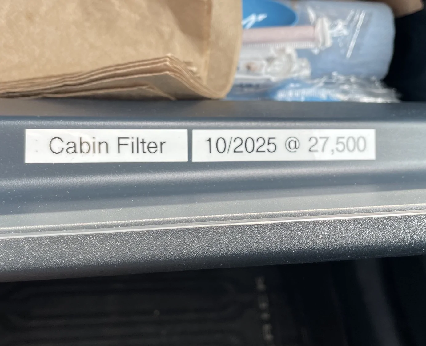

Considering checking the filter is on the list of things to do on a regular basis - if the dealership records don't show it being done - maybe you could nab them for failing to when they were supposed to. Or you'll be nabbed for not having records it was done.
