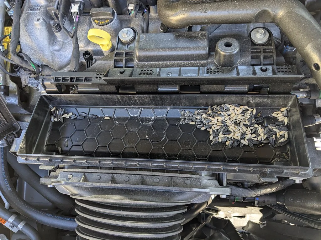

Check your cabin filter behind glove box. I have found nests there three times. Also corn stored in my hybrids air box
I took your advice and checked. Clean so far.

I think the below suggestion for hardware cloth is the best, but - you would then have to check it regularly to assure it wasn't clogged with debris.
A piece of hardware cloth (1/4" steel mesh) over/in the inlet will prevent ingress.
The rest of the under hood area is open season.
I find propping my hood open works, as they like places to hide, not the open air.
You can get battery zap traps that are baited with peanut butter at a hardware store.

So I cut a piece of 1/4" hardware cloth (weird name for what it is) and just let the filter hold it in place against the opening. Good idea but not sure it'll work since they say a mouse can get its body through any hole its head can go through. We'll see. I'll keep an eye on it.

Certainly shouldn't obstruct airflow in any way.

If someone does try to 3D print a barrier, don't use PLA. PLA is made of corn starch and mice love to gnaw on it.
Is that 1/4" ? Looks larger. Like 1/2"...
Anyway, a mouse gets into small areas because it can flatten itself down and scooch through a 1/4" gap. It can't fit through a 1/4" square.

There is always 1/8". It's harder to find as most want the more ridged welded version but woven is more flexible (like cloth).
