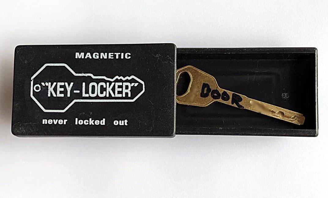

I haven't had the truck lock me out yet. But if it ever happens, I have a low tech solution.
When I had the local mobile locksmith cut some spare keys for me (one fob key + one fob-less [transponder] key), she used a bare metal test key before cutting the two actual keys for me. The test key insured that her machine could correctly cut the keys, before cutting the two blanks for me.
She gave me the test key at no charge. I put it in a magnetic key holder and hid it on the truck. The metal key won't start the truck, but it will unlock the door.

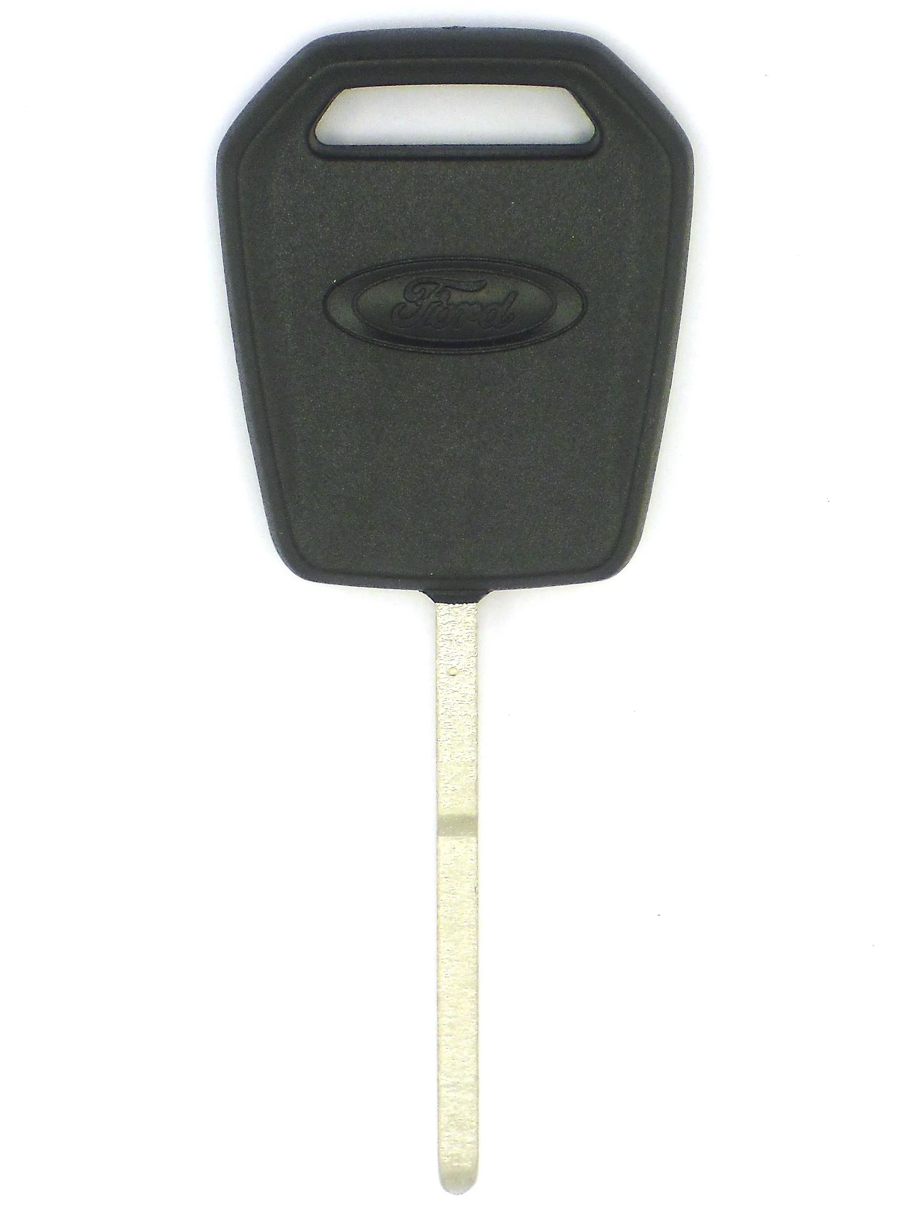

There is no good waterproof place to hide a key since you need it to open the Tail Gate or Engine hood.
No need for a waterproof location if you either use the "metal key" method I posted above, or use a waterproof transponder key like this:
Ford Maverick Maverick XL spontaneously locking doors. 6739
You can order a fobless transponder key from the links posted in Redneck Garage's thread on keys.
Most locksmiths can cut the metal part for you. You can program the transponder chip yourself, as long as you have the two original keys that came with the truck.
