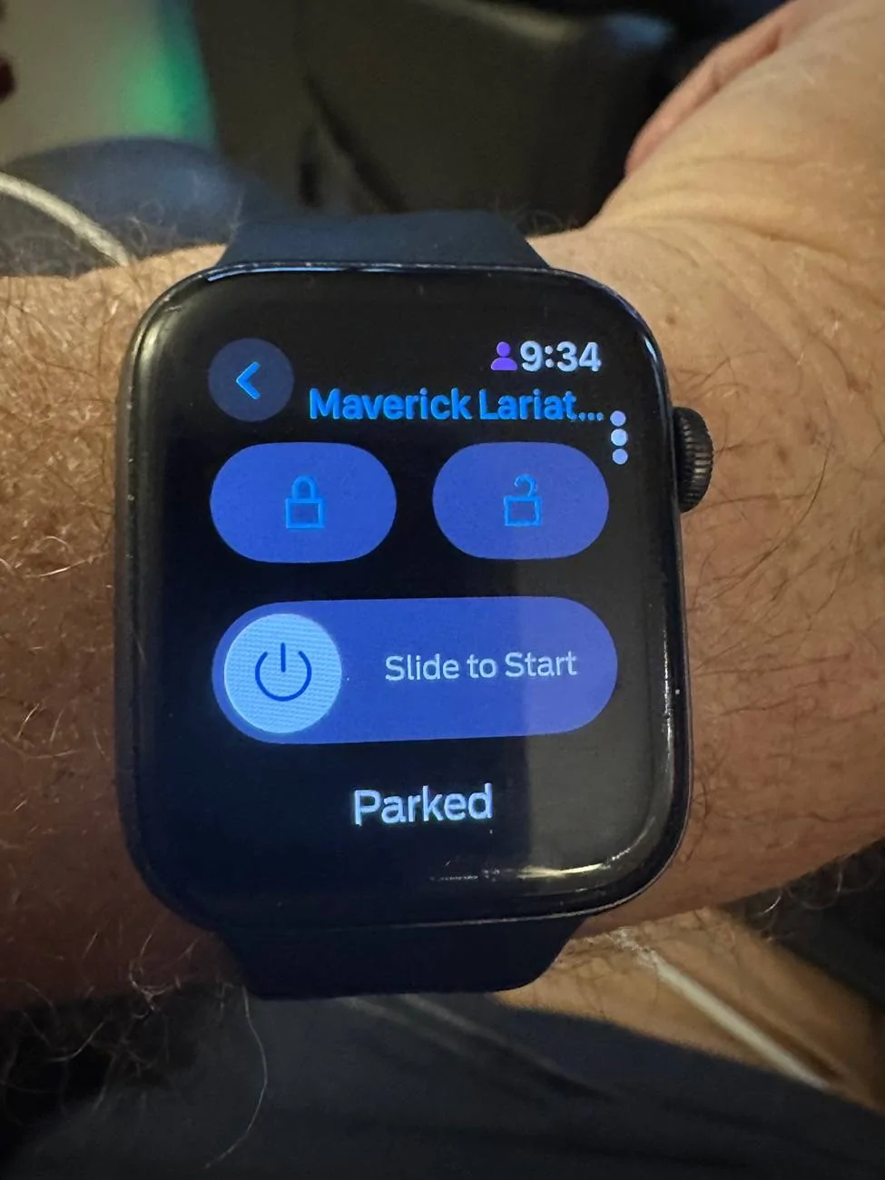

I occasionally check the Ford App when I can’t rember if I locked my truck. I wish it would indicate if the Maverick is locked or not. Not a huge deal, just sayin’.

I agree seeing the status at a glance would be nice and how it should be configured…

I also agree that it'd be nice to always be able to look at the app and instantly see if the truck is locked, but if the truck telematics are enabled enough to verify lock status, they are also able to lock the truck via the app...
Click the "lock" button in the app, and it will lock (or re-lock) the truck, and for a brief moment, the app does announce "Vehicle Locked." I just tried this with a locked truck, and the truck didn't honk, but I heard the door locks engage. So, I would say that with just one button-press in the app, you are covered.
