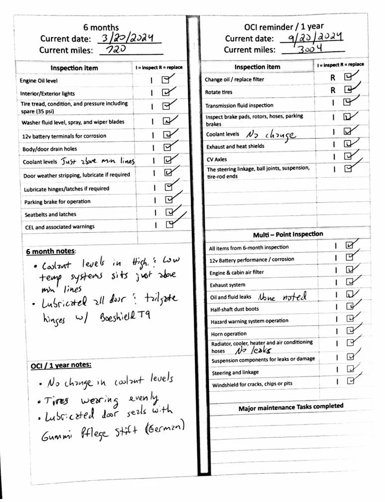

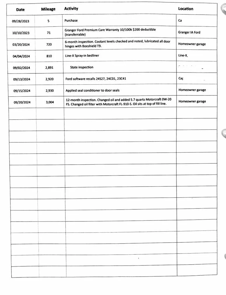

PDF and .docx uploaded below, just some sample pages.
I keep it in a 3-ring binder in plastic sleeves, along with all my records (oil purchases, warranty fixes, window sticker, etc).
I recommend anyone using this to go through the owners manual and determine if everything is accounted for, so you can understand what Ford has laid out as far as systematic checks they want done (for warranty purposes).
This is how I designed it to be used:
Ford Maverick Maverick Maintenance Logbook maint-1
Ford Maverick Maverick Maintenance Logbook maint-2
