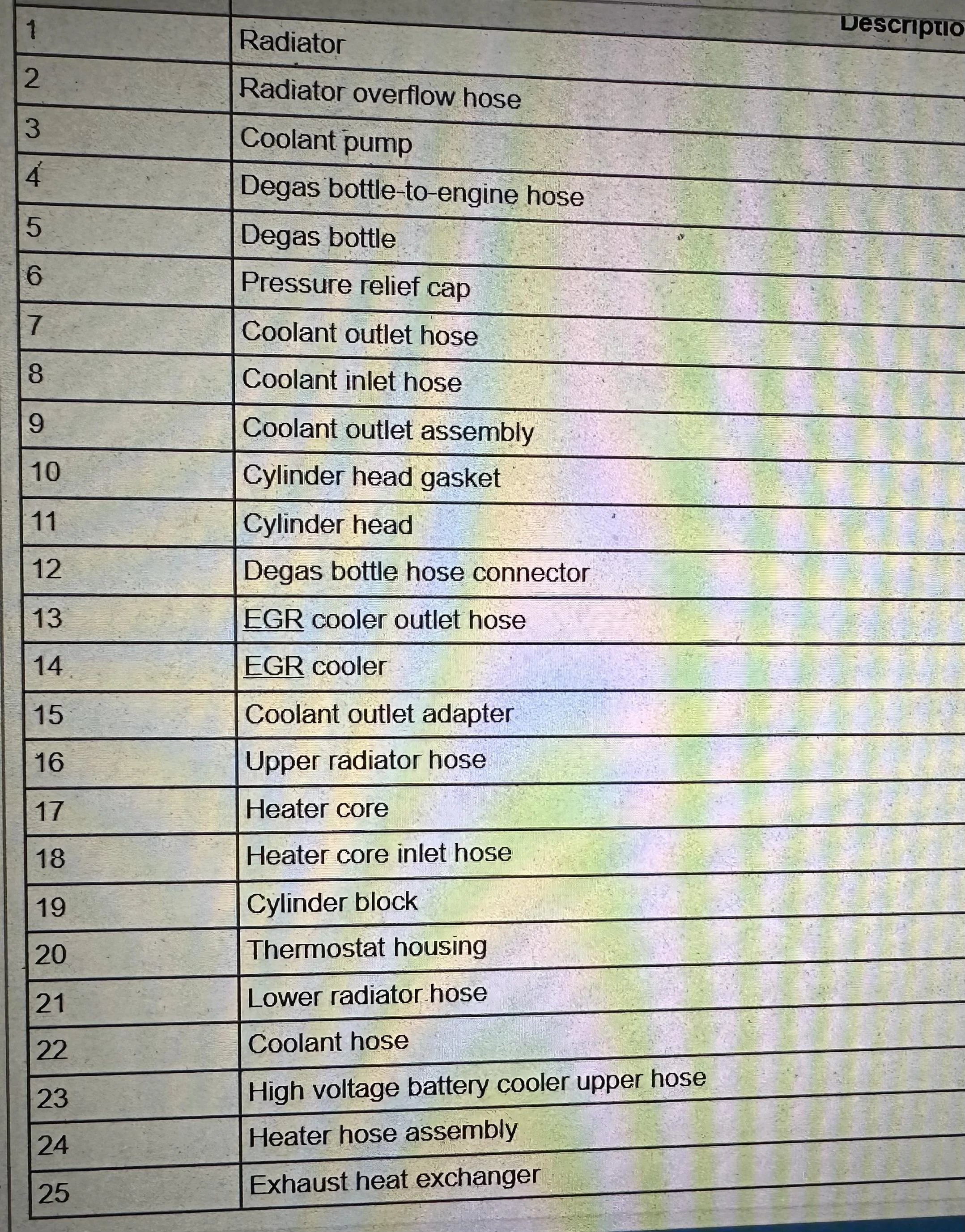

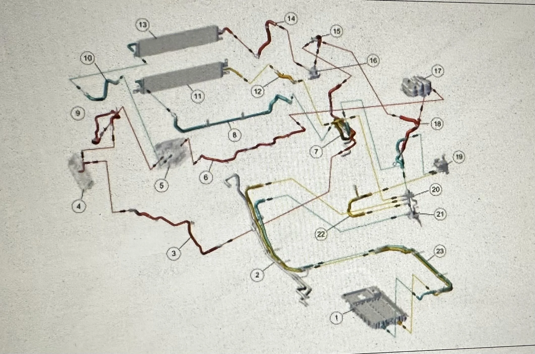

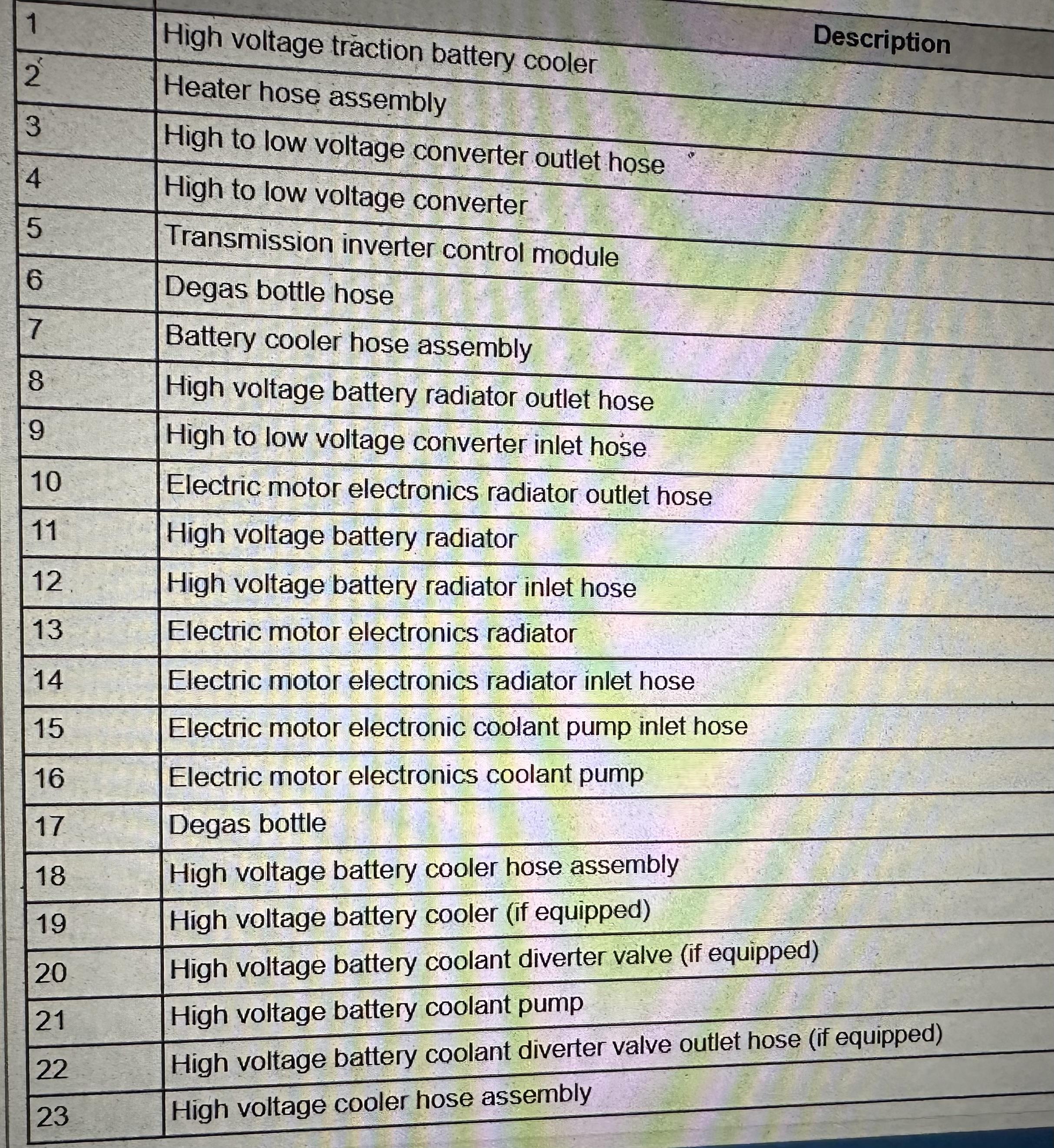

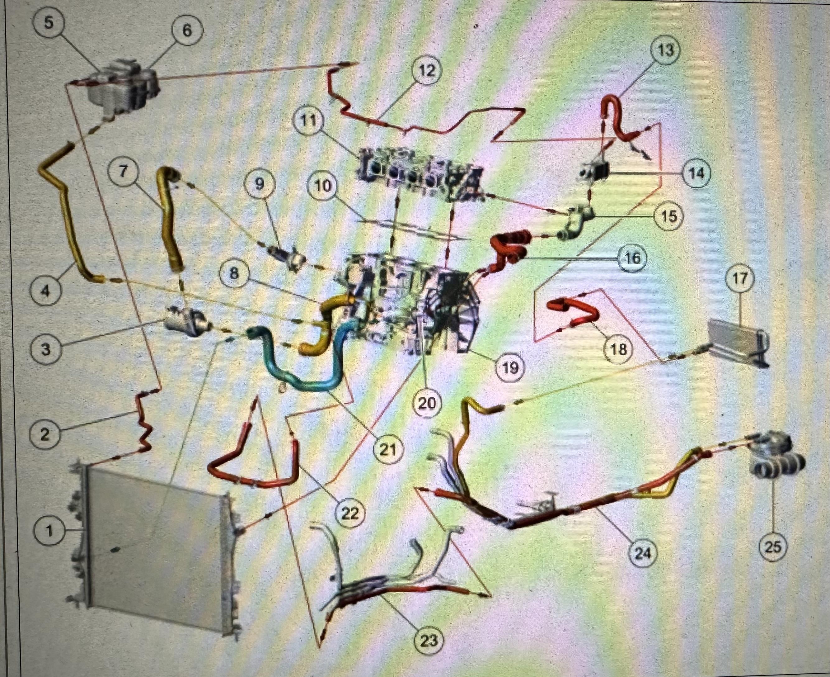

I tracked down diagrams for both of the hybrid cooling systems. The pictures are from a friend who works at a local ford dealership. He provided me with diagrams for both systems as well as a general description of the components. The comment that got me thinking was that there is at times the possibility of cross flow between the two systems for heat management/mitigation. The Ford hybrid drivetrain is relatively new to me. I have a lot of knowledge of Fords diesels, most recently the 6.7 powerstroke. It also has two cooling systems, and it seems there is a lot in common. Both are independent of each other. Separate heat exchangers, pumps and reservoirs. They are not interconnected and operate at different design temperatures to accomplish different tasks. The primary ultimately handles engine cooling and cabin temperature. The secondary handles other component temperature management.
In my first Maverick hybrid I had a failure of the exhaust heat exchanger. It was covered under warranty. While I waited months for a replacement I was under the assumption that its purpose was to warm the battery in cold weather. That is NOT the case. The exhaust heat exchanger is in the primary cooling system and is responsible for keeping and getting as much heat as possible into the primary system in cold weather to keep the engine temperature warm and stable, and keep heat in the cabin. All heat in the secondary system comes from electrical components in that system. The secondary system (battery mostly) can also be cooled via a heat exchanger that interfaces with the HVAC system in hot weather. There are two coolant pumps in the secondary system, and those pumps can independently regulate the temperature of motor electronics and battery temperature with out the use of valves. The only valve in the system is on the battery coolant loop that brings the coolant cooler (HVAC) online.
I’m sure I might have some minor errors in here, but I think for the most part this is a good overview, feel free to add other sources to help increase all of our knowledge.

Yes.
But
Look at hose 23 and hose 24
It's not really clear but looks like exhaust heat CAN help warm the battery. But I'm gonna say from experience it does not at least at 32°F and above.

Saw mention of Motor Cooling in the DC/DC module's operation:
The DCDC is liquid cooled by the electric motor cooling system circuit. The electric motor cooling circuit uses an electric motor diverter valve that acts as a system thermostat, allowing the coolant to flow within the motor circuit while the motor warms. As the coolant warms, the diverter valve slowly opens to allow coolant flow to the radiator.
