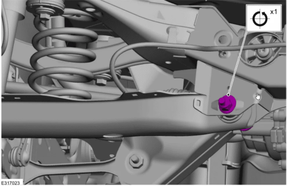

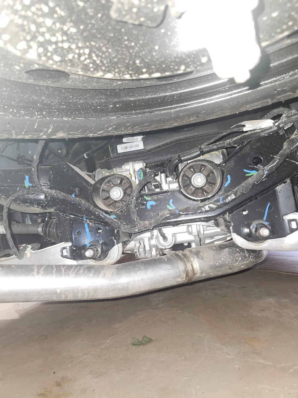

Here is a possible cheaper option for getting rear toe adjustment vs going with aftermarket toe links. I'll be trying these out.
*POST EDIT*- Just noticed that the Maverick already has Cam Bolts installed from the factory, which should allow for the rear Toe to be adjusted. These are not needed

The toe adjustment procedures are pretty standard stuff. The Spec for the rear tow cam bolt is 111 lb. ft. (150Nm)
This was new to me though regarding the rear cam bolt:
  1. NOTE: If equipped with Lane Departure Warning (LDW) System, camera alignment is required for the lane keeping alert and lane keeping aid to function correctly.
    Connect the scan tool and perform the IPMA camera alignment procedure. Follow the scan tool directions.

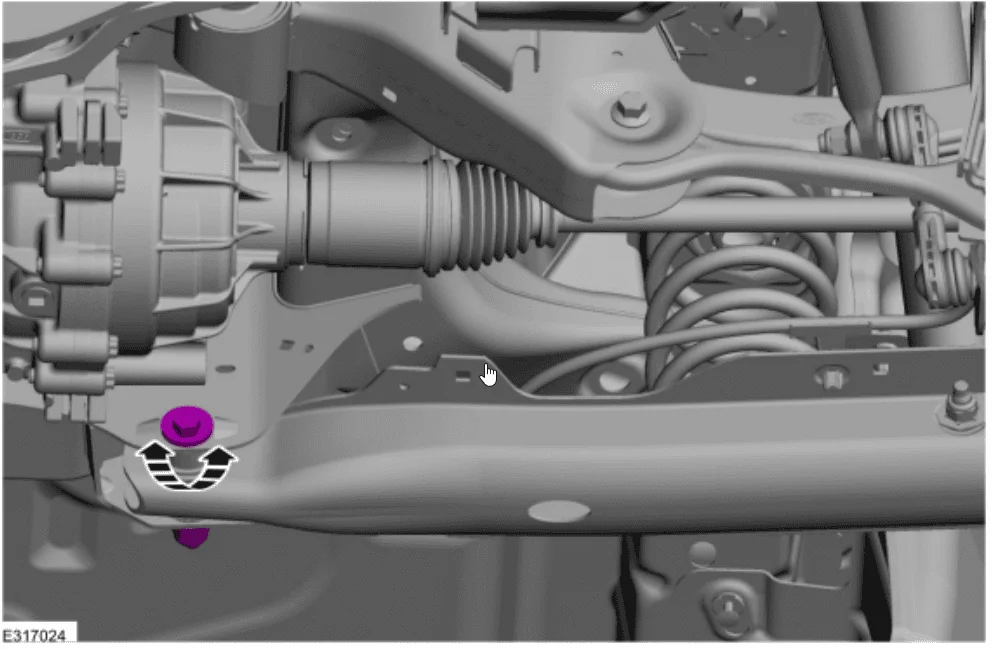

I definitely wasn't expecting to see Cam Bolts when I looked.
Diagram for the factory Cam bolts to set rear Toe:
Ford Maverick Maverick Lobo Autocross Testing & Handling Upgrades toe link 2
Ford Maverick Maverick Lobo Autocross Testing & Handling Upgrades toe link 1

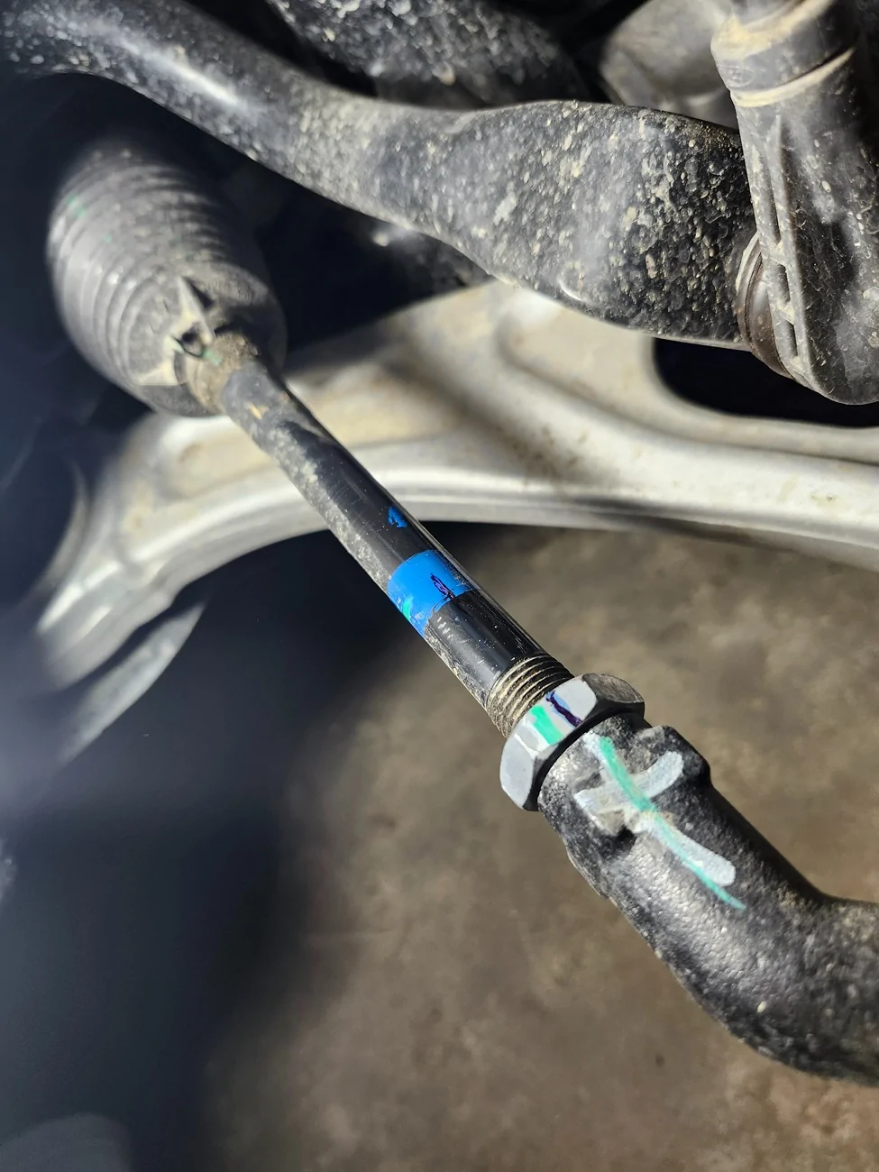

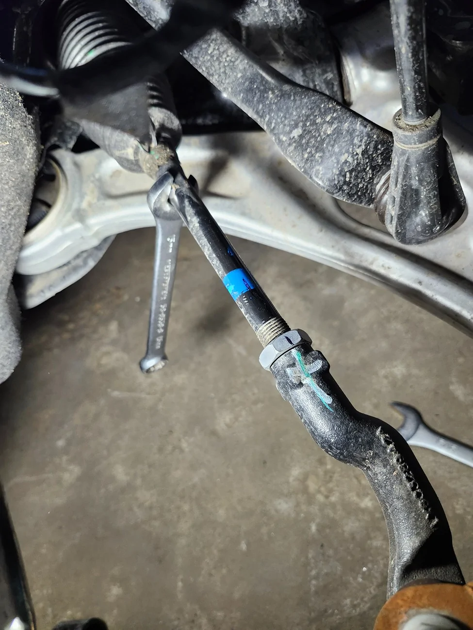

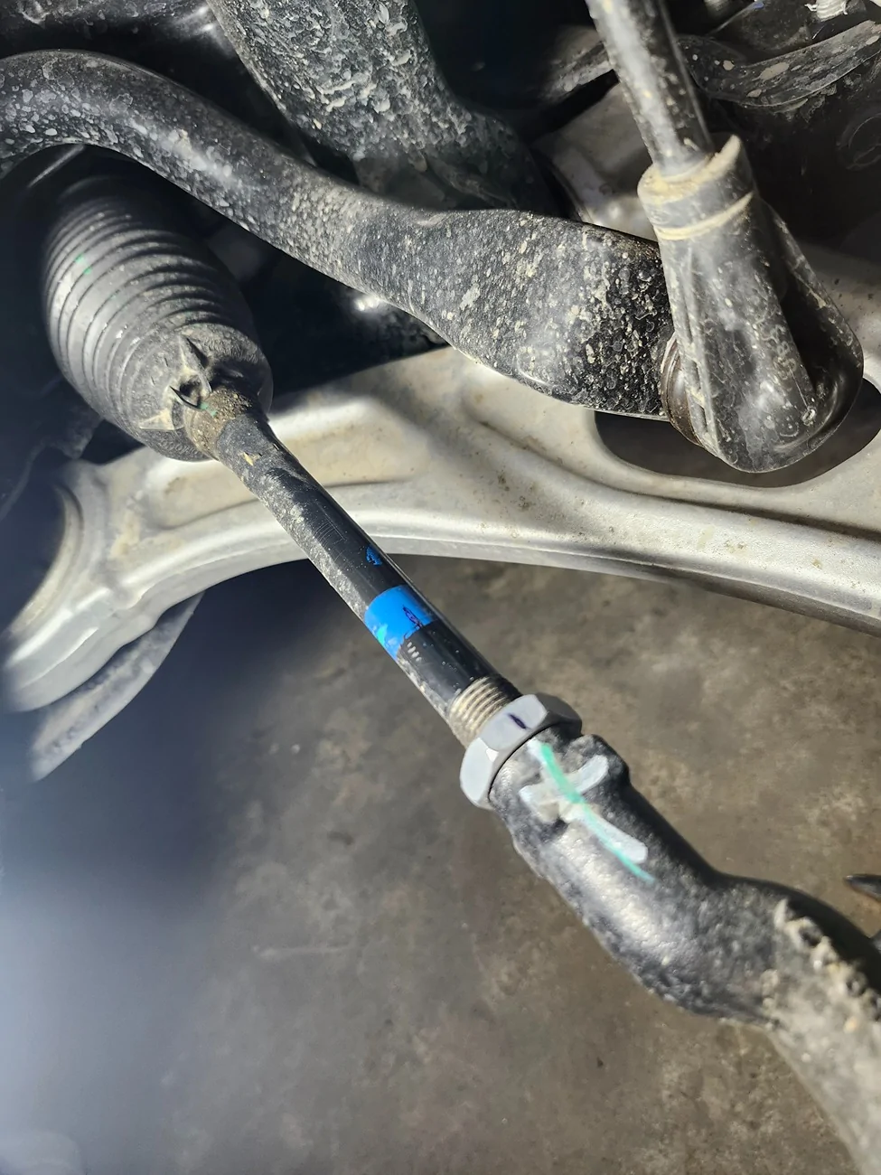

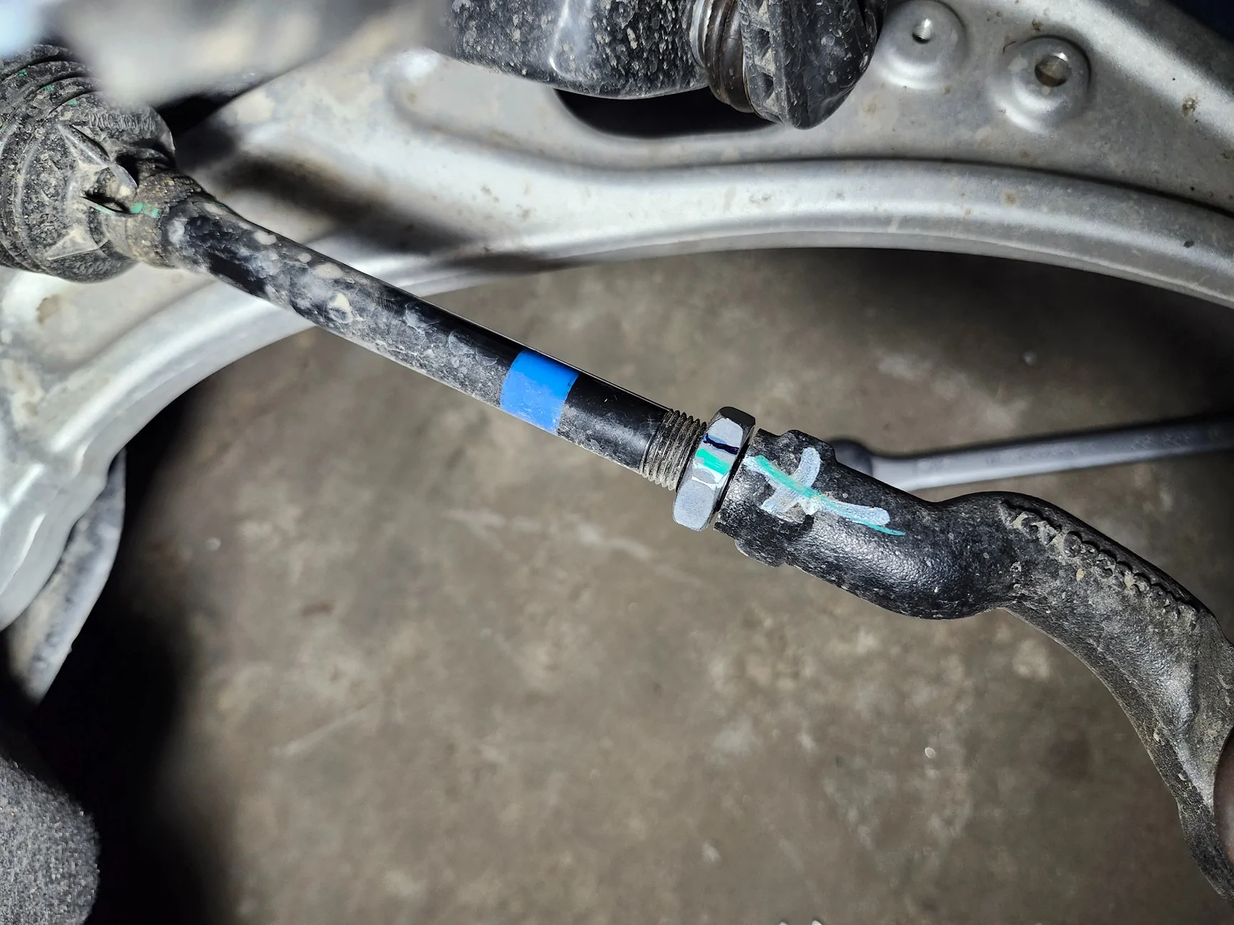

*Front & Rear Toe Adjustment for Better Turn-In — Ford Maverick Lobo*
If you're looking to sharpen your Maverick Lobo’s turn-in response, adjusting front and rear toe can make a noticeable difference. The good news? This can be done fairly easily with basic tools.
Setting Front Toe to 0°
Steps:
1. Jack up the front of the truck and remove the wheels.
2. Make a mark across the tie rod end, jam nut, and tie rod to track adjustment. (The factory marks this, but they can be slightly off.)
Ford Maverick Maverick Lobo Autocross Testing & Handling Upgrades 20250827_202030
3. Loosen the jam nut 180° & make a mark on it
Ford Maverick Maverick Lobo Autocross Testing & Handling Upgrades 1000014490
4. Thread the tie rod 180° inward (turn wrench Counter Clockwise) — or until your initial mark on the jam nut lines up with the tie rod end mark.
Before:
Ford Maverick Maverick Lobo Autocross Testing & Handling Upgrades 1000014491
After:
Ford Maverick Maverick Lobo Autocross Testing & Handling Upgrades 1000014493
5. Tighten the jam nut.
6. Reinstall the wheel.
7. Repeat on the other side.
Results:
Threading each tie rod in 180° resulted in 0° total toe.

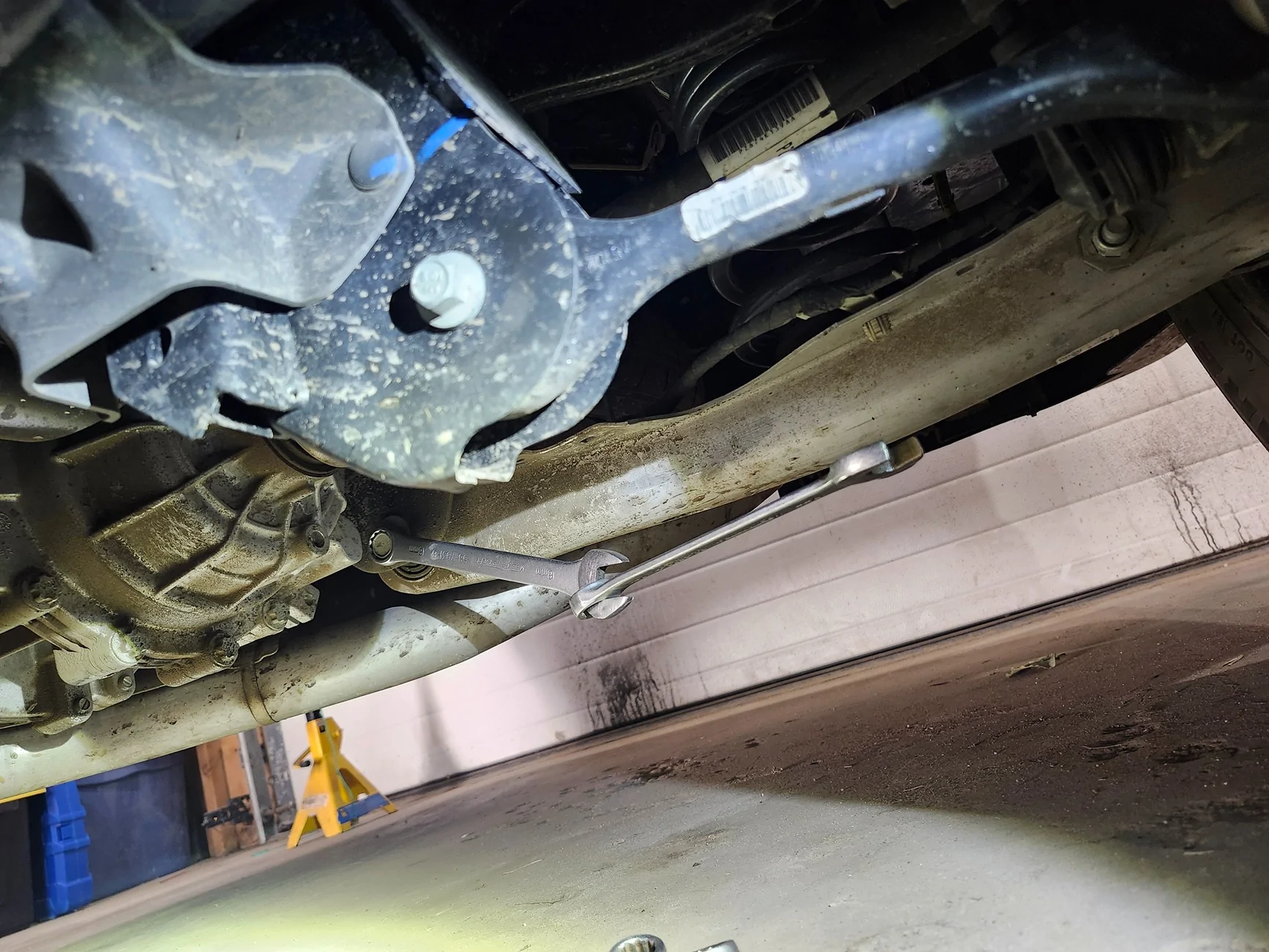

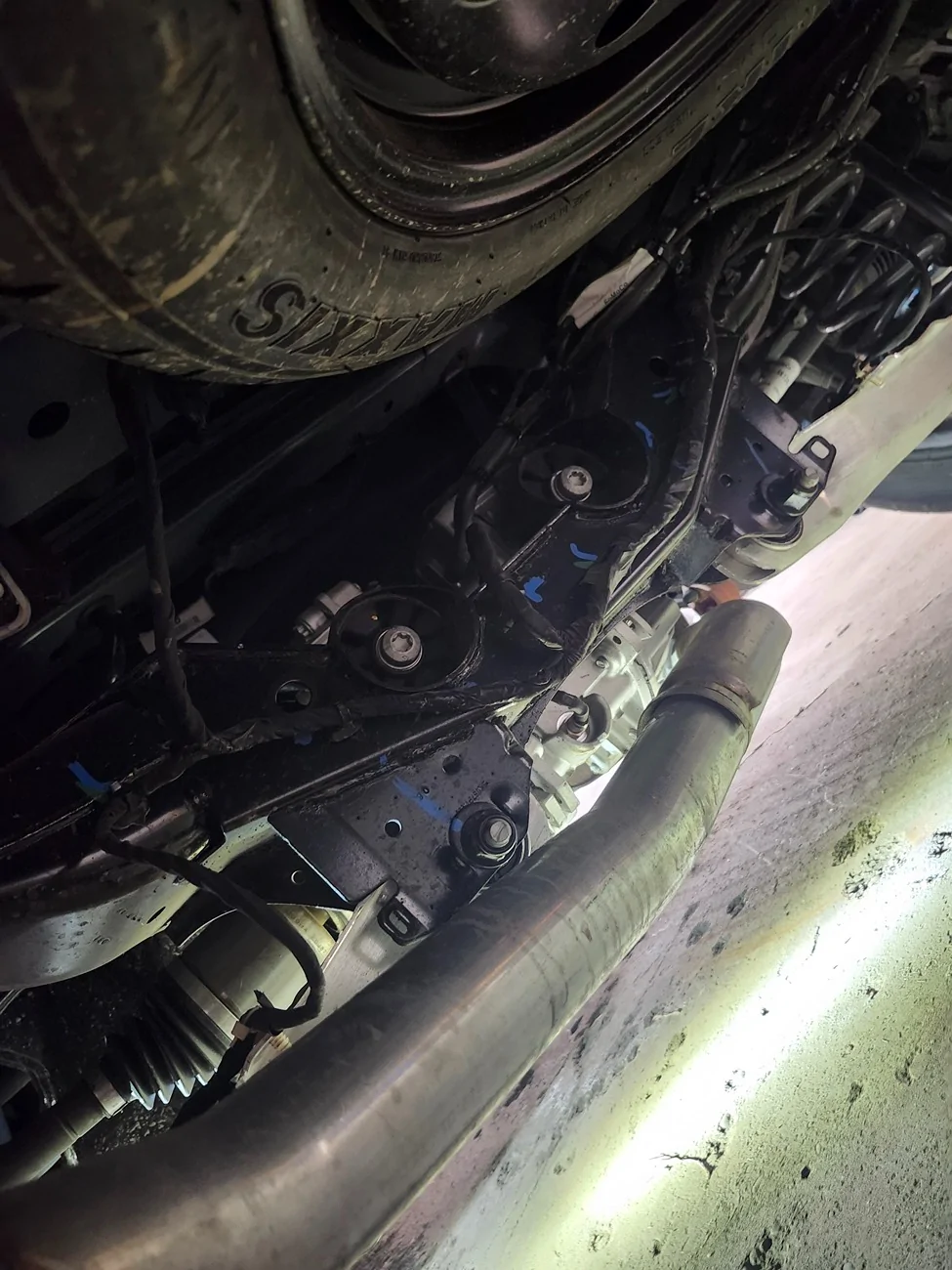

Setting Rear Toe to 0°
1. Mark the current position of the cam bolts — front and rear - if the factory marks are missing.
Ford Maverick Maverick Lobo Autocross Testing & Handling Upgrades 1000014546
2. Loosen the nut on the cam bolt. (21mm)
3. Rotate the cam bolt 1/4" from the mark. (Center of mark on chassis to center of mark on washer)
Turn from the front side
Ford Maverick Maverick Lobo Autocross Testing & Handling Upgrades 1000014545
•Clockwise for driver's side
•Counter-clockwise for passenger side
What it will look like after from back side once turned correctly. Notice alignment of marks now are moved 1/4 inch.
Ford Maverick Maverick Lobo Autocross Testing & Handling Upgrades 1000014561
4. Tighten the nuts to 111 ft-lbs. Make sure to hold the bolt head so it doesn’t spin while tightening!
Results: This adjustment yielded exactly 0° rear toe.

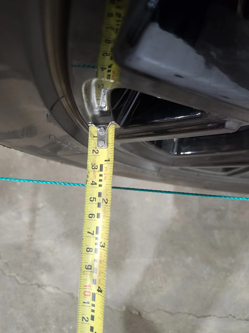

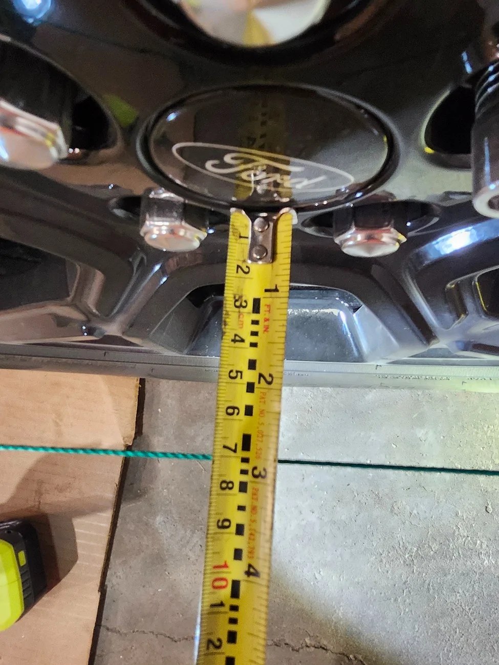

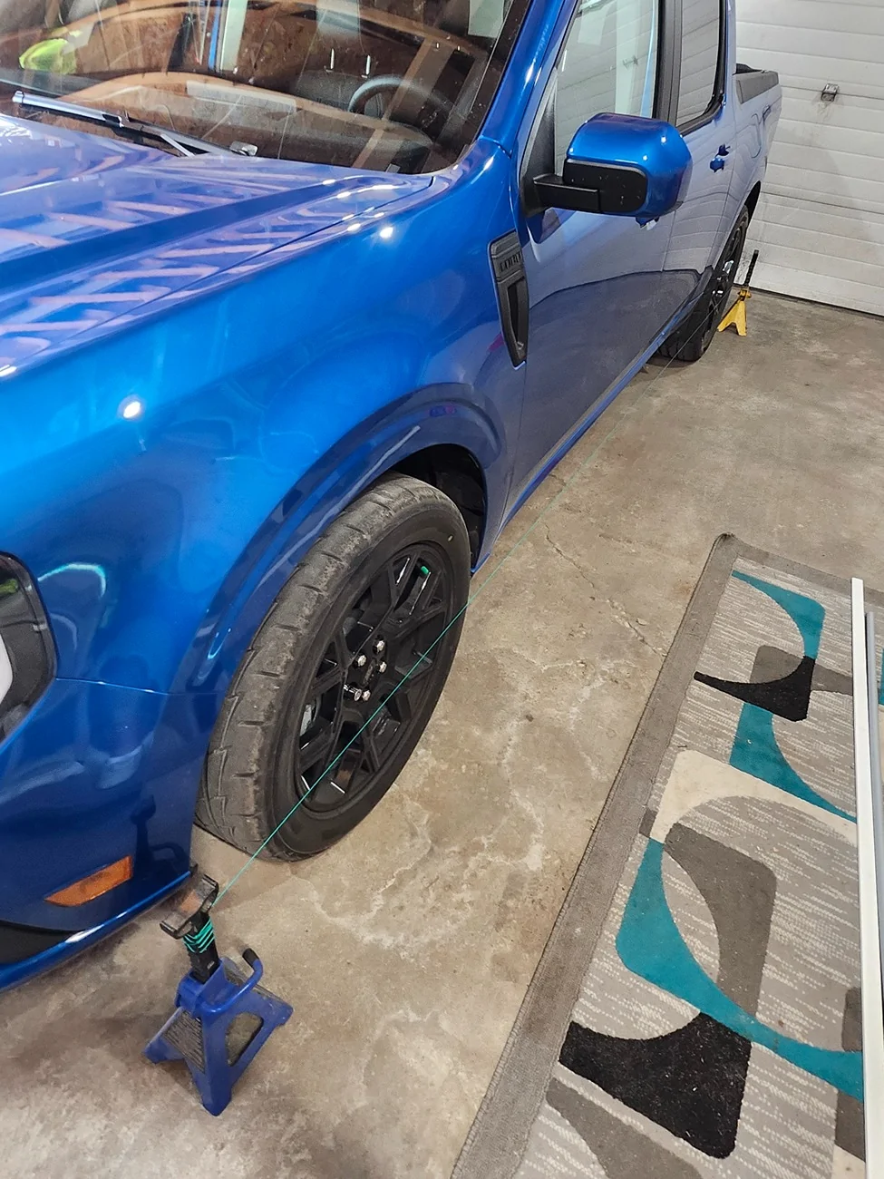

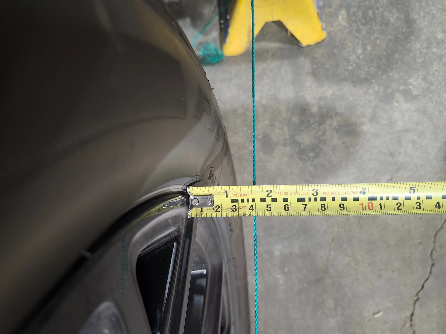

How to Check Your Alignment — DIY String Alignment - Easy version
You can do a basic alignment check at home using a string and a couple jack stands.
Steps:
1. Center your steering wheel as best you can.
2. Set up two jack stands on each side of the vehicle with a tight string running along the length of the truck, parallel to the wheels.
Ford Maverick Maverick Lobo Autocross Testing & Handling Upgrades 1000014550
3. Set the string height to 12.5" off the ground. Ensure its tight with minimal sag.
4. Adjust the jack stands so the string sits:
•70mm from the center of the rear hub
•62.5mm from the center of the front hub
Ford Maverick Maverick Lobo Autocross Testing & Handling Upgrades 1000014549
This accounts for the 7.5 mm difference in front/rear track width per side.
5. Measure from the string to both the front and rear edges of each wheel rim.
Ford Maverick Maverick Lobo Autocross Testing & Handling Upgrades 1000014564
Ford Maverick Maverick Lobo Autocross Testing & Handling Upgrades 1000014562
•If the distances are equal, toe is neutral.
•If the front measurement is smaller than the rear, that wheel has toe-out; larger means toe-in.
6. Double-check the other side before making any changes — slight discrepancies in the front end may be due to the steering wheel not being perfectly centered.

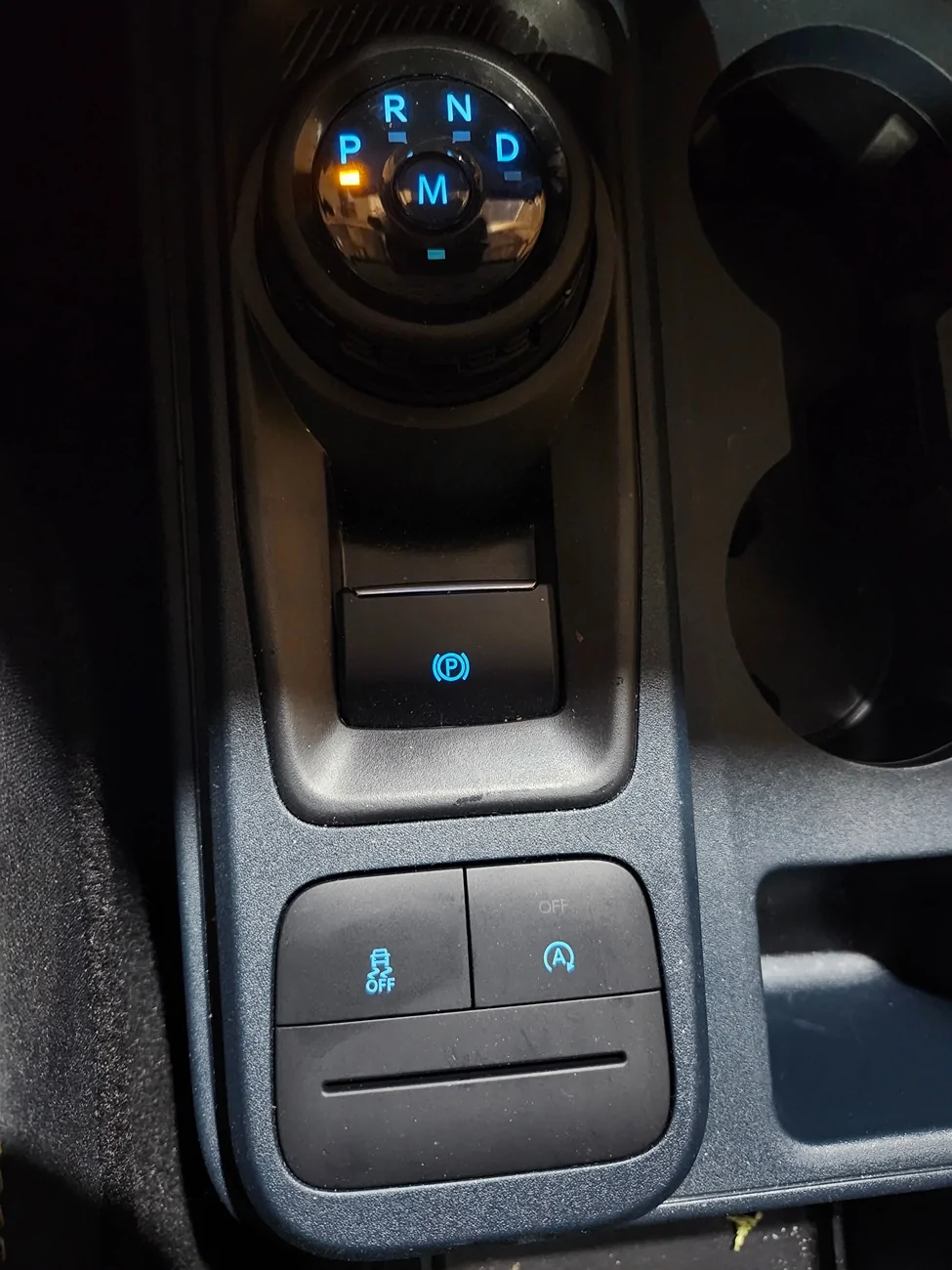

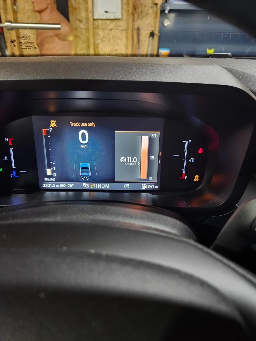

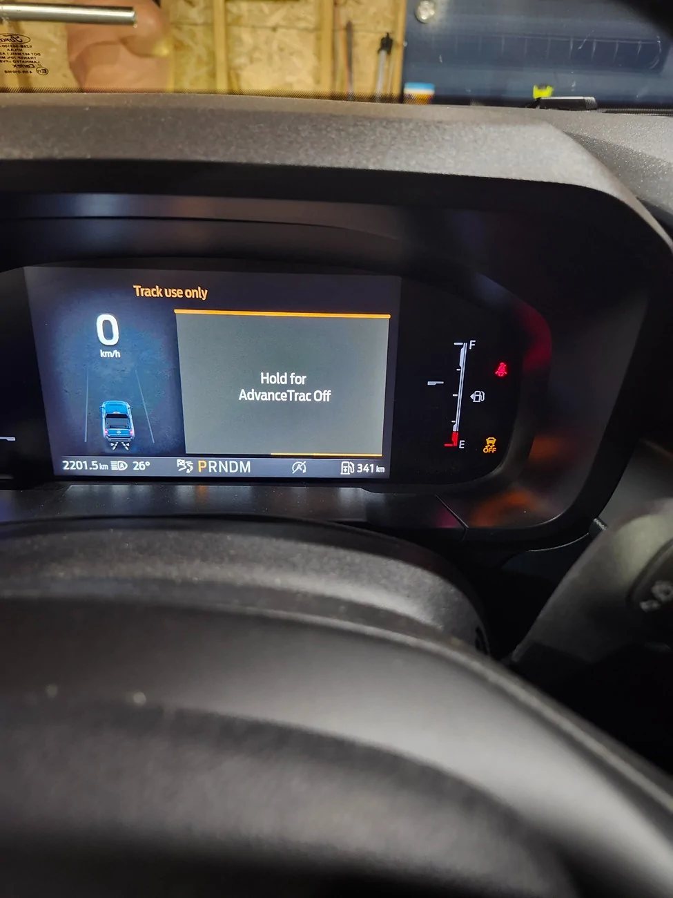

**How to Disable AdvancedTrac ESC on the Ford Maverick Lobo**
If you've taken your Maverick Lobo to an autocross or track day, you've probably noticed that the ESC (Electronic Stability Control) can get in the way—even in "Track mode". Fortunately, there's a simple way to further disable it.
Here's how:
1. Switch to Lobo Mode.
2. Press and hold the ESC OFF button on the center console until the system turns off.
That's it - you're good to go!
Press & hold ESC OFF button down
Ford Maverick Maverick Lobo Autocross Testing & Handling Upgrades 1000014567
Hold it down until it says the AdvancedTrac is off (~5 seconds)
Ford Maverick Maverick Lobo Autocross Testing & Handling Upgrades 1000014568
You'll know it's off when the yellow Pre- Collison Assist symbol lights up (Top Left)
Ford Maverick Maverick Lobo Autocross Testing & Handling Upgrades 1000014569
This method also works in other drive modes, not just Lobo Mode.
And yes, it is mentioned in the owner's manual... but who actually reads those.

Good, you found it.
I tested it the other day in Lobo mode too, just to confirm my thoughts about it.
It also shows the Slippery Off icon in the bottom-right of the display.
Have you tested this to see how / if it effects your ESC troubles at the track?
Something new I found the other day as well was a message pop up on the display about "power cut/reduced" or some such when I was using the brake along with throttle input through a corner..
I forget if I had the Advance trac off at that time or not..I don't think I had it off at that time.

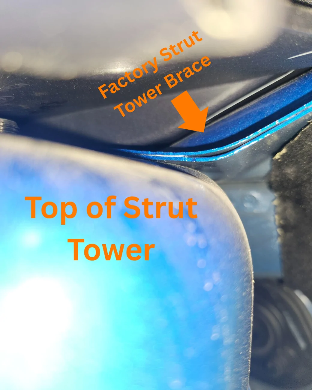

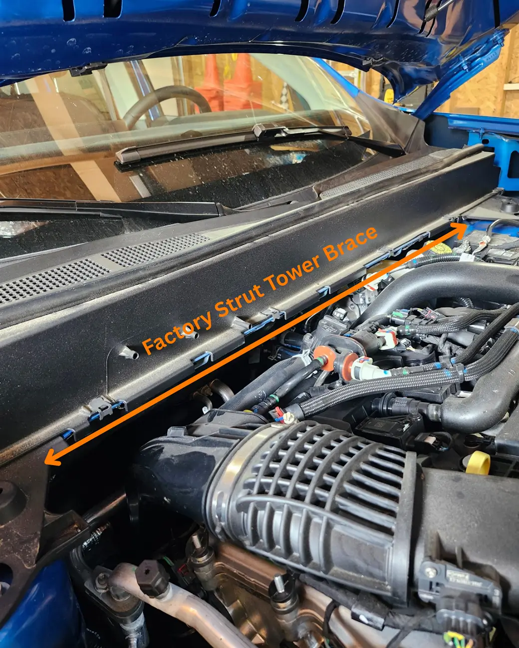

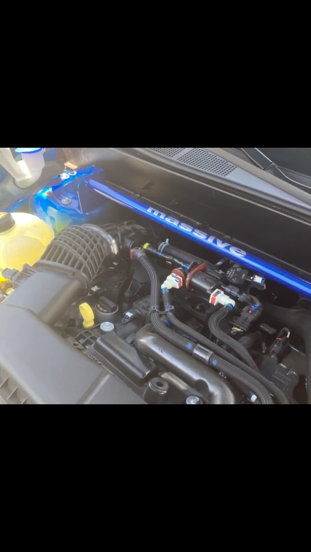

Strut Tower Bracing
I've noticed some debate about whether strut tower braces are necessary on this truck. In reality, the Maverick's strut towers come very well braced straight from the factory. There’s actually a built-in strut tower brace—it’s just hidden beneath the plastic trim, so it’s not immediately visible.
Ford Maverick Maverick Lobo Autocross Testing & Handling Upgrades 1000014641
Ford Maverick Maverick Lobo Autocross Testing & Handling Upgrades 1000014642

Strut Tower Bracing
As a rocket scientist - I insist on redundancy:
Ford Maverick Maverick Lobo Autocross Testing & Handling Upgrades IMG_9276
