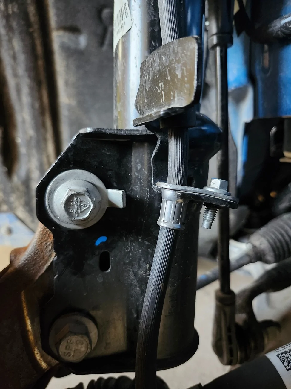

**Easy Camber Mod for Better Cornering on the Maverick**
One of the easiest and cheapest modifications you can make to improve your Maverick's cornering is adding negative camber.
The Maverick uses a MacPherson strut front suspension, which has a key drawback:
As the suspension compresses (like when cornering), it loses camber meaning the top of the tire moves outward, reducing the contact patch with the road.
This is a problem because less contact patch = less grip, which leads to understeer.
The Cheap Fix? Camber Bolts.
Camber bolts are typically used to correct alignment after lowering or lifting a vehicle, but they can also be used proactively to add negative camber for performance.
Here’s how I did it on my Maverick using Eibach camber bolts (which are rebranded SPC bolts):
Installation Steps
1. Jack up truck & remove the front tire
2. Remove the upper strut bolt. You'll need to give it a whack with a hammer to remove it.
3. Install the camber bolt in its place.
Having the tab and arrow pointing toward the engine will set it for maximum negative camber (see reference photo).
Ford Maverick Maverick Lobo Autocross Testing & Handling Upgrades 1000014484
3. Torque the bolt to spec — (97 ft-lbs for SPC brand bolts)
4. Put tire back on & lower jack. Repeat for other side.

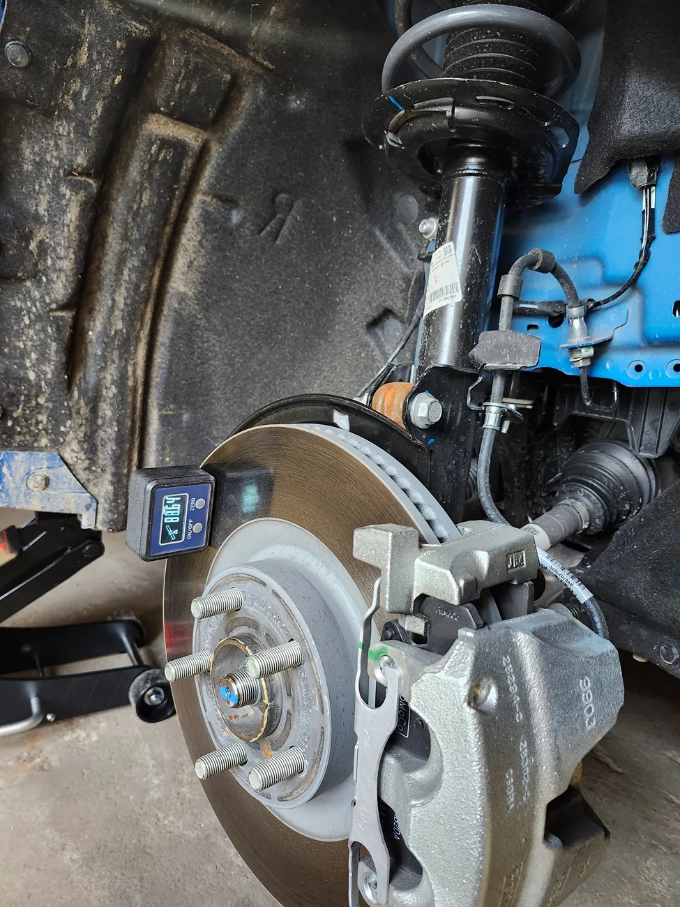

~1.5° of added negative camber
Before (Level reads 88.64°)

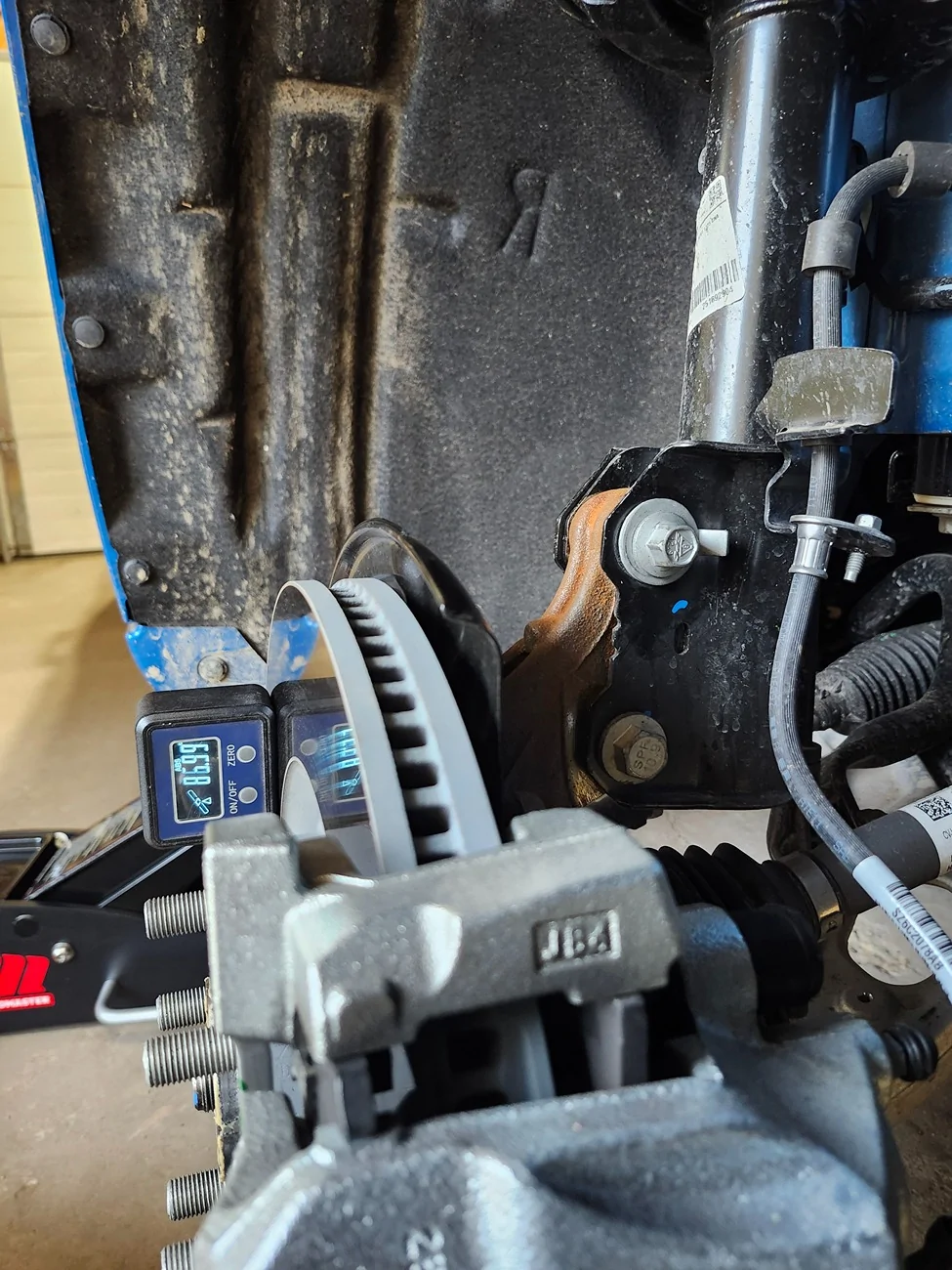

After (Level Reads 86.99°)
Ford Maverick Maverick Lobo Autocross Testing & Handling Upgrades 1000014485
Total gain of negative camber = 1.65°
Installation Steps

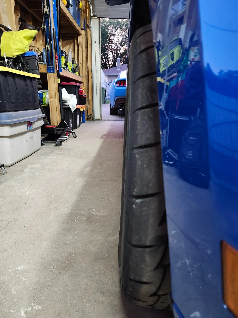

Autocross Test Results – Minor Mods, Big Gains
Last night, I finally got to test out the recent mods at an Autocross event—and they made a noticeable difference.
Results:
The updates shaved off approximately 5 seconds. Goal achieved!
Current Setup & Mods:
  • Tires: 245/50/19 Firestone Indy 500s – 36 psi front / 38 psi rear
  • Front Camber: Camber bolts maxed out (~2.5°)
  • Front Toe: Set to 0°
  • Sway Bars: Goodwin rear bar – Max stiff setting
  • Springs: Goodwin lowering springs
Driving Impressions:
  • Grip: Huge improvement. The truck holds more speed and transitions faster.
  • Understeer: Still present mid-corner and on exit, but much better with added camber and rear bar.
  • Tire Wear: Front wear is much more even now.
  • Tire Heat: Fronts overheat quickly—grip fades by the end of a run.
  • Rear End: Now very planted. Previously, lifting throttle would rotate the truck—now it stays stuck. I prefer some off-throttle rotation, so I’ll need to work on suspension tuning.
