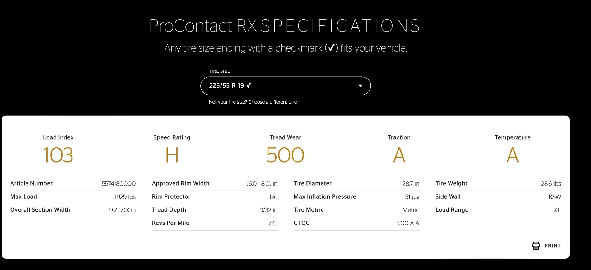

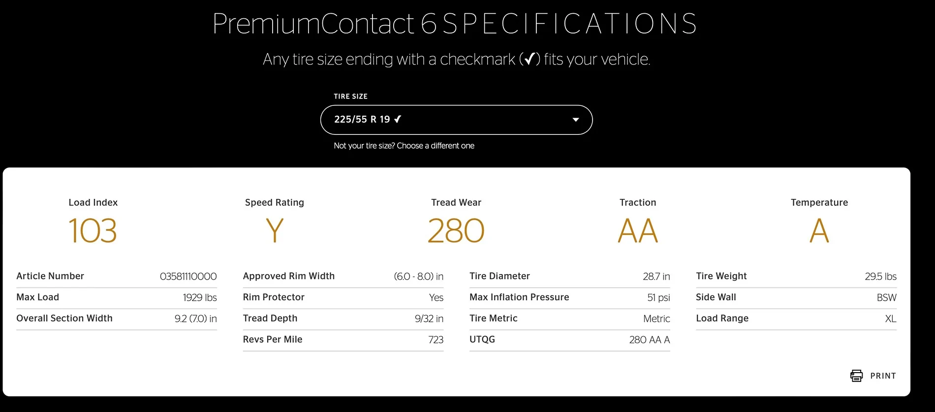

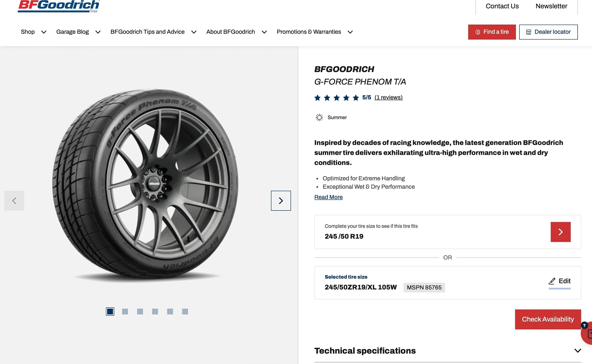

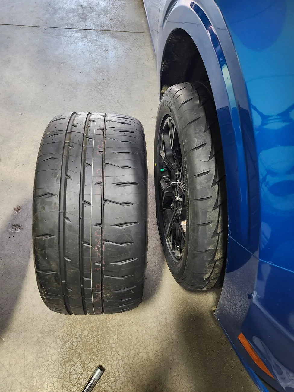

245/50/19 Indy 500's mounted, but these 265/40/18 Bridgestone RE71RS look like a possibility to try out for a future test.
I'm new (brand new) to autocross. I have participated in 2 events so far. What do you think about these tire choices? My Lobo is my daily, Home Depot, Costco, Provider of Fun everything truck.
I live in Southern California so temps are quite a bit warmer and we only have to worry about rain, if we can get it. The BFG was the only one in a 245 50r19. I have possibly one more event before I'm done for the season. So tires will be a next season.
Ford Maverick Maverick Lobo Autocross Testing & Handling Upgrades BFG G-Force Phenom
Ford Maverick Maverick Lobo Autocross Testing & Handling Upgrades ContactPremium6
Ford Maverick Maverick Lobo Autocross Testing & Handling Upgrades ProcontactRX
More than good enough for what you're looking to do. They have similar grip levels to the cheaper Firestone Indy 500's, but they are better in the rain.
The best performance tire you'll find in a 245/50/19 will be the Goodyear Eagle F1 Asymmetric 6. They tested out ~1 second faster than the Indy 500 and Phenom T/A for AutoX and are even better in the wet.
That is the tire this truck should've came with.
Thank you so much for the advice!
Just so I don't mess this up.The 245s would be preferable to the stock 225s correct?
Just out of curiosity about how long are your autocross layouts? The first one I was in was .7 mi and the second was smaller at .5 mi.
~0.8 mile
Yes 245/50/19. This is just because there are much better tire options in that size & maintains the same overall diameter as O.E.
