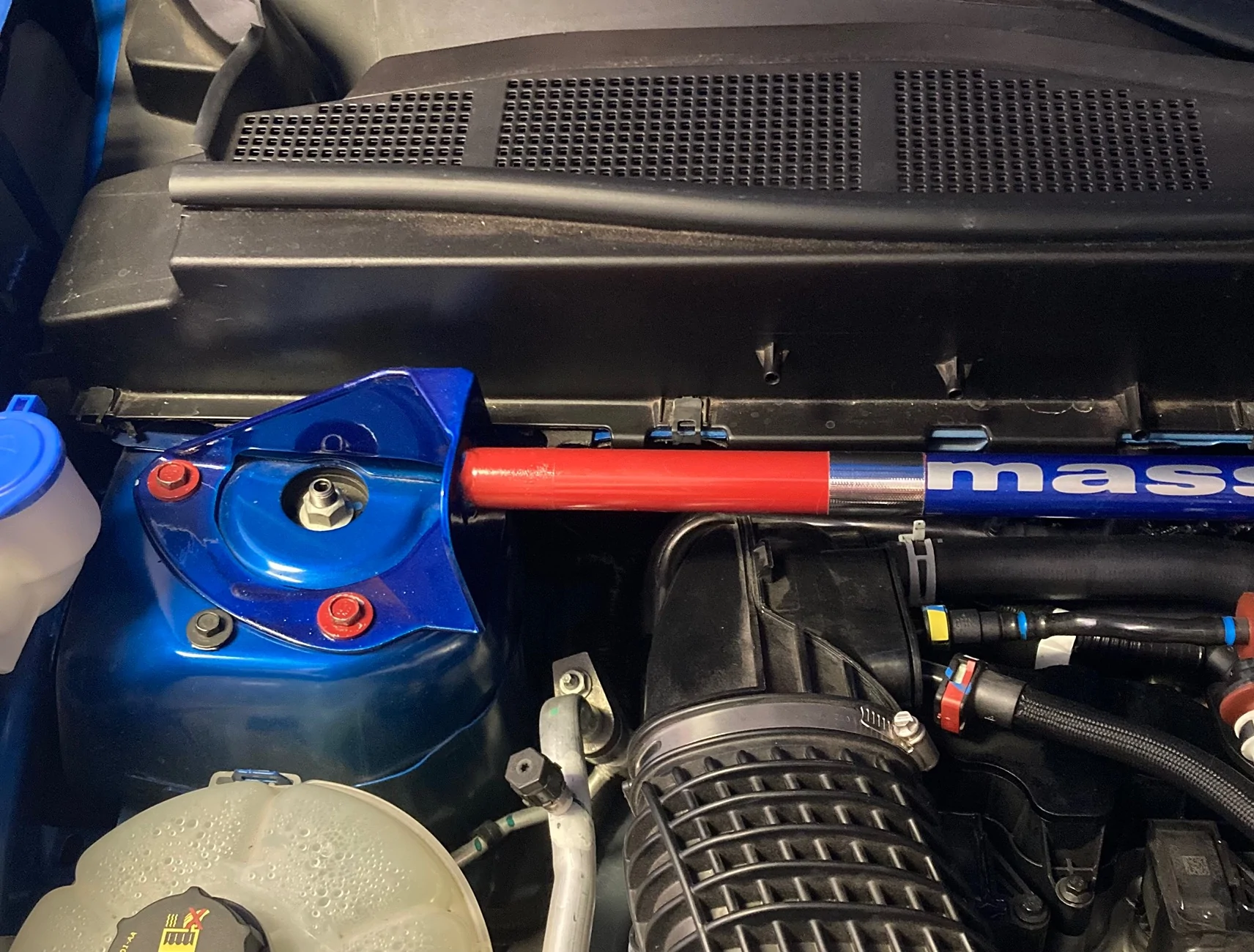

Would not bother with a strut brace. They do little to nothing in terms of actual measurable performance. Spend the money on better tires, or a nice dinner.
I disagree it made a diffrence my Steeda brace I could feel while in corners ( cause we have 3 xL FWD I drive them a couple days a week they’re boat
now on the AWD I could see what you’re saying.
my 03 cobra vert before I installed my 3 point brace you could see the windshield / cowl flex on hard acceleration
Brace & subframe connectors made a huge difference

Happy to hear the feedback!

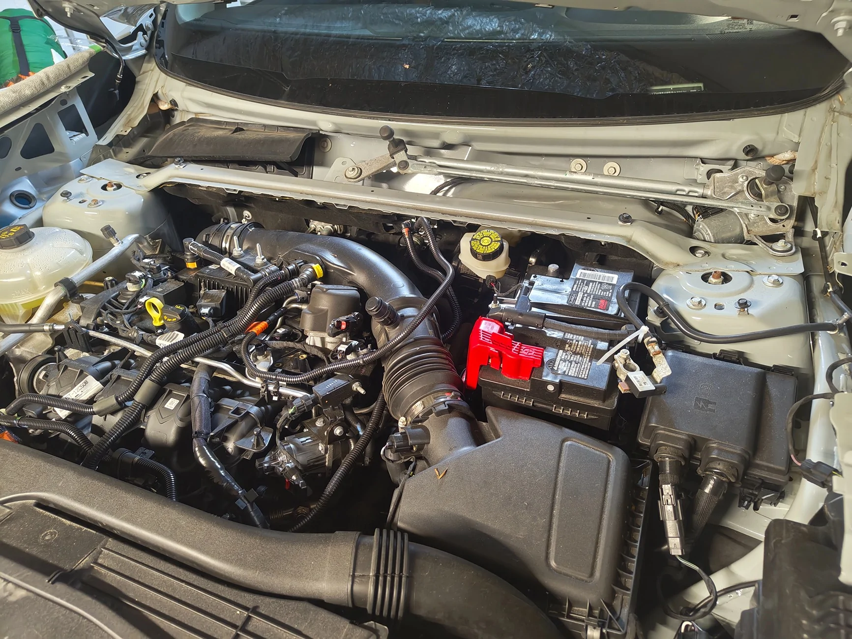

Fair enough, but I'd separate "feels different" from "makes the vehicle faster."
Your Cobra example makes sense, as subframe connectors address a well-known chassis weakness on those cars.
The Maverick doesn't have that issue. I actually made a post earlier in this thread showing how extensively the strut towers are braced from the factory.
From my own track and autocross experience with this truck, chassis flex has never been an issue, nor have I seen it mentioned by others who use these trucks for HPDE or autocross events. Tires, alignment, suspension setup, and driver skill all have a much greater impact on performance.

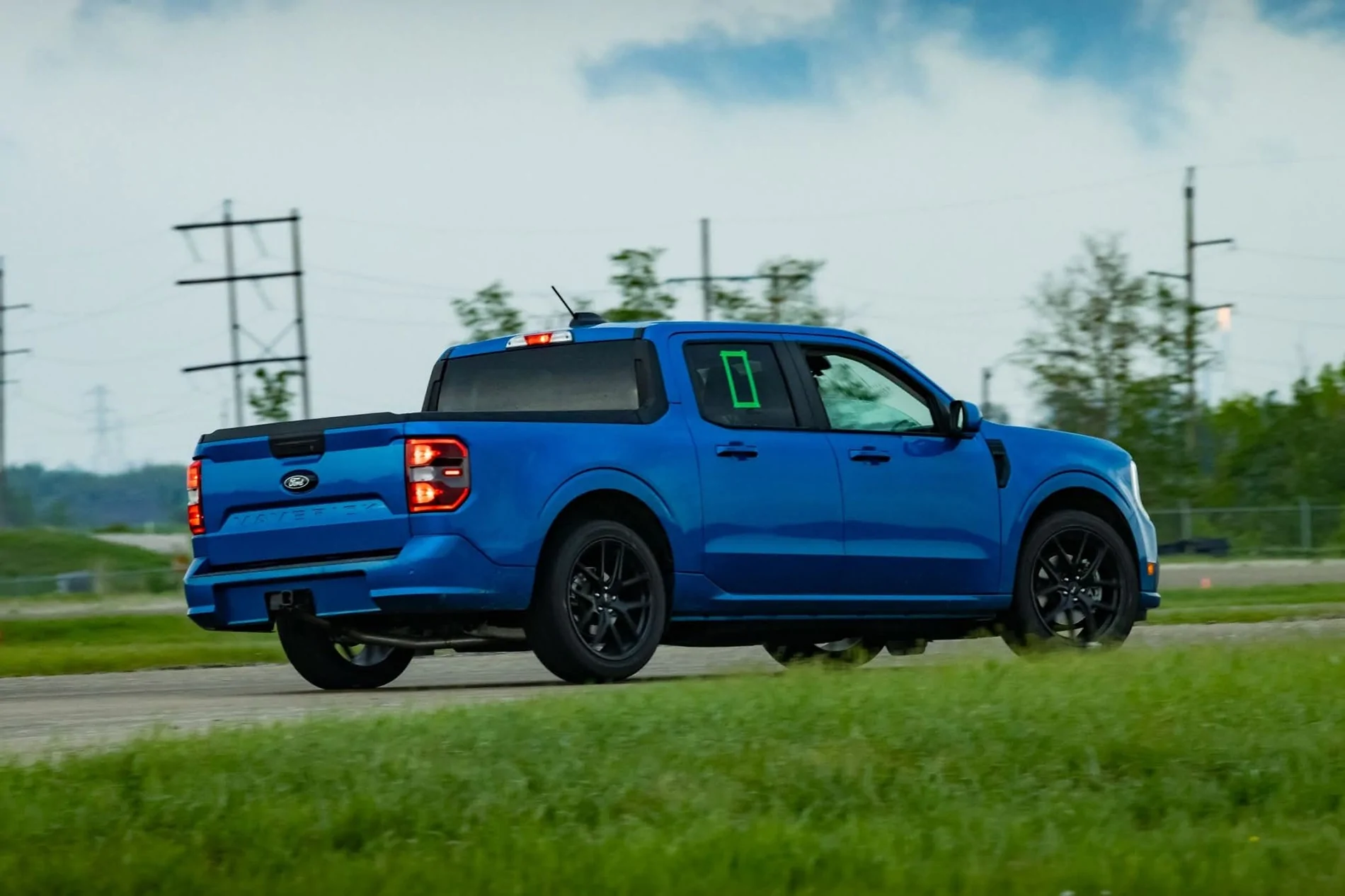

The autocross season is underway, so it's time for a quick Maverick update.
Changes for 2026
Tires
Last season I ran Firestone Indy 500s. This year I'm running the updated Indy 500 V2 in a 255/45R20.
Unfortunately, there still aren't any competitive autocross tire options available in a diameter that works well on the Maverick. For this truck, you really want a tire around 29" tall or larger. Anything significantly shorter causes it to upshift into 3rd gear too early, which hurts acceleration and leaves you fighting the transmission to get back into 2nd.
Wheels
I also ditched the factory boat anchors for a set of 20x8.5 Fast FC04 wheels. They're a great budget-friendly flow-formed option and noticeably lighter than stock.
Maintenance
During my preseason inspection I found a few issues:
- Factory-installed oil filter was leaking around the seal despite being tight.
- Transmission vent tube had pushed out a noticeable amount of fluid, leaving oil on the undertray.
- Front pinion seal has a very minor leak.
Nothing major at the moment, but I'll be keeping an eye on all three.
First Event
The first outing was at my own StratoCross event, which is a higher-speed autocross format run on an oversized kart track.
We started with wet conditions before the track dried out later in the evening. The Maverick ended up 11th overall out of 35 entries.
The updated Indy 500s are a noticeable improvement over the previous version. They offer more grip and seem to tolerate heat better before getting greasy. Combined with the lighter wheels, the truck feels more responsive everywhere.
Based on initial impressions, the wheel and tire package is worth roughly a second or more over a typical AutoX course vs what I ran last season.
What's Next?
Honestly, the biggest area for improvement is still the driver.
I'm continuing to learn how to get the most out of the Maverick and work around its unique quirks, wheelbase, and weight distribution. There's definitely more time left on the table.

I got a clear photo of the factory strut tower brace while I had my wiper cowl off last weekend.
Great pic thanks! As a former imaginary astronaut - I firmly believe in redundancy. Do you know if the OEM brace is steel or aluminum?
