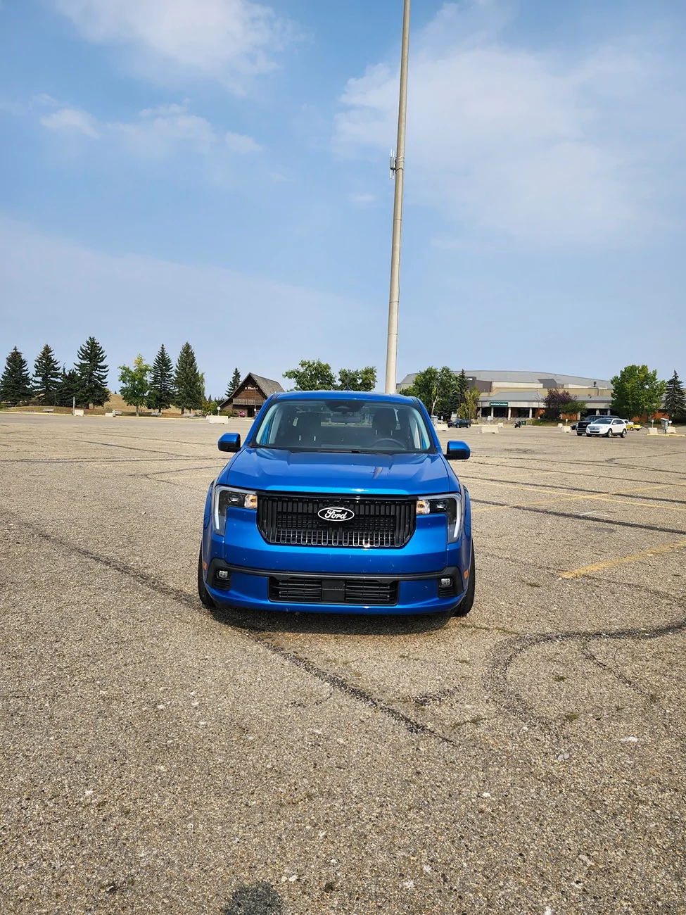

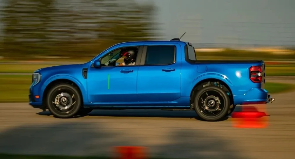

**More AutoCross Testing in the Maverick**
Over the past week, I took the Maverick out for three different AutoX events, each held at very distinct venues:
* Oversized kart track
* Airport runway
* Small parking lot
Recent Changes to the Setup:
Rear Toe : Switched to 0° toe in the rear
ESC : Turned off AdvancedTrac
Handling Observations:
AdvancedTrac Off:
Disabling Advancedtrac reduced the intrusive power cuts significantly. However, it's not fully off — it still cuts power unpredictably, and there's no clear pattern to when it happens.
Rear Toe at 0°:
This change made the rear end more active. I’m now getting some mild on-throttle oversteer on corner exits, which really helps in tight AutoX sections. Transitions between elements also feel sharper and more responsive.
Highway driving:
With front & rear toe set to 0° its slightly more darty, but hardly anything worth concern. Still drives fine.
Transmission Behavior:
One of the biggest struggles has been the gearing:
2nd gear : Too short
3rd gear : Too tall
Even at smaller venues, the truck constantly shifts up into 3rd, and that’s where the trouble starts:
* If it stays in 3rd, hitting the throttle on corner exit causes a delay before anything happens, then it accelerates sluggishly.
* If it downshifts to 2nd, power delivery is immediate and strong.
This hesitation can easily cost you up to a full second just exiting one corner.
Best workaround so far:
Use manual mode, and preemptively hit the downshift paddle a couple of times when entering a corner if it has already upshifted. It’s not foolproof, but helps keep it in the right gear more often.
Tire Pressures (Firestone Indy 500s):
Front: 35 PSI
Rear: 38 PSI
These pressures gave the best balance. Fronts gained 2–3 PSI per run, and once they went over 38 PSI, I noticed:
* Reduced grip
* Understeer
* Braking lock-up
Keeping them below that threshold maintained consistency and control.
Seatbelt Lock “Hack”:
If you're still running the factory seat and belt, this trick makes a big difference in keeping you planted:
1. Slide the seat all the way back
2. Yank the seatbelt until it locks
3. Slide the seat back into position, staying tight against the belt
This is a common trick in AutoX classes that require factory belts and makes a noticeable improvement in driver stability.
Other Issues:
Clicking noise when braking (while in Park & engine running):
* Appears to be coming from the gear selector knob area on the center console
* Likely tied to the electronic brake booster
* Others have reported this issue and resolved it with getting the brake booster replaced
Rear-end clicking at low speeds:
* Initially from passenger side, now both
* Suspected to be sway bar related
* Only happens when driving slowly — not replicable when parked
* Plan: Retorque everything and inspect further
Event Results:
I was around mid pack in the overall results at most of the events, which is pretty good considering how little is done to it &... well..its a truck.
The better tires & minor mods have shaved off ~4 seconds over a 60 second Autocross course vs Stock.
That's it for an update. I'll be getting alignment specs & corner weights here shortly.

that's a bummer. in a Lobo, your 7 gears are actually 1,3,4,5,6,7,8 compared to a non lobo Maverick. they electronically remove 2nd. physically it's still there. (or so I'm told, I haven't personally disassembled one to check.) in practice this doesn't matter because "8 speed" ecoboost Mavericks almost never use 2nd gear anyway.
the gear ratio difference is pretty large but there isn't a lot you can do about it. can you buy or borrow a set of much shorter tires to try? it'll get you into a more useable range of (your) 3rd (4th for other Mavericks). I'd probably look for whatever the most competitive tread wear 200 tire is and find a tire in the 255ish width that is shorter than 27".
265/35-19 might be doable. I would probably do some math and make sure it's not going to start shifting to your 4th on faster courses, then this exercise may be counterproductive. then again, the ratio change from 3rd to 4th is much shorter, but I'm still thinking shifting 2,3,4 may be undesirable.
if you don't have a second set of wheels obviously a super short set of tires isn't going to be fun daily driving.
