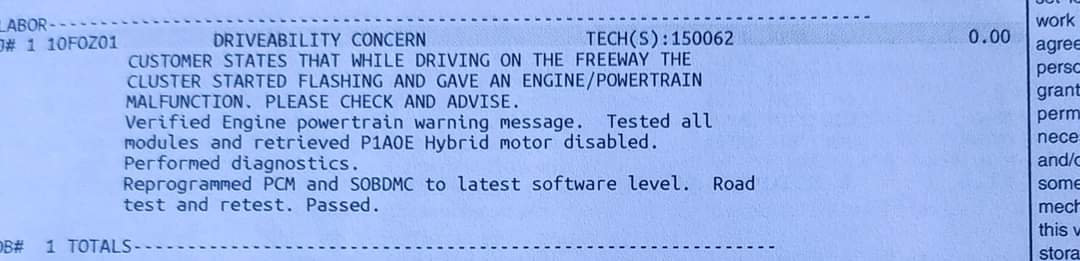

Same thing happened to me while driving on FWY. Dealer just did a software update for the hybrid motor...
But mine did a horrible diesel-like sound whilw i tried to safely get out of the FWY.
