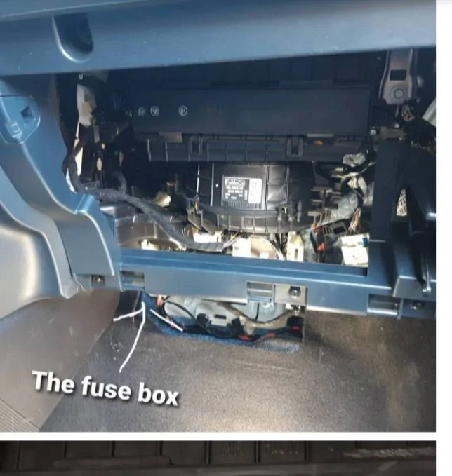

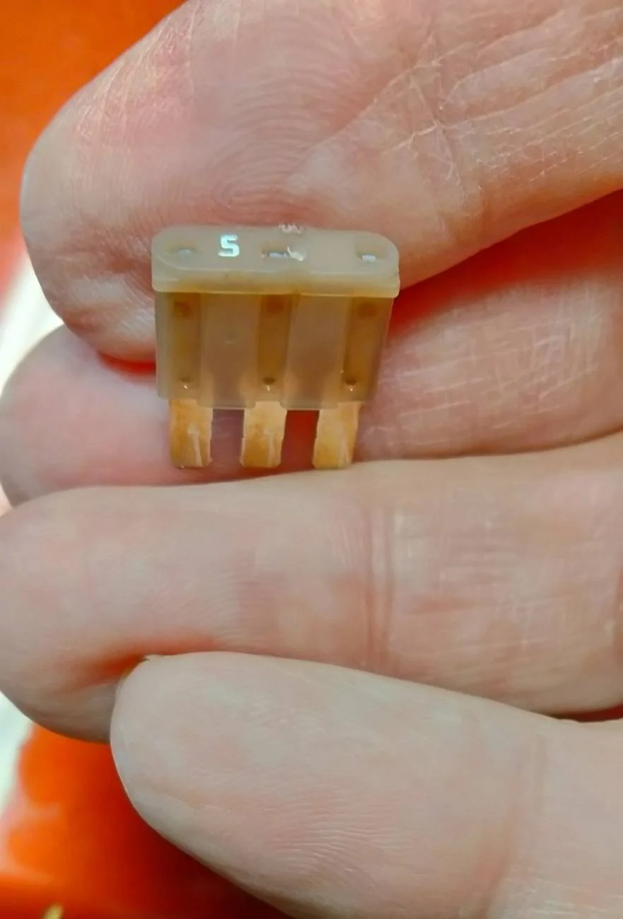

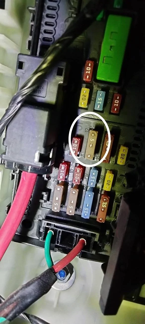

Fuse 11/12 is actually one combined socket here are some pictures.
I hope this helps good luck,
GB
This is fuse 11/12's location on the fuse panel.👇
This is what it looks like once removed👇
This is where it is all located..
Behind your glove compartment this is also where you change your cabin air filter.👇

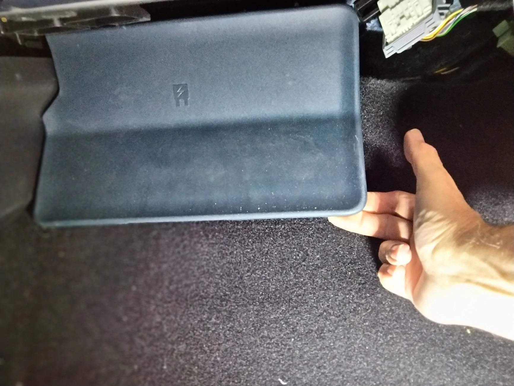

Important You do not have to remove the glove compartment in order to access the fuse box
This is the passenger compartment panel you have to remove to access the fuse box 👇👇👇
Good luck
