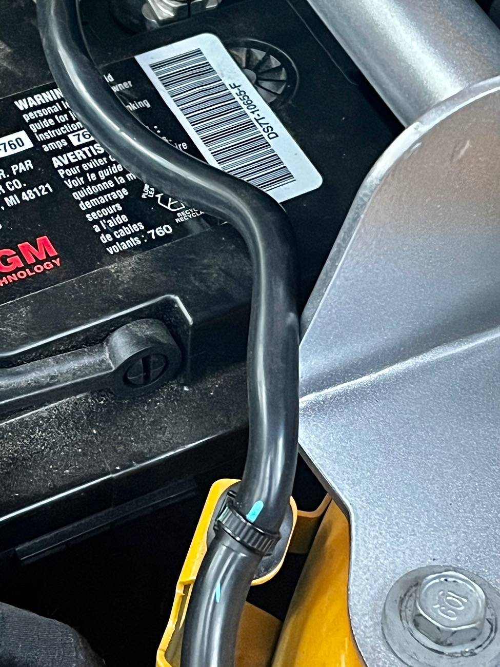

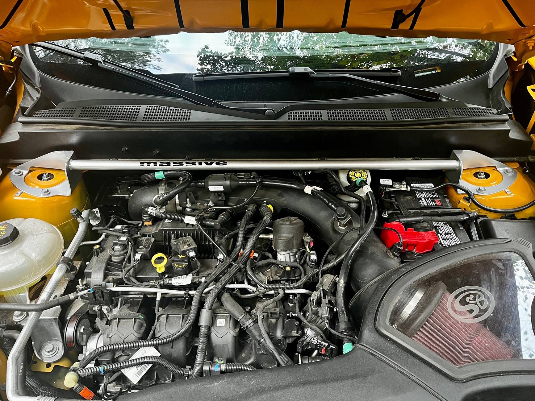

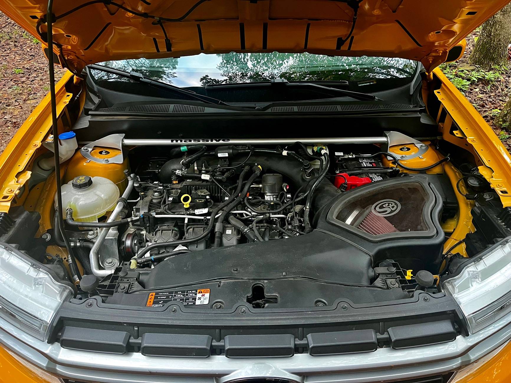

Just wanted to post up my Massive Strut Tower brace I threw on today in 5 mins (seriously). Haven’t drove the truck yet but it looks nice on there. Pardon the flithy truck due to the hurricane. I am curious to see how it changes the handling under spirted cornering. I got the silver as to not be too flashy but I might color match it to the truck later on. Anyway easy install and looks/feels very solid. One thing to note and I included a photo but the battery cable hits on the drive side. That’ll definitely rub through eventually so put a hose or tape to protect it from rubbing. Thanks to I believe @Dueces for posting the company so I could find them. Cheers

I like the color options and it looks nice but its more expensive than the Steeda. Its not a need but I kind of want one I just feel like I might hold out to see if someone makes an option for quick and easy removal for off roading. Either way looks nice. Are you noticing a difference?

yeah,paint that brace

Definitely a better more robust design than Steeda. 👍
Steeda was designed in the spirit of a strut Tower brace.
Massive brand is more of a functional design.

So it does make a difference even when just normal driving, well I mean you feel it. The front feels tighter and the front end doesn’t dive while cornering. I definitely feel like it would make a big difference in confidence if you were autocrossing. Front feels more planted. I’m going to take it off next week when I work on another mod install and drive it without it on to see if I notice how big it is a difference it makes when back stock.

I took the bar off when I put on my Dp and ran it without it for a day. You can definitely tell when the bar is on and when it’s off. Front feels stiffer when it’s on, feels more “truck” like with it off. For the money you’ll have to justify if it’s worth it for you but you’ll definitely feel a different I must say. Cheers

That's a pretty bad design for long-term use. The ends of that bar do not look well thought out. The crossbar should at least be butting into the sideways vertical section, preventing it from flexing the piece that its instead welded into. Eventually they're going to crack.
