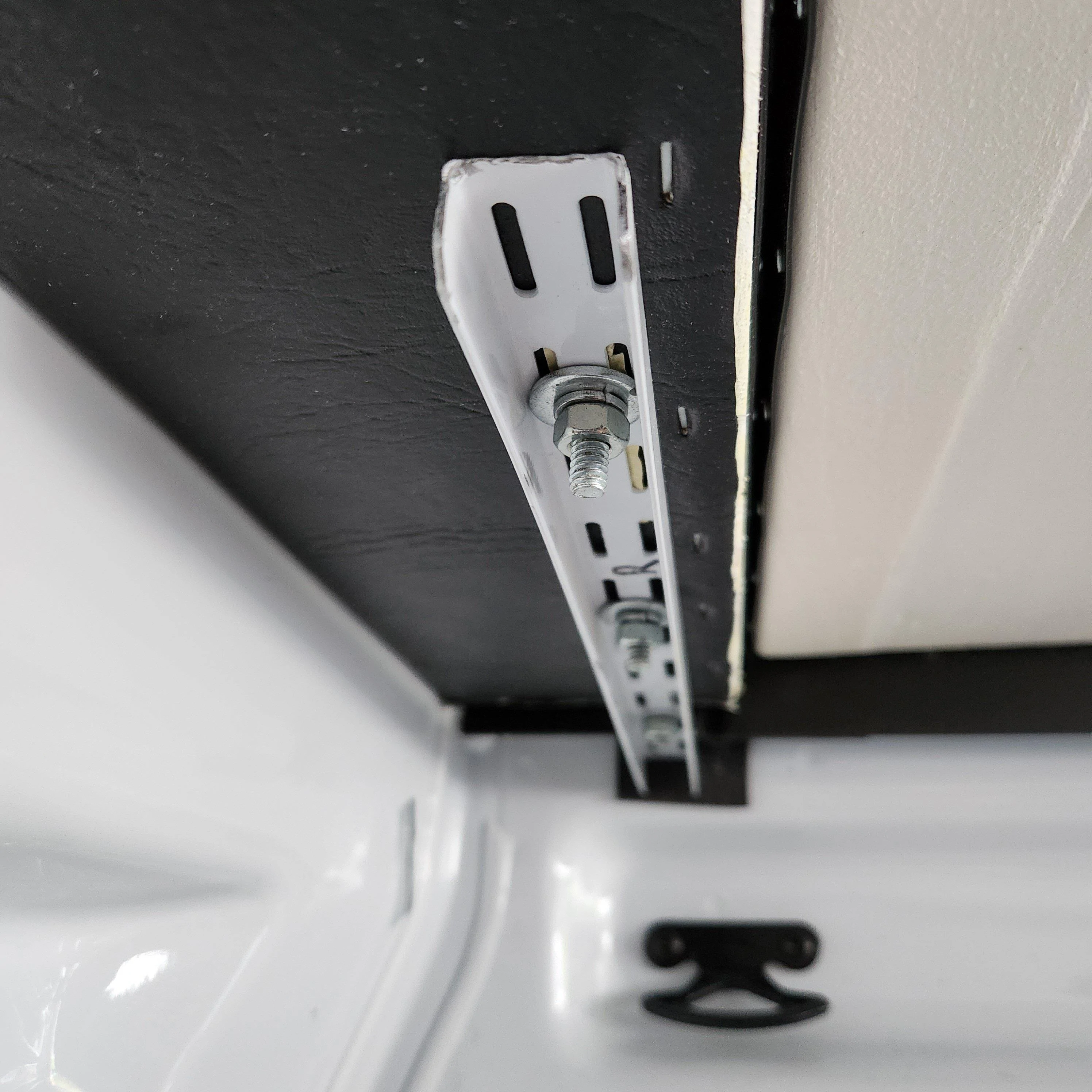

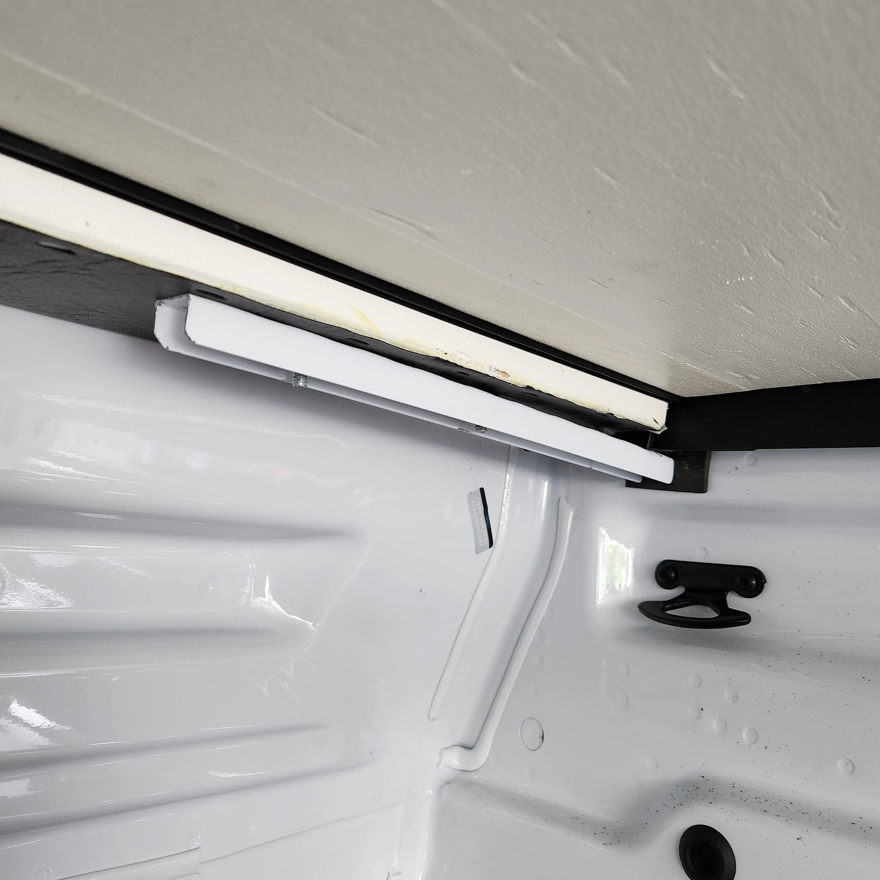

How did you attach it to the bed in the front, hinge end? I think I know but it is hard to tell by the picture.

It is actually a metal channel used for adjustable wall shelving. Just had it laying around.
You can see the 3 bolts recessed into the cover on one of the earlier pics. The channel simply acts as a clamp.
